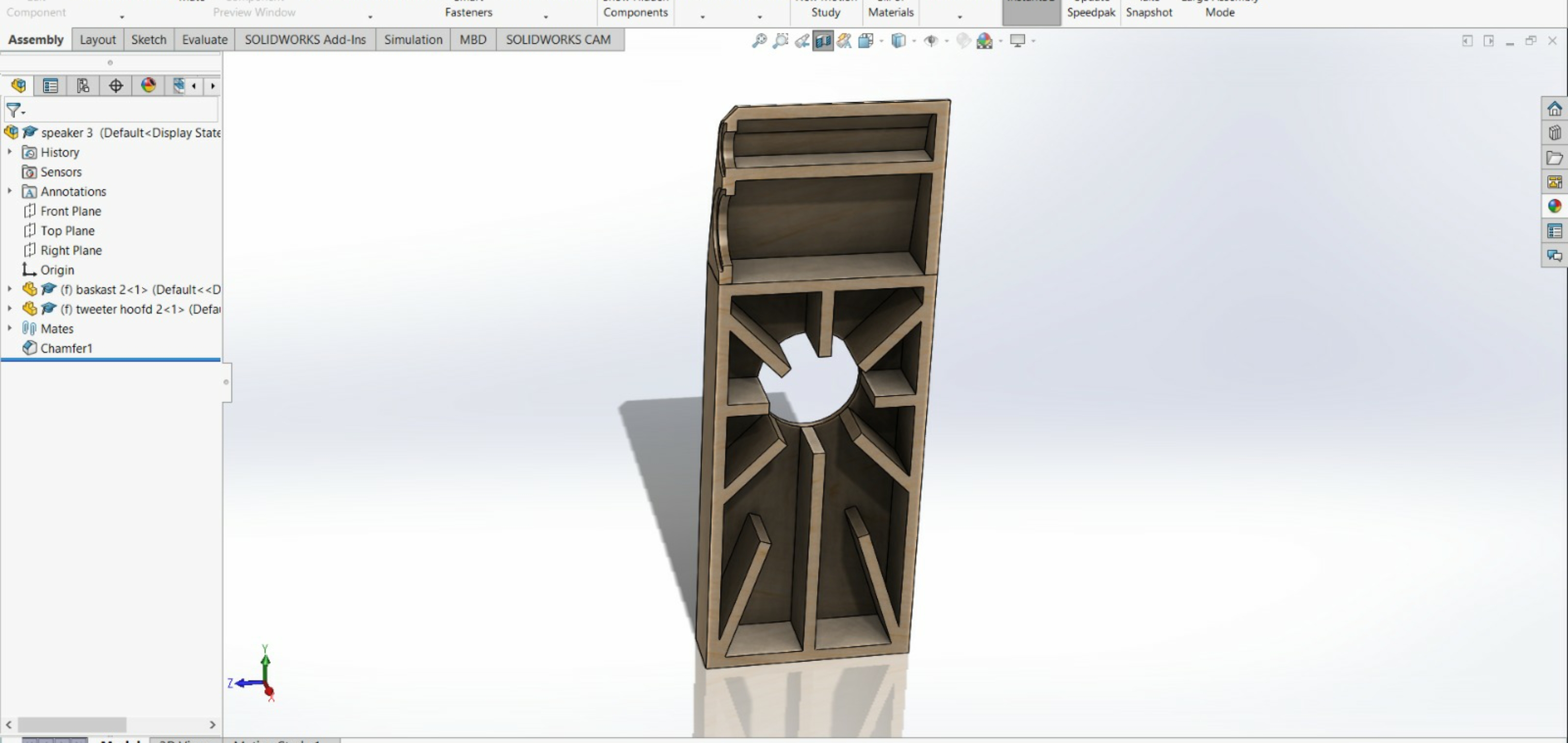

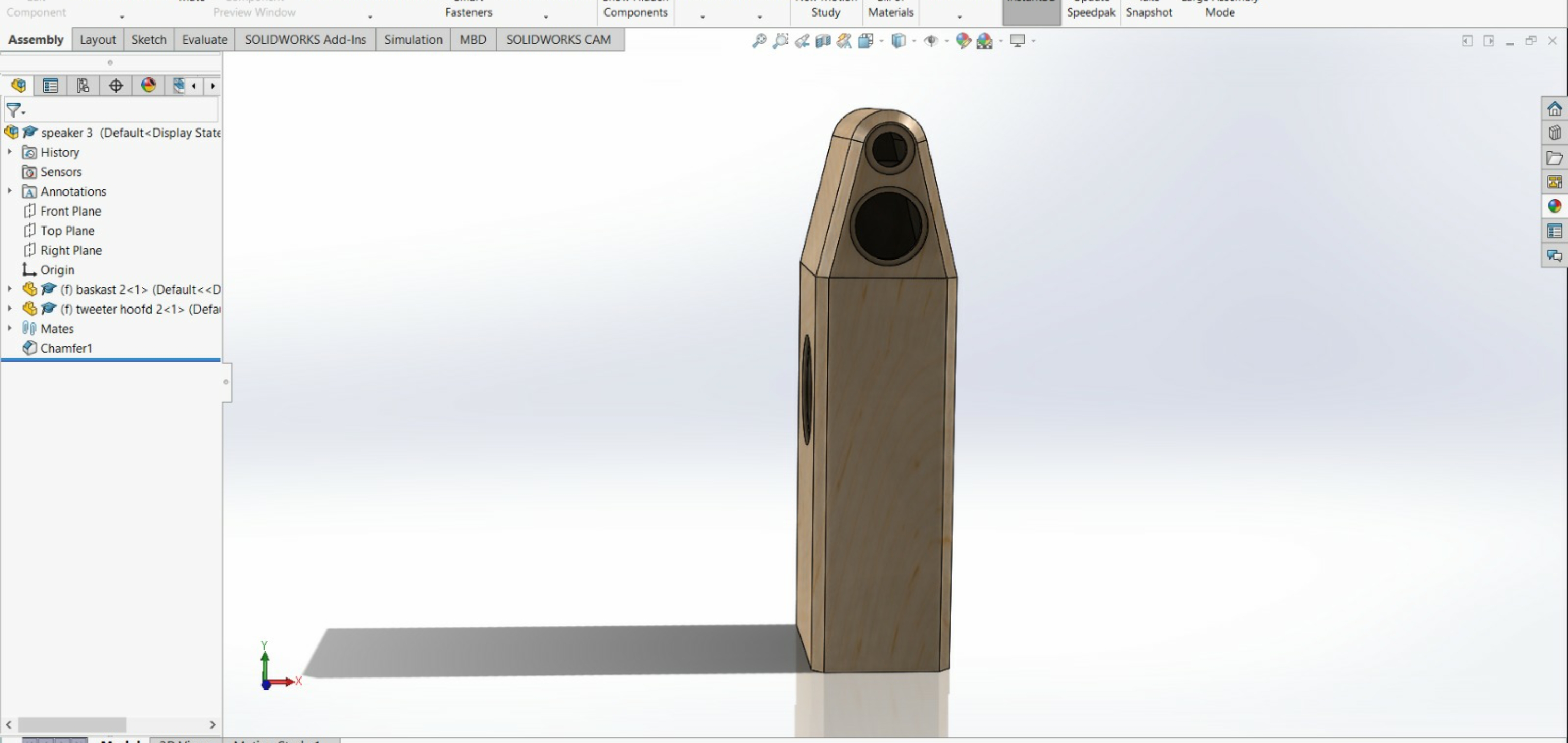

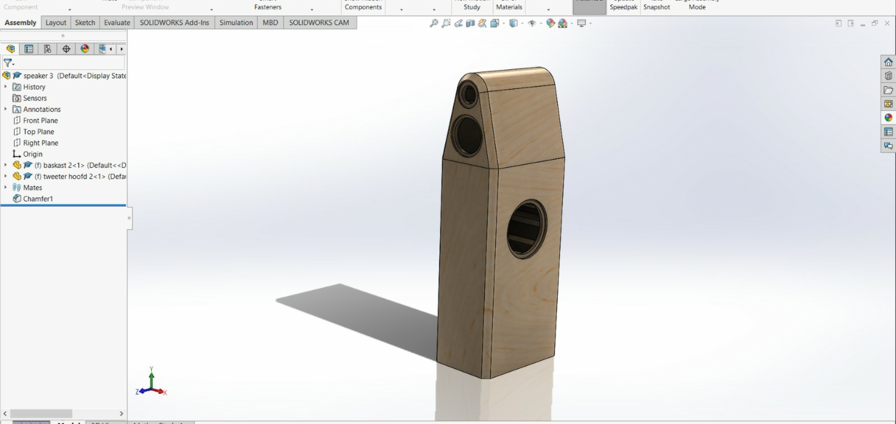

Designing new cabinets, what do you think?
The timing thing only works with a woofer configuration like this, if you use just one speaker in front of you, with a stereo setup, the "outside" woofers are further away from you than the "inside" ones.
This depends on how far you toe them in. If you were to place the speakers perpendicular to the front wall, yes the outer ones would be further away. Though when you toe the speakers in and point them directly at the listening position the woofers will be at equal distance. Now I'm not gonna point the speakers right at the listening position but I will toe them in somewhat. So no the woofers will never be at exactly equal distance but I will get closer.

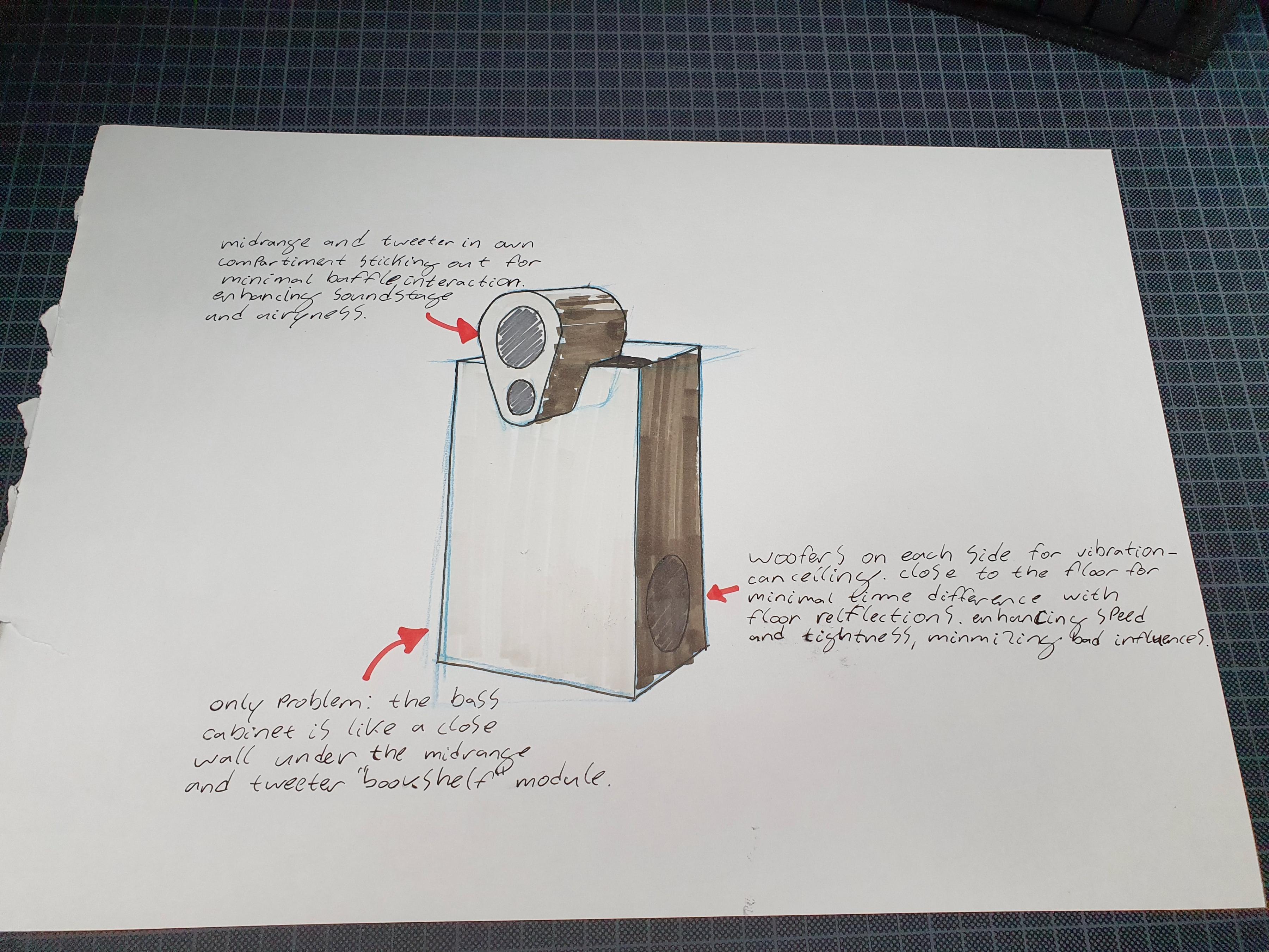

I'm looking into the place ment of the woofers here: Woofer height from the floor -
Techtalk Speaker Building, Audio, Video Discussion Forum
They are saying that placing the woofer close to the floor is beneficial for baffle step compensation. What is baffle step compensation and do I have to worry about it with this active build?
The say that because the woofers are closer to the floor the will couple better with the room and reinforce the bass. Though it makes the bass more reliant on the room and placement. And overal result is less reliable. They're saying placing the woofers low to the floor can result in unwanted modes and resonances in the room and it can make the mid bass muddy and uncontrolled. And crossover integration with the mids and highs isn't as good.
So really the purpose of placing the woofers close to the floor is to achieve reinforced bass at the potential cost of the bass quality and integration. Since I have enough firepower to work with I'm not gonna bother with that.
If come to the conclusion that the best is an array of more woofers spread out across the height of the room. This evens everything out and gives the best results. To achieve this with the woofers on the sides this would mean I'd have to add a second pair of woofers to each speaker. I'm gonna try to make that possible. It will give the best results.
side bass is usually good for close to wall setups.
i dont know about your hearing but i would cross side bass fron max 100hz. over that it really spreads too wide, off the spot gonna be out of phase all over

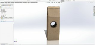

As was pointed out above, if the wavelengths diminish being able to localize woofer location what's the difference between side or front layout ... given your bracing scheme?
The front mounted woofer rendering is my favorite looks wise but I'd wonder about interior reflections off the rear wall with that bracing layout. Might they be like a long horn feeding backward toward the woofer with increasing strength?

Bass cabinet dimension are 42,5 cm deep, 30 cm wide and 85 cm high. The woofer is placed with the middle point at 55,8 cm up from the bottom. Total cabinet height is 120 cm. For the crossovers I was thinking about ~250 Hz woofer to mid and 2,5 kHz mid to tweeter.
According to calculations based on a listening distance of 2.5m and the above driver positions, I would cross around 320Hz. This takes several factors into account.
