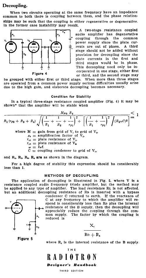

> Is that the convention, 2 stages per decoupler?
It is a safe rule of thumb. Violation is possible but in DIY the brain-pain (See "Condition..") may exceed the cost of a cap.
http://www.tubebooks.org/Books/RDH3.pdf
