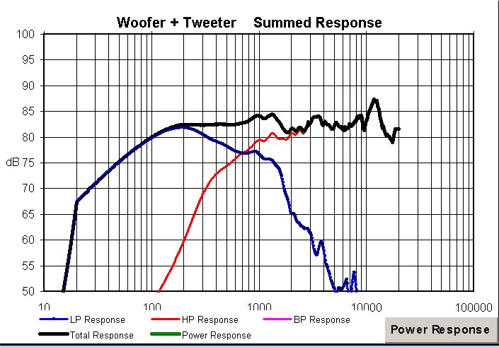

This is how far I got in Passive Crossover Designer:
from that it looks like you are trying to cross it over at about 700hz...thats WAAAAAAAAY too low, try 1900hz instead...

A couple of points:
1. 700hz is not really low at all for that 2" TB driver, unless you are going 1st order. I've crossed the 3" version (871) as low as 350hz 2nd order, and it didn't strain. I would reconsider using it though, the cheap little widerangers from Tang Band/Aura/Hi Vi are hit and miss, sure there are some proven diamonds in the rough, but the majority are 'the rough'. Stick with the known quantities, drivers that have been measured and proved to perform well - TB 871, Aura NS3, Hivi B3N, etc. Start by looking at Zaph's excellent mini-speaker roundup (http://www.zaphaudio.com/minitest/).
2. The little Hi-vi 3/4" tweeter is not well suited to crossing that low. Notice the Fs of 1400hz, and the operating range of 3500-25khz. This is a supertweeter. Since the woofer you want to use needs to be crossed low, you would be much better off with the tweeter Zaph recommended here, or some other tweeter with a <1000hz fs. Again I would stick to the known quantities in the bottom price range, do lots of searching for the model, if you cant find any feedback/info, move on. In the higher price ranges, you can choose a driver from a name vendor (vifa, seas, Scan, peerless, dayton, usher, morel etc etc) and expect generally good performance, at worst mediocre. The se bargain basement drivers (<$20) have some real duds among them, so you have to select carefully.
3. What else you need besides the drivers and the idea to pad one down - I would reccommend some measurement gear and a copy of speaker workshop or somthing like that. Designing with stock XO calculators and no measurements is a crapshoot, and getting something good will more than likely cost you a lot in prototypes. You can of course use the FRD tools which are quite nice, but as Zaph said, you rely on other people's measurements, your own knowledge of when to use which measurement, and which intermediate adjustments of the data are neccessary.

If you want to stick with that tweeter, you probably want a woofer that will roll off smoothly without nasty breakups, since you should be crossing no lower than say 3.5k. Something like the CSS Wr125, or the GR Research m130, soft or paper cone, smooth top end rolloff will make the crossover design a lot easier. Or you could go with a smaller metal 'widerange' like the aura ns3.
