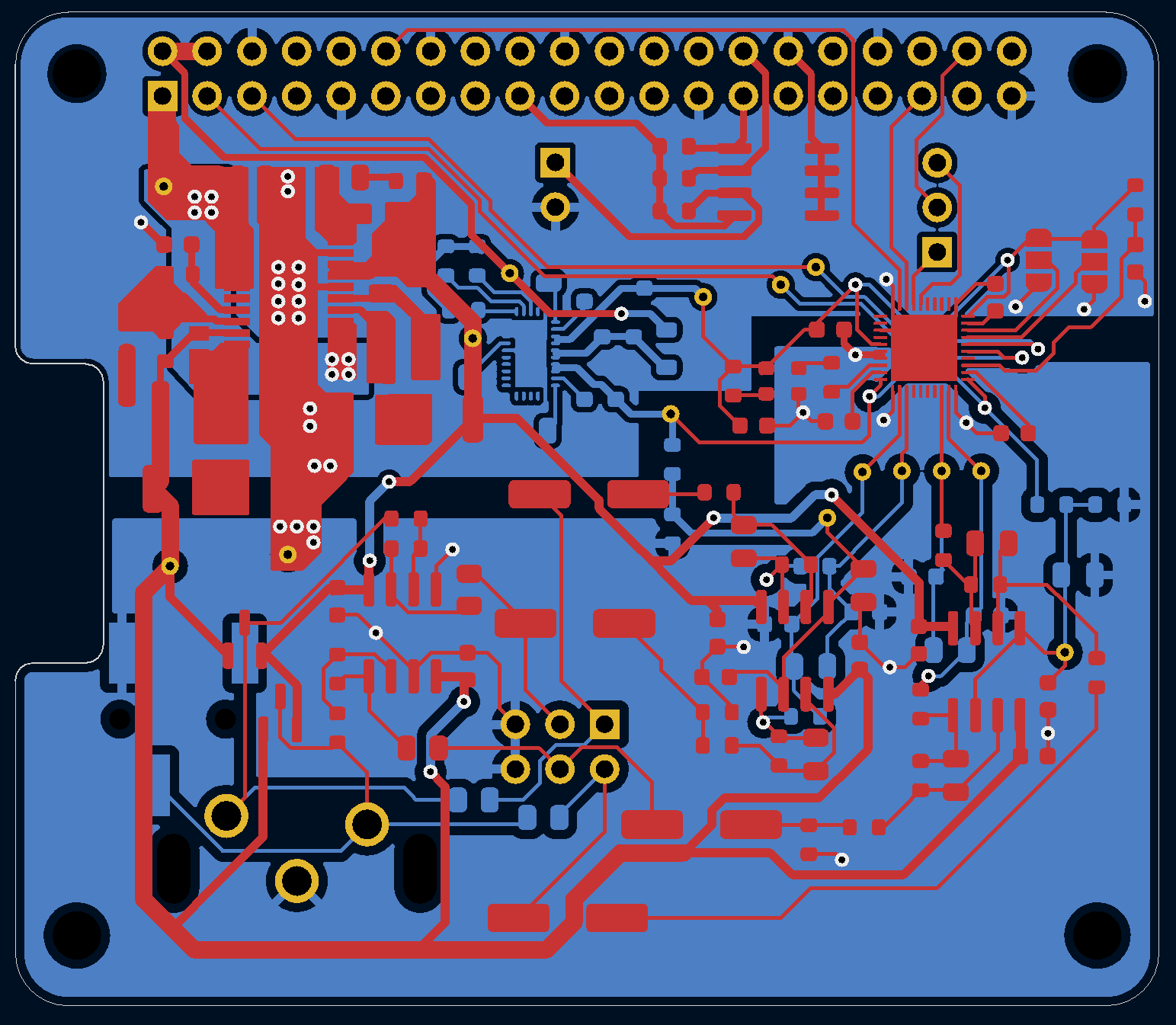

Hi all, thanks for the comments so far. I have laid out the PCB now - see attached. Couple of additional comments:
Once constructed, I will measure whatever I can with my equipment - my DAC has THD+N around -105dB (it's from here).

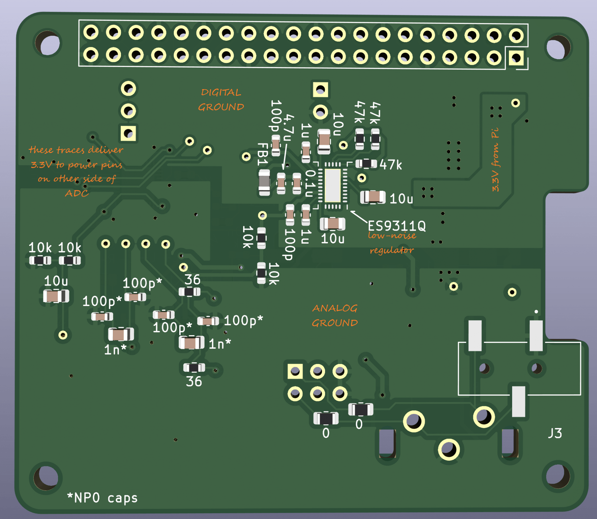

- The input side of the 3V3 regulator is attached to digital ground. One of the outputs is at the top of the resistor dividers that provide the reference for the diff. inputs - the bottom of those dividers is analog ground. The other output is used to power the ADC and also as a pull-up for EN and the I2C address pins.
- The analog side is furthest from the Pi header, so that return current from digital components should not pass through the analog ground plane.

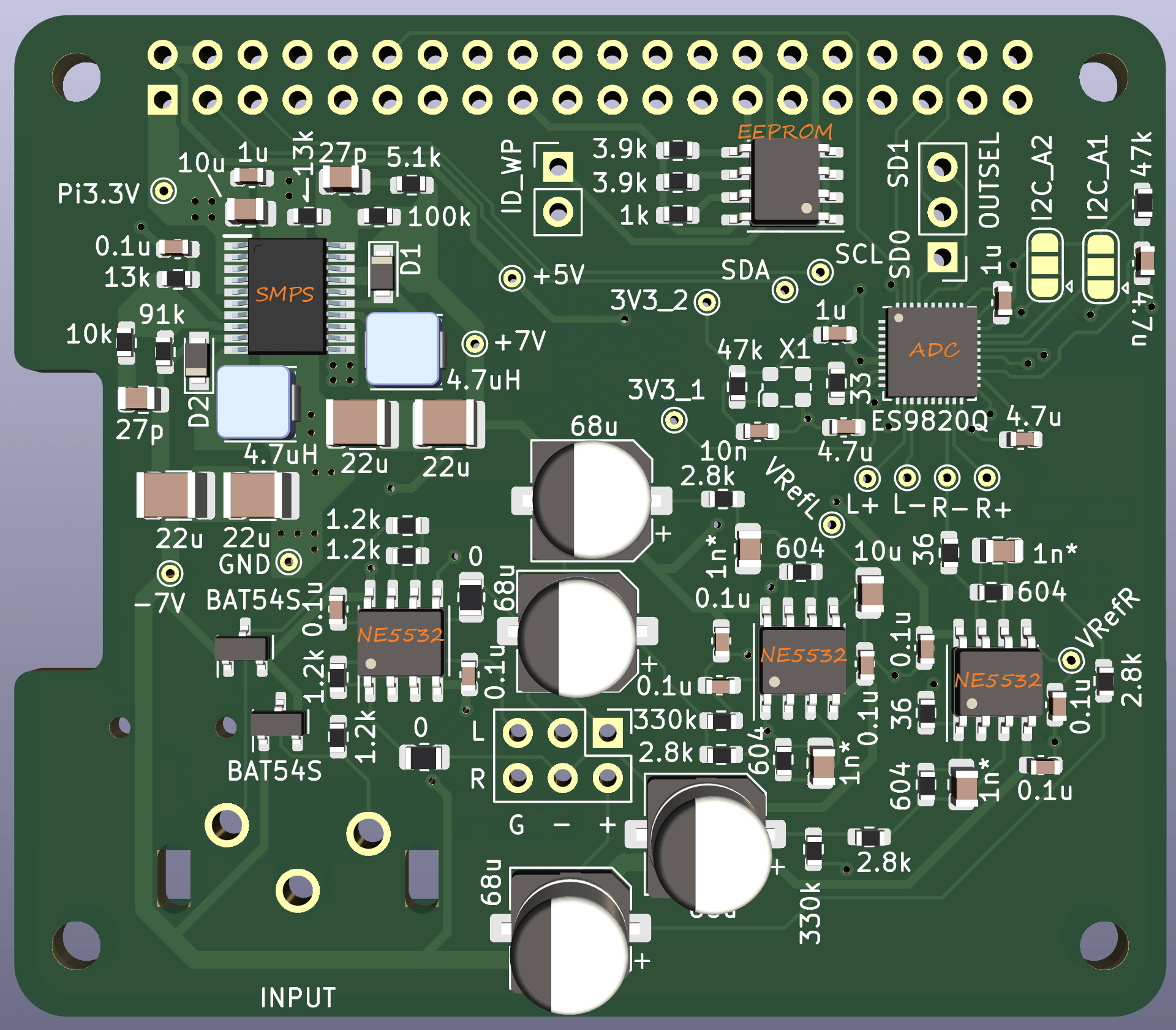

Maybe wiser to put the SMPS on the bottom side, off in one corner, and all the sensitive analog stuff on top (including the ESS voltage regulator) on top and away from the SMPS corner?

I was a bit unsure where to put the ESS voltage regulator, but now that you mention it, it probably needs to move. If I move the flash chip to the bottom side, and put the ESS voltage regulator on the top side, where the flash chip is now, it might work better.
What's the motivation to move the SMPS to the bottom side? I would prefer to avoid putting the inductors and 22u caps on the bottom side of the board.

You might want to check out this thread in general and the specific post about 9311 robustness:It will be pretty similar to the datasheet circuit, using ESS's own ES9311 regulator to power the ADC chip

Maybe ground/power plane areas inside the board can help act as electrostatic shielding of radiated SMPS noise. That's how Allo ended up laying out Revolution DAC which used SMPS. Those guys are very measurement oriented, so I expect they could measure some benefit. IME ground planes can be useful for shielding as well.What's the motivation to move the SMPS to the bottom side?
If the power supply is cornered away, it would be easier for the currents to enter and return through short paths that do not interfere with the rest of the sensitive circuitry. Plus, if the SMPS is on the opposite side (and you have ground / power planes like bohrok2610 recommended), there would be some shielding due to these planes (as already mentioned by Markw4).What's the motivation to move the SMPS to the bottom side? I would prefer to avoid putting the inductors and 22u caps on the bottom side of the board.
However, if these planes are occasionally interrupted by routing and / or plated through-holes / vias, then it is not guaranteed that the return currents would exactly trace the supply currents physically. So, it's best to keep the routing to the outer layers (only), and avoid TH components as far as possible. Besides, these planes are often necessary to get decent performance from an on-board SMPS.
I would recommend putting inductors on the bottom (along with the SMPS), as they appear to be drum-cores that have an open magnetic flux path. Though this helps provide a large air-gap and high saturation currents, the flux lines entering / leaving the gap can induce stray voltages in nearby conductors. The ground/power planes falling in between would, once again, at least partially shield the sensitive components electromagnetically. A core with a closed magnetic path would have its flux more contained but then drum core is the popular choice in such small power applications.

The SMPS is only powering the op-amps, which means it is very low power. The location of the SMPS is currently as close as possible to its input source (5V from top left pin of Pi header), with the analog section as far away as possible. Another thing I had in mind was that large components on both sides might be an issue since they might fall off during reflow, but I can just hand-solder the inductors.
I suspect moving SMPS to other side of a 2-layer board will only be a marginal improvement, but it's unquestionably best practice, so I will just do it anyway.

Since you have components and routing on the these layers, there's not going to be enough scope for an unbroken ground pour that is necessary to get good performance. A 2-layer ground plane PCB works well only if all (or most) of the components / routing are on the same side, which is clearly not your case.I am just trying to understand if it is worth building a 2-layer version (with the SMPS circuitry on the backside as recommended) and measuring the performance to see if it meets the desired goal?
