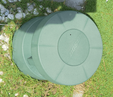

It was somewhat amusing to see the speakers they used at the island we visited, called "Crossroads" - a dedicated tourist shopping and dining location. If you stay in the main island or the next one, a day trip to the island is not as expensive as you might think, and I would recommend it to anyone. From the website you can see what it is like, and only a 15 minute boat ride from Male.
I attach images of the speakers used: both outdoors and indoors. The outdoors speaker sounded good enough, playing recognizable songs that were pleasant to listen to, and with sufficient bass.
The indoor speakers, large, overhead mounted, were playing at volumes that were registering 60 dB at the listener. There was no bass, which is why they need a subwoofer, or to enable loudness, or equalize. The high end was not there, and from what is known from the Fletcher - Munson curves, this is to be expected.

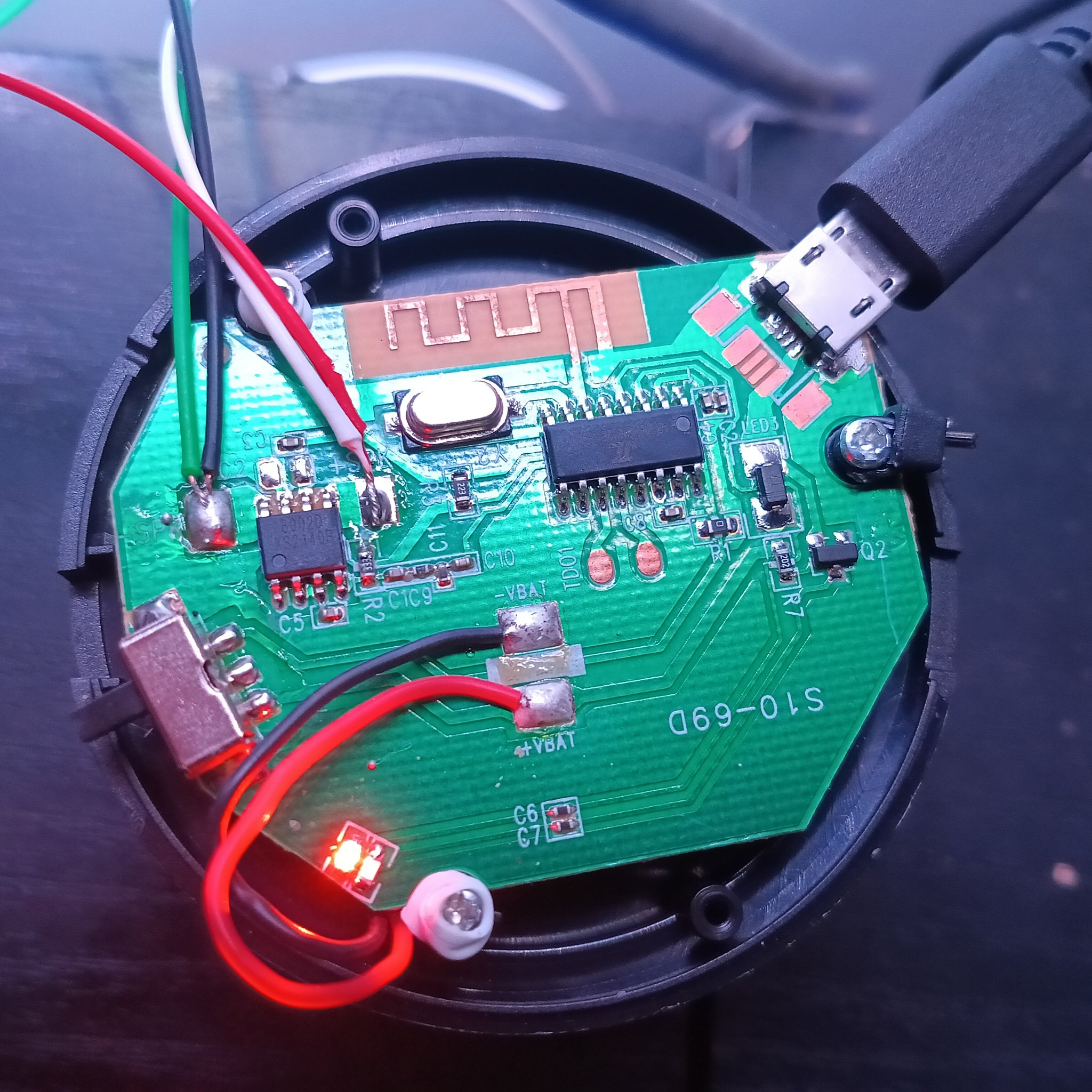

There is a serious problem running off a battery bank meant for charging mobile phones, the power shuts off after a few minutes, maybe the sensors indicate that resistance indicates that the battery is fully charged. Back to AAA batteries and battery packs, ultimately rechargeable.
After I wrote the above lines a few days ago, I realized that the entire DC input circuit was not working with AAA batteries as it did before. No light nothing. Maybe the input circuit is burned, I am running off an USB charger and 5V USB input. Could sound better.

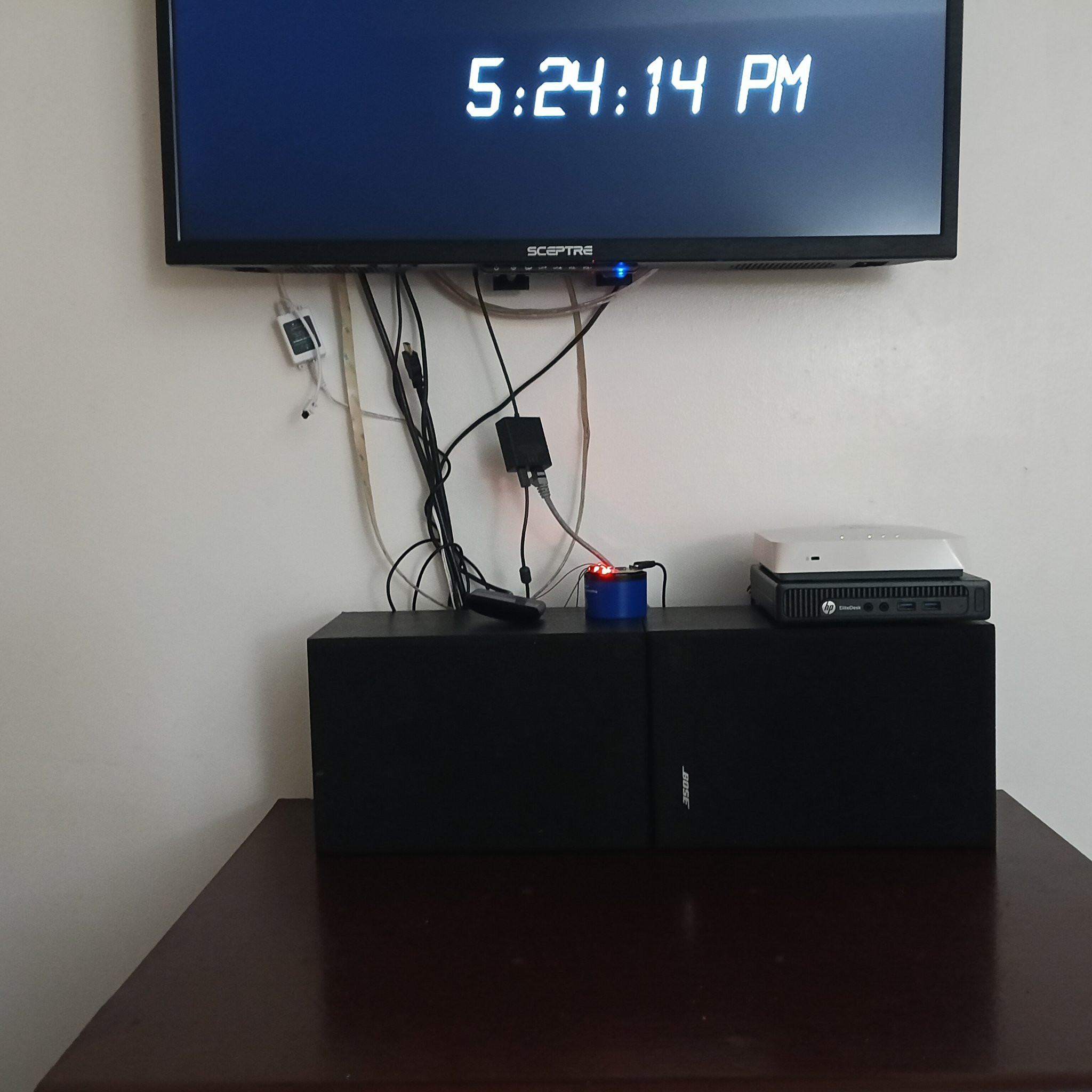

Hi all,
I have done this several times. Went to the thrift store to find some cheap speakers and mod a bluetooth speaker for its amp.
this setup
$10 Bose 21 bookshelf speakers
$3 some Volkswagen bluetooth speaker
$1 cable to use for wire.
$6 soldering iron from harbor freight
8002d ic.. running speakers in series.
It sounds best when near full volume.
At first i had to add 6db at 50hz to get it to sound right.
It made the bt-amp auto adjust to like 80% max volume. it sounded like more power less gain therefore better sound.
After some playing around with different dsp and such:
I simply set foobar to 'downmix channels to mono'. Bingo. sounds perfect and gets plenty loud.no other eq settings needed.I am surprised by the sound.
It doesn't come close to my home setup (scanspeak classic 2way, briangt lm3886, audiogd dac 8x 16/441, dayton titanic 12" dayton spa1000)
With other bluetooth speakers, I had problems with ones that have a mic built in.
I think they autoadjust for voice calls and such so the mic provides feedback to the dsp
I didnt do much testing as these setups are for friends who dont have much.
Other stuff in picture..
Roku
Chromecast w/ ethernet
Extreme networks AP with openWRT
HP G1 mini PC with ESXi
LED controller
42" lcd tv
-Marshall
