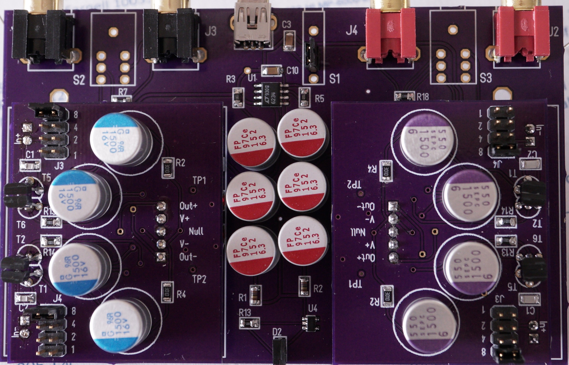

The first clone that I am aware of has come to life. It still needs the switches and thermal coupling of the input transistors, and some day a box to live in, but that's about it.
Thank you again, Hans.
Well done, nice soldering.
Hans
You can probably find 0,47µF PETs. No significant difference.
No, I find only a 2416 PEN 0.47µ, not fully fitting and not exactly same technology
And if anyone in europe is getting a set of boards I'll share the cost as MOQ is usually 5
Yes please...me too (x2 sets for UK)
Thanks.
2220 PET caps are going to be a fairly good fit. WIMA and AVX have those.
Thank you Grufti. I saw those ones already but abandonned them, the pad not being as wide as recommended in the datasheet, but they can fit, yes. Still I wonder
@Hans, I know you mentioned not to be involved in any build but are you indeed using 2412 PET film caps for C7/C8?
This is the cap that I used from Mouser.
CB042D0474JBC AVX | Mouser Nederland
Hans
Two additions:
1) In the Mouser link above, you are directed to the correct 0,47uF component, no worries, however I believe they made a typo. There is no such thing as a CB042.... this must be CB047......
The same component from Farnell is listed as 1657965.
2) In the BOM a ADA4528 is listed. There are two versions, one with 1 amp and one with 2.
The version needed here is a ADA4528-2A with 2 amps.
Hans
