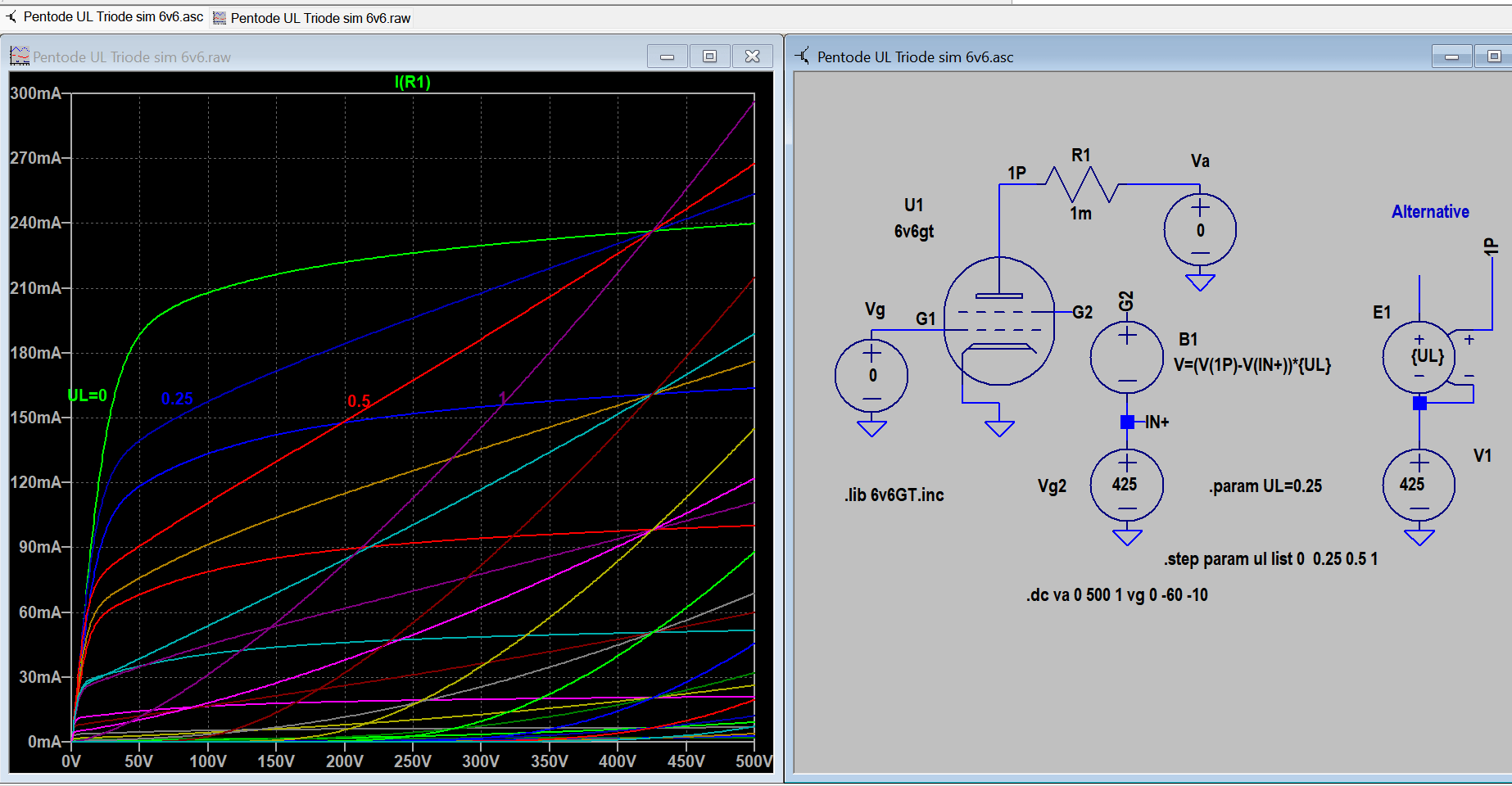

Have you seen the UL curves? It might help you to determine the optimal loadline
https://www.diyaudio.com/community/threads/6v6-line-preamp.102352/post-7045150
In this post I describe how you can record the output of the design and playback. Obviously you can hear the difference between Pentode (no UL) and triode (100% UL). and anything in between. This does not mean final sound, but is a good start, as it depends a lot on OT in addition, you can compare with and without OT. It's fessible to build the UL using active feedback first rather the actual OT UL tap.
