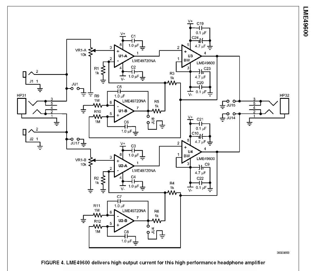

The LME49600 is the ideal solution for high output, high performance
high fidelity head phone amplifiers. When placed in
the feedback loop of the LME49710, LME49720 or
LME49740 High Performance, High Fidelity audio operational
amplifier, the LME49600 is able to drive 32Ω headphones to
a dissipation of greater than 500mW at 0.00003% THD+N
while operating on ±15V power supply voltages.

yes, with a unity gain for both the op amp and the buffer at 1khz.
with a 20db gain, distorsion will be 0.0003% at 1khz and
dramaticaly increasing at 10khz, that is, no better than the
vintage 5532.
Beware of the marketing optimized figures..
also, the distorsion is specified in a 80khz bandwith, while
the figures i quote with the ne5532 + bjts are for a 5mhz bandwith..
What about the total cost using the NS circuits?..
A NE5532 + a pair of darlingtons is about $3....

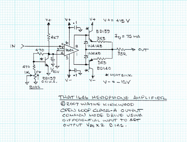

This headphone amp caught my interest earlier today......
HeadWize: DIY Workshop > THAT1646 Headphone Amplifier
THAT1646 + BD139/BD140.... Class-A.
I wonder if a DRV134 could be used instead?

This appears to be in reference to THD+N, not the THD component thereof. In which case it's correct, albeit somewhat confusing, if the noise gain is also 20dB.with a 20db gain, distorsion will be 0.0003% at 1khz
The figure is for a relatively high output level at which noise
is much less than THD.
Increasing by 20dB the gain of the op amp that drive the unit
will yield the same increase in distorsion as the available negative
feedback will be reduced proportionaly, so even if noise is increased
by 20db, THD will still be prominent.

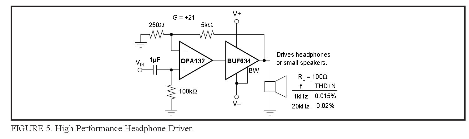

I think I know what your getting at, below is a pic of buf634(basically an lme49600) headphone driver at a gain of +21 with related THD+N figures,bit different to the unity gain figures of lme49600.
hi, shark70
The gain of this one is 24.44db, which is quite high, therefore,
the distorsion is somewhat significantly higher than with a 49710 + 49600
used in an unity gain scheme..
Also, the opa132 has not as good distorsions figures as a 49710,
and is even inferior to a 5532 if the input impedance of the buffer is
not high enough, not counting that it has double the noise of a 5532
and 3.5 folds the one of the 49710.
49710 or even 5532 would do it better to drive the BUF634 which seems
himself inferior as a 49600 in matter of maximum output current, as
the load is displayed as a 100 ohm one.
Anyway, a lot of solutions exists, and it s a matter of performance/price
ratio.( and also of psychologicaly influenced taste..)
Using cheap op amp + darlingtons allow a low cost circuit with no compromise
in perfs, as it got a current capability than no integrated buffer can match
at a reasonable price, and very low distorsion because the driving op amp is very
lightly loaded.

That is very amazing. Well worth building. I didn't check the DRV134 data sheet, but I believe that the design is THAT1646 specific. I prefer the THAT part regardless.

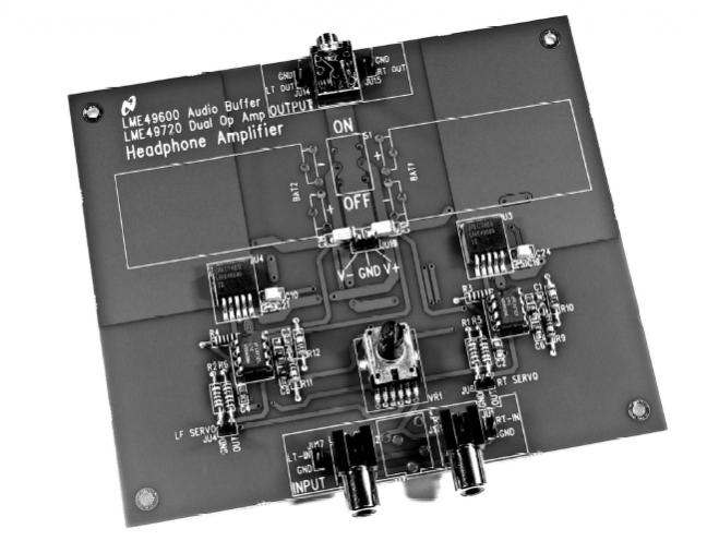

For anyone interested in the LME49600 National reference design in this thread, I'm going to be spinning a DIY-friendly PCB, taking measurements, etc. Before I go too far, I'm trying to get an idea if there's interest in a group buy of boards? If you might be interested, please see this post:
LME49600 Headphone Amp Design
