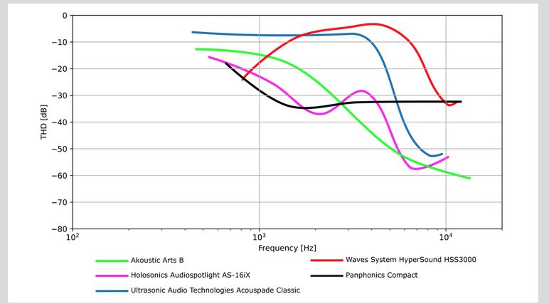

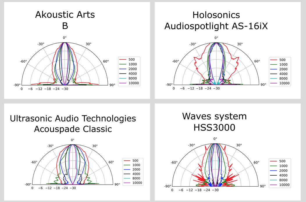

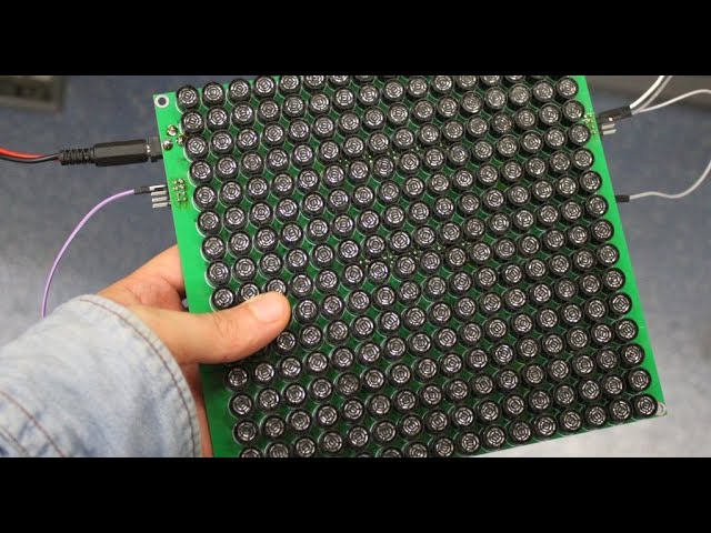

For ultrasonics, don't they need all sorts of electronics to function, beyond the DIY scope? And maybe they can't play below some really high frequencies? Maybe not. I can look into it more.

There is not many options for high directivity i can think about: either from the driver ( eg ribbon are extremely directive in vertical plan), from the layout ( but might need 'special' filters) or waveguide/horns. Or a mix of those.
It's not very difficult to achieve for mid/high, it's much more a challenge for low/low mid freq as Hornbach Keele paper present ( for control to circa 100hz you would need something like 1,6m ctc distance which makes for huge box if implemented for both horizontal and vertical).

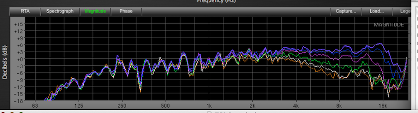

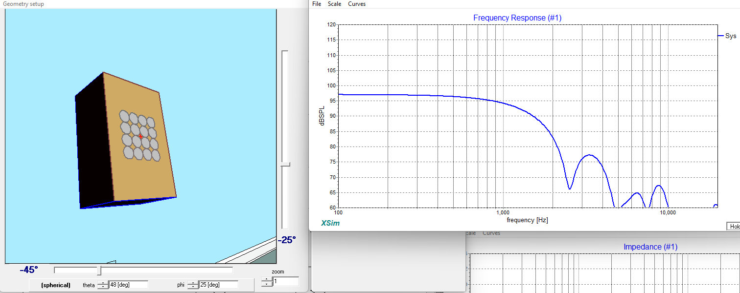

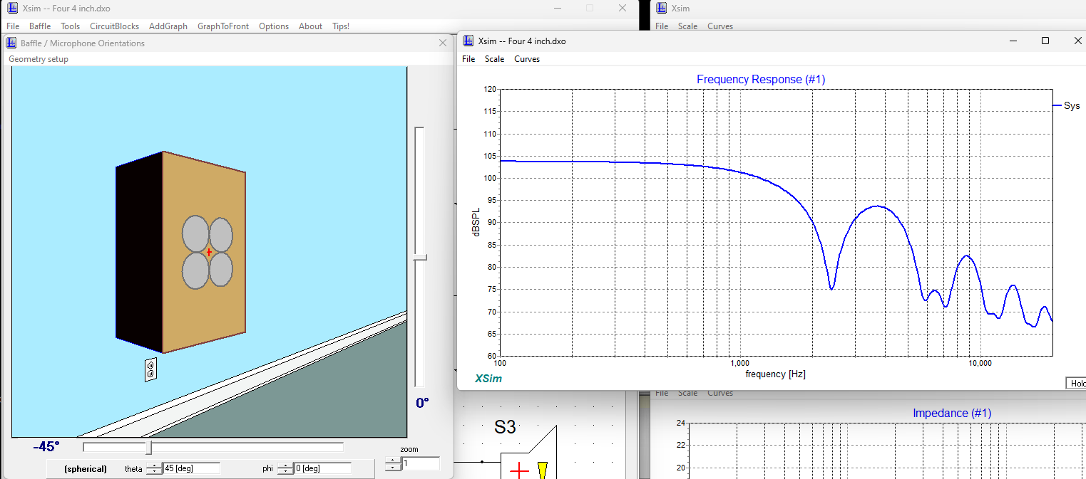

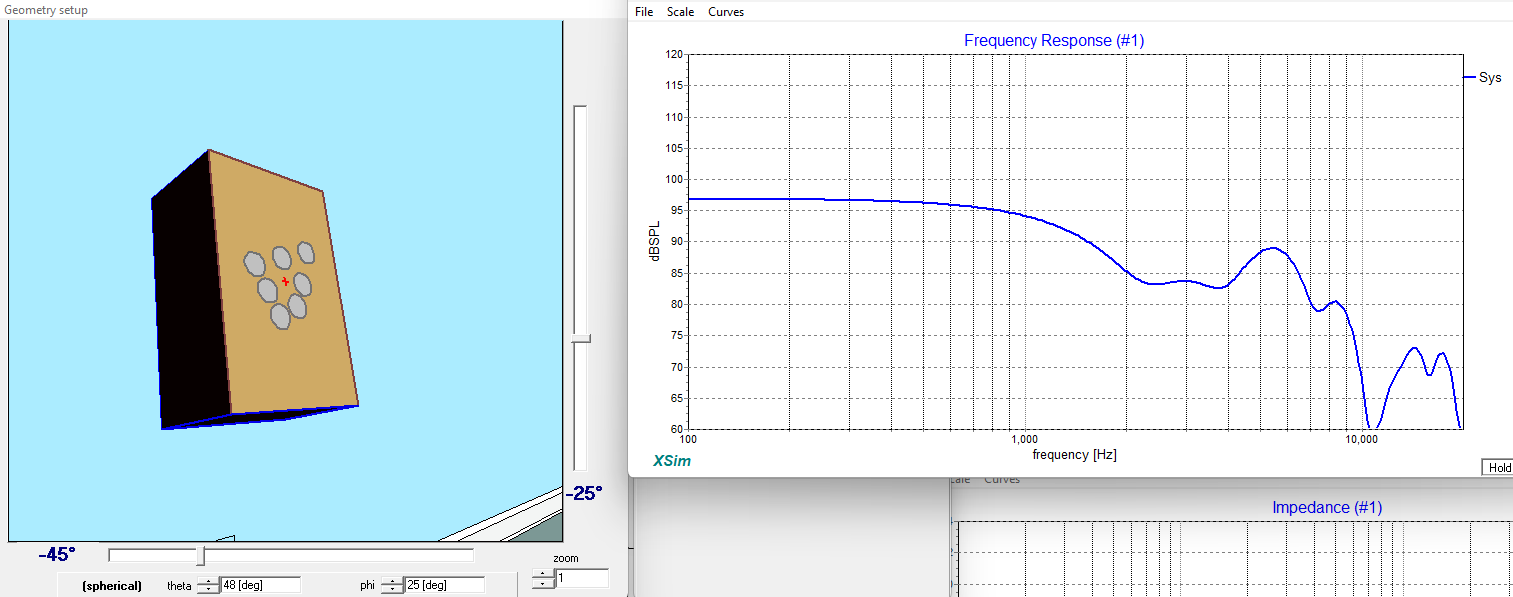

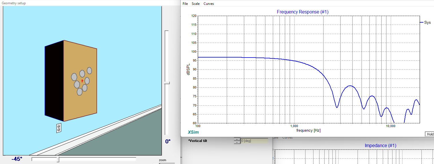

Also interesting is how different speaker array types are looking. It’s not a direct comparison, but taking two of your simulations…
16 x 2” divers, the peak at ~4,500 Hz is down ~20 dB from the top:
But in the case of 4 x 4” drivers the peak at ~4,500 Hz is only down ~10 dB from the top:
I really need to get a simulation system running so that I can start comparing all sorts of arrangements.

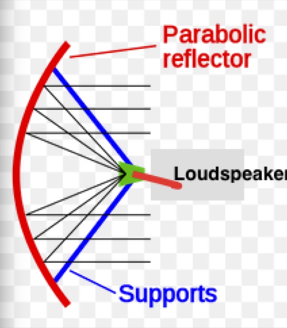

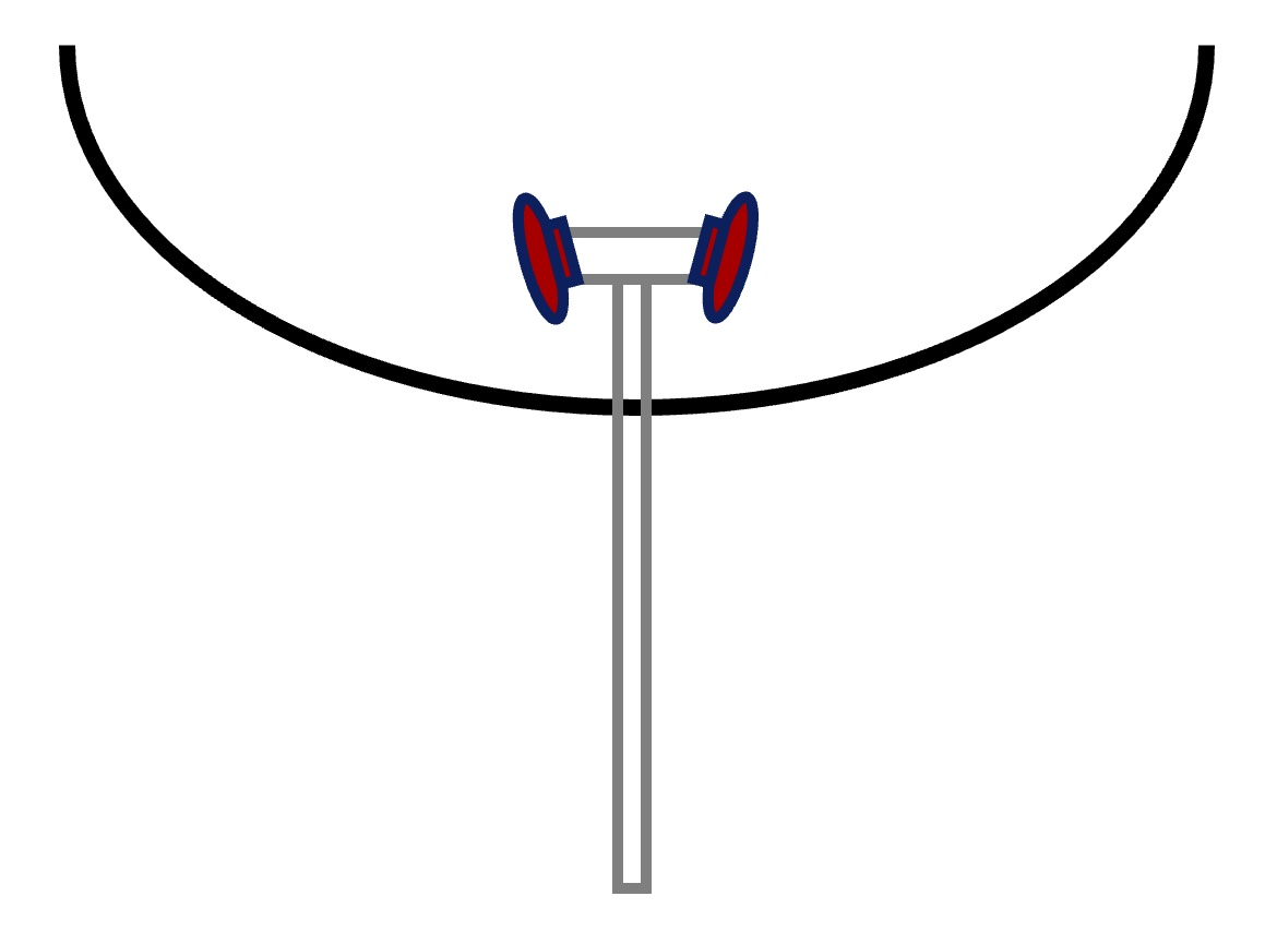

I’ve been reading more about how to get directional sound. A very interesting topic! Having arrays of drivers with canelletions and such is one way to go, but there will still be some sound spilling out here and there. What looks to be more promising, at least for now, is the use of parabolic reflectors. Lots of info out there.

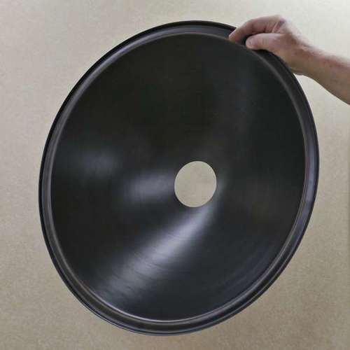

The basic idea is to get a parabolic reflector. Put a speaker(s) in the middle, pointed at the reflector, and then the sound reflects out in a cylinder. The sound will stay directional at frequencies down until the radius hits the frequency length.
OK, how can we build a prototype for testing? Look around for a good reflector. Lots are available, such as for lamps. But you don’t know how parabolic those shades and photo reflectors really are. Plus many are crazy expensive. I found two sources that look promising. One is for these plastic reflectors, which seem to really be true parabolas:
https://www.wildtronics.com/parabolicdish.html
$85, plastic, durable, has a hole in the middle for poking a driver through, 22” diameter. They say exactly where the focus point is. A little large, but seems to be a good option for playing around to test the concept. Would keep sound directional down to about 1,100 Hz, which seems about as good as we’re going to do.

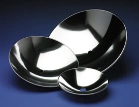

And these optical parabolas:
https://www.edmundoptics.com/f/larg...gvq2HIEJ5JXoiroIl6V73mzYRij7MRM9SEFX9M0-dYglk
12”, 18”, and 24”. $65-$125. I like the 18” size, but the hole in the middle is only 1.125” diameter, which might be tricky for what I have in mind. But it’s an option.

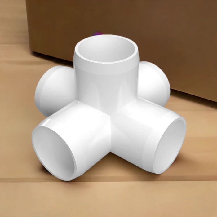

How to build a prototype? You could suspend one full range driver in the middle, pointing at the bottom of the dish. But there is a hole there where you will lose sound. Plus it might be tricky to hang an entire “cabinet” for the driver in the middle of the dish. This cabinet would need volume for bass output. I realize that bass is not a priority here. But we probably don’t want to try playing a driver hanging in free air. So instead, I’m thinking about the following…
Get a 5 way PVC coupling like this:
Put 4 full range drivers on the 4 openings. In the middle 5th position put a piece of long PVC pipe. The long pipe will both be a place to go through the hole in the dish to hold the 4 drivers at the focus point and also to provide volume for the drivers. Tune the length of the PVC to whatever volume you want. (Maybe add an adapter and move to larger diameter PVC pipe below the dish if more volume and less length is needed.)
Find 4 full range drivers with round flanges to seal onto the PVC. Pick drivers with sizes matched to fit the available PVC sizes.
Try to sand down the 4 PVC openings to add an angle such that the drivers point at the dish at something approaching the correct angle for a proper reflection outward. I’m guessing that making the angle in the PVC at the correct angle would mean that the rear of the drivers will bump into the inside of the PVC. So just try to add as much angle as possible. Or add a 30° or 45° elbow to each of the 4 openings? This angle aspect need some more thinking. Actually, having the drivers just stay 90° from the long pipe might be the correct reflection angle. So no sanding or funny angles needed.
The general idea might look like this simple drawing:
Not sure how I’ll hold it all up yet. Ideally, I can have it arranged horizontally, to test the directionality of the sound by walking past it, back and forth. Then put it vertically, like in the drawing, to test it bouncing off the ceiling.

I don’t know if this is silly or not. But it sure sounds to me like something fun to try out.

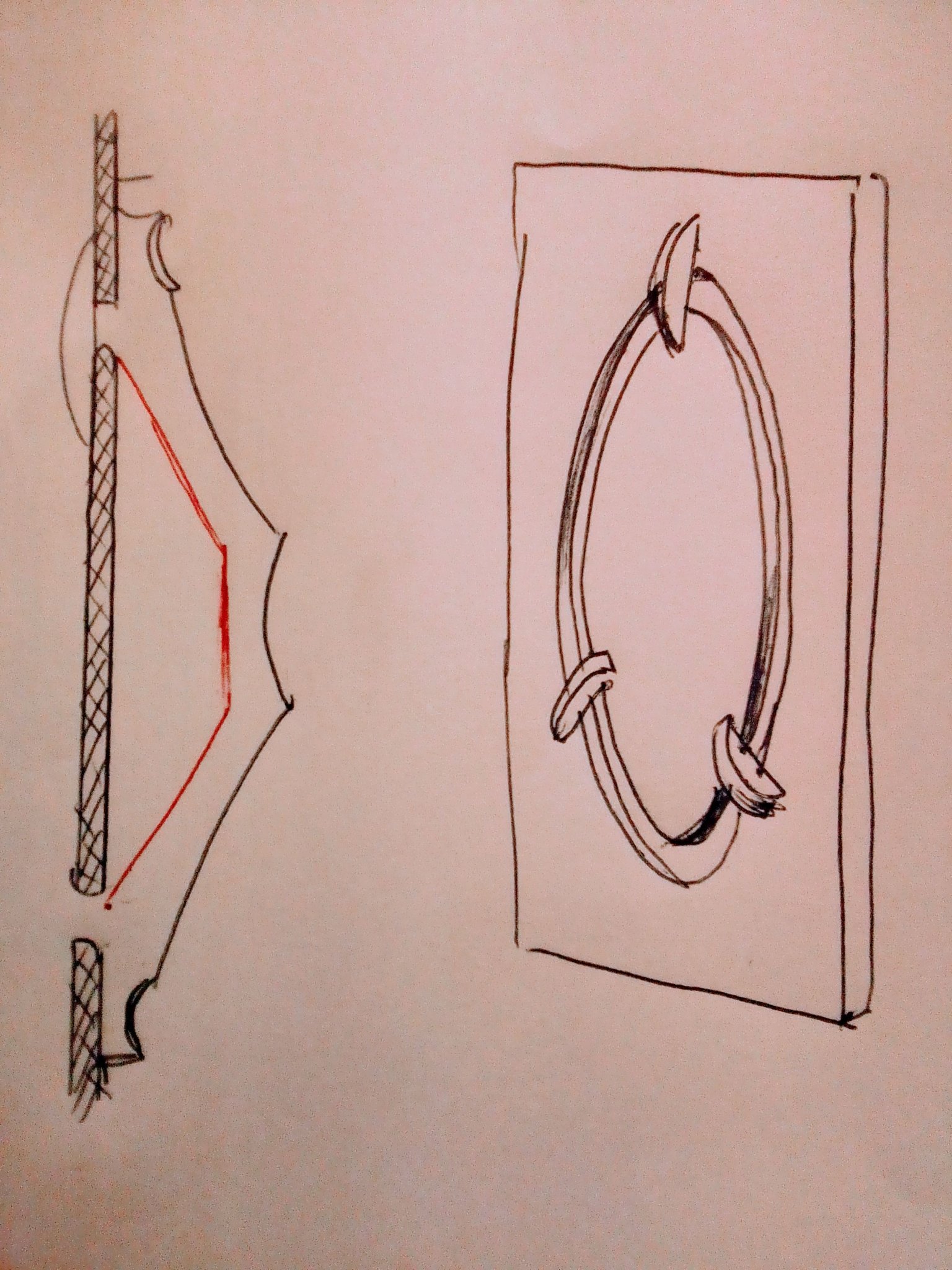

Right. Parabolic reflectors are used for microphones. It should work for speakers, too, which are just the reverse of the microphone. And has been shown to do so, by people including Art/Weltersys, as I have read. So the idea is not new. Maybe it has not been used in this context that I am after, a ceiling reflection. At least not that I have seen yet. Could be a fun experiment.
For the lower limit of frequency, it will just be the radius of the reflector and what frequency that distance correlates to. So for a 22" parabolic reflector, an 11" radius correlates to about ~1,100 Hz. Everything above that will be directional. Below that and it will not be directional. A bigger (or smaller) reflector will be directional to lower (or higher) frequencies.
The speaker's polar pattern determines the near field response, most of it's radiated sound will bypass the reflector dish. If using a very narrow horn source directed at the dish, the near field sound will be minimized to the extent of the horn's directivity, but the -6dB near field spill will be louder than the reflected ceiling sound. The Haas effect will place much of the perceived location at the point of first arrival.The basic idea is to get a parabolic reflector. Put a speaker(s) in the middle, pointed at the reflector, and then the sound reflects out in a cylinder. The sound will stay directional at frequencies down until the radius hits the frequency length.

4" will be slightly more directional than a 3.5":Put 4 full range drivers on the 4 openings.
Below ~2kHz, the 4" drivers would be near omnidirectional, most of their sound would spill out of the dish.
The center to center distance between the drivers will cause lots of comb filtering across the reflected image, reducing the realism of ambient effects.
The smaller the driver, the higher in frequency it will "go omni".A couple of drivers that look appealing from an initial round of seeing what is out there:

For your application, the used of combined ultrasonic sound as used by Akoustic Arts, Holosonics, or similar products is more effective in restricting dispersion than even a six foot diameter dish.
https://www.akoustic-arts.com/produ...nics-ultrasonic-audio-waves-system-panphonics
That said, ultrasonic range is limited compared to parabolic or hyperbolic reflectors due to high frequency air absorption, the ultrasonic devices have more distortion than conventional drivers, and I am concerned about the long term effect of the high SPL ultrasonic sound used in these devices on hearing.
