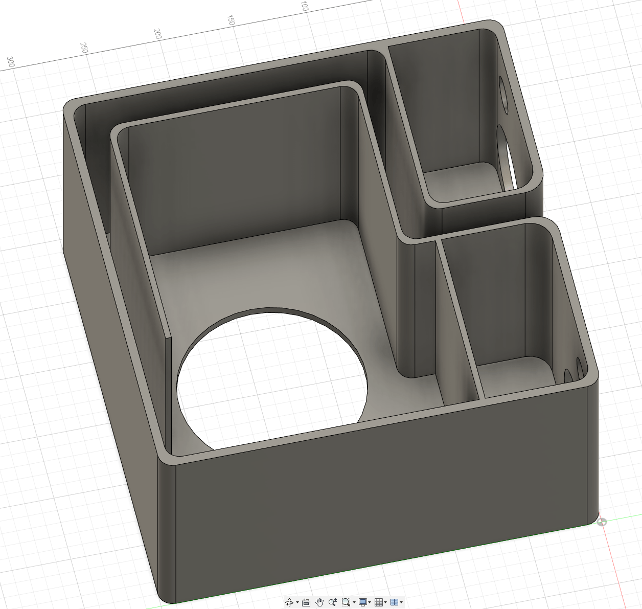

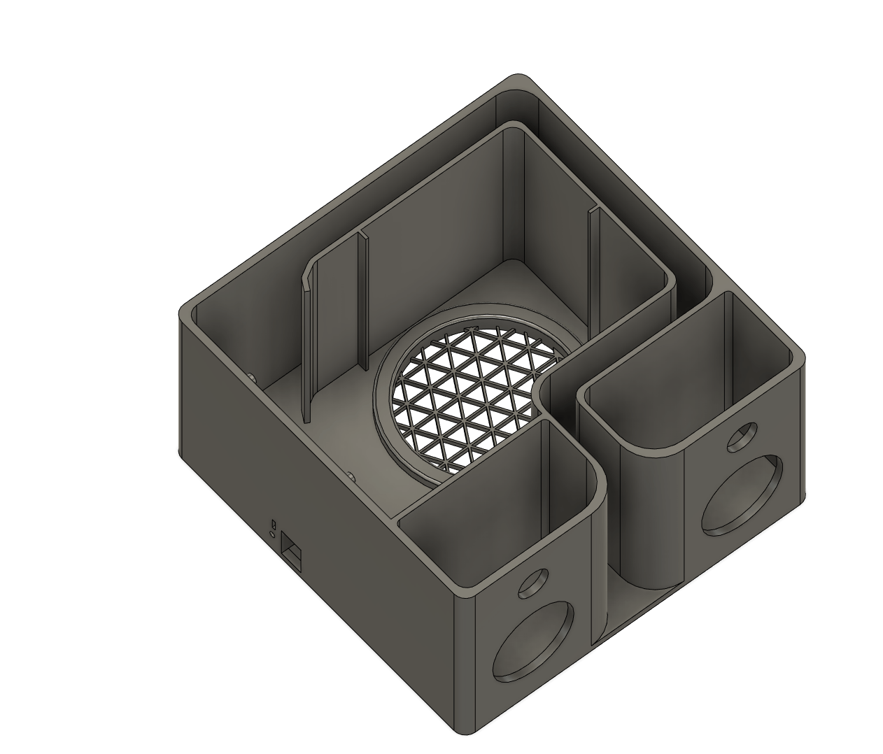

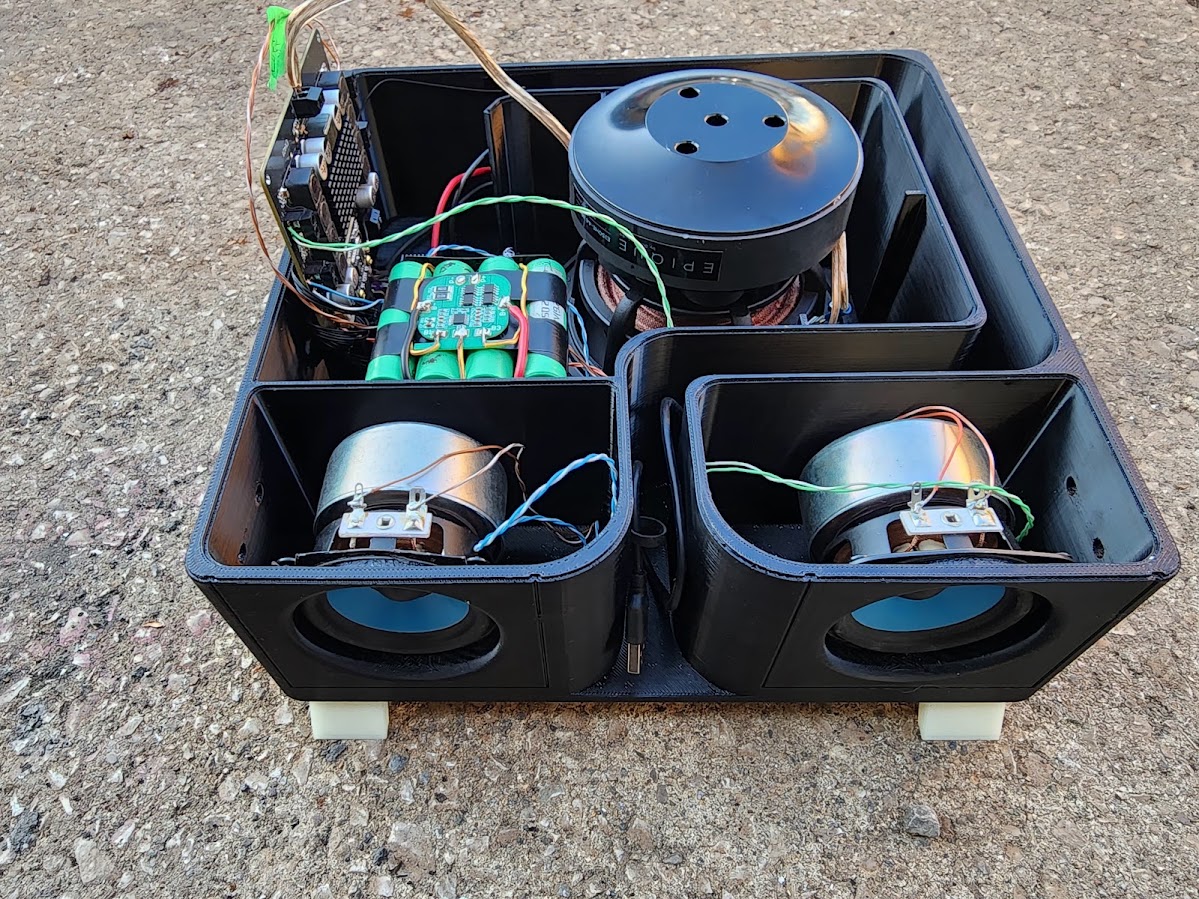

Ok, how's this look? That's
Should be ~8L NOT including the port volume. I need to check the math again but it's right about that. You don't include the port volume in the sizing, right? The chamber volume is separate?
I know I still need to add a flare at the one end. And do a bunch of other stuff. Like probably fix those corners more, etc.
Port internally is 20mm*153mm*600mm, which is roughly equivilent to a 64mm round port. (3216mm^2 for 64mm round, 3060 for this. ehh, pretty close. I could probably make that wall 1mm thinner to find those extra 200mm^2 if I need to.
Reactions: freddi
The wall thickness is 6mm for most walls, 4mm for some.
Internal volume is only ~7L excluding the port, 9L including it. No way to make it bigger on my printer aside from going even taller, and it's already 3/4" taller than I was hoping it would need to be.

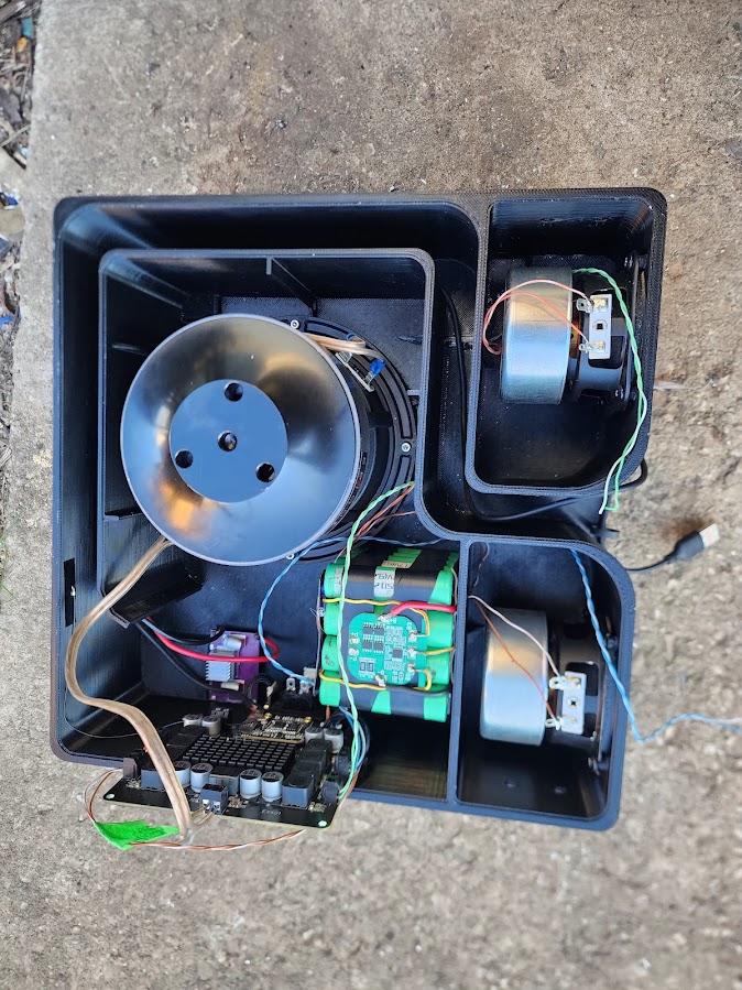

My DSP/amp and battery board showed up today, but the design is mostly finished. I still need to figure out a handle and feet. 1"/25mm should be tall enough for the subwoofer to work properly, right?

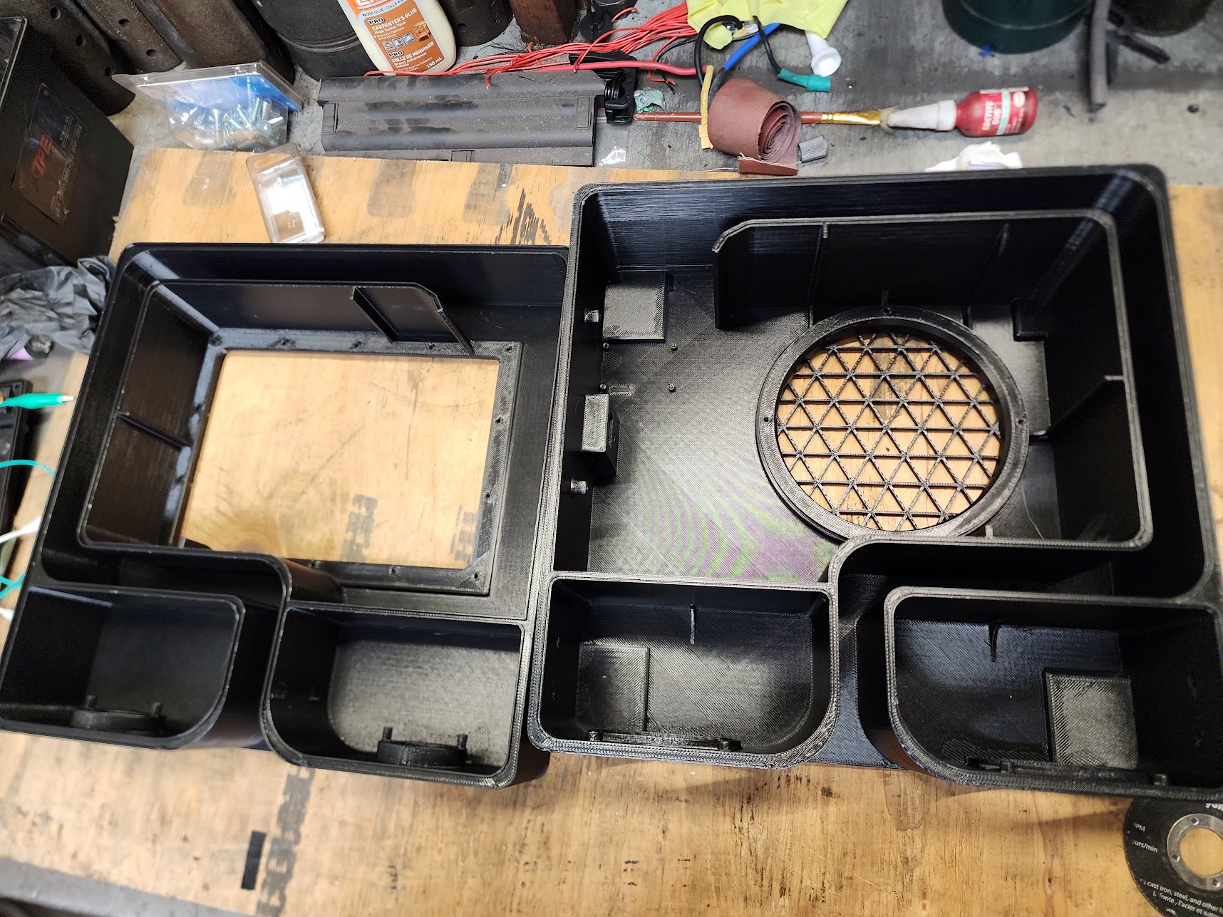

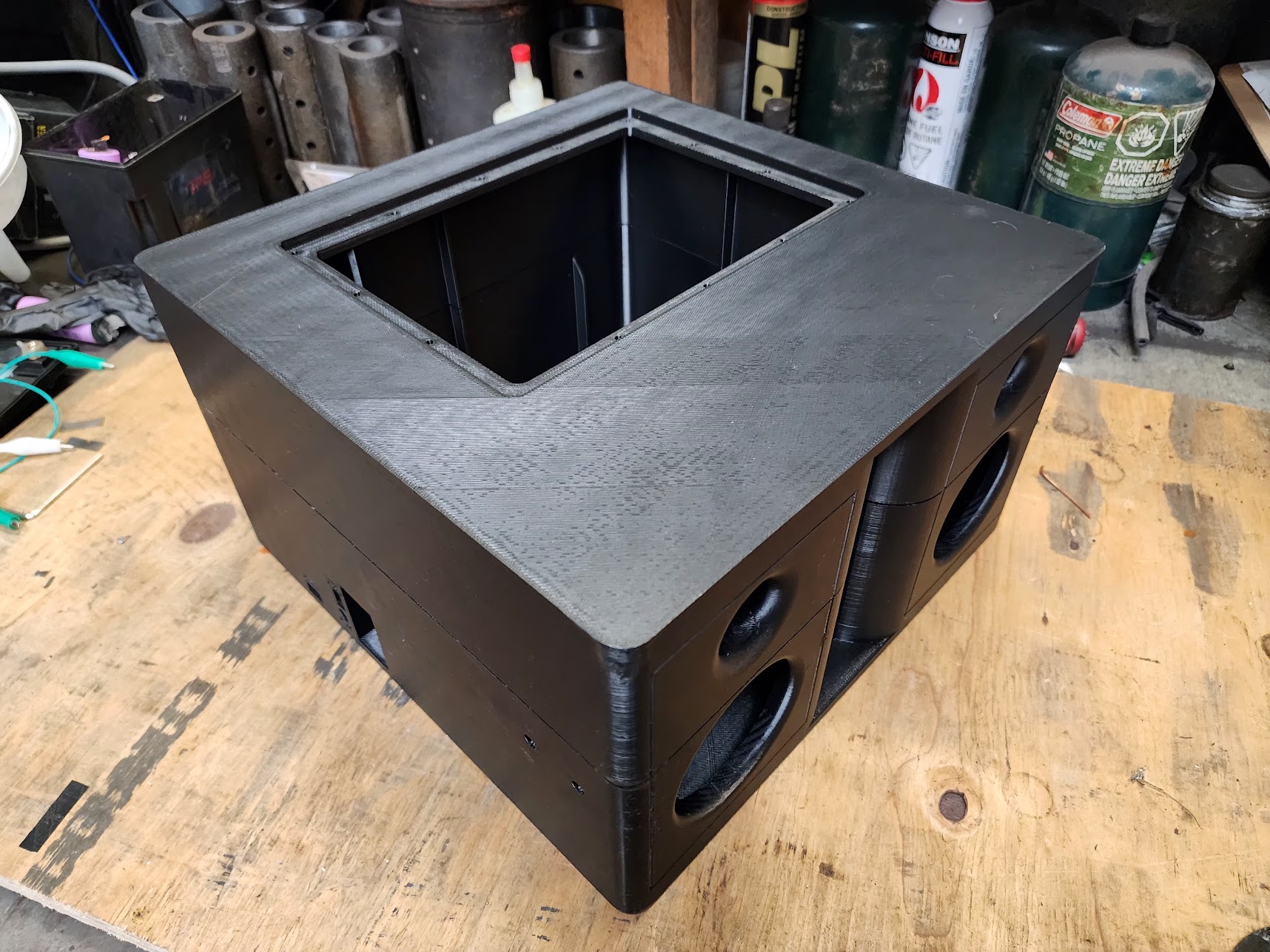

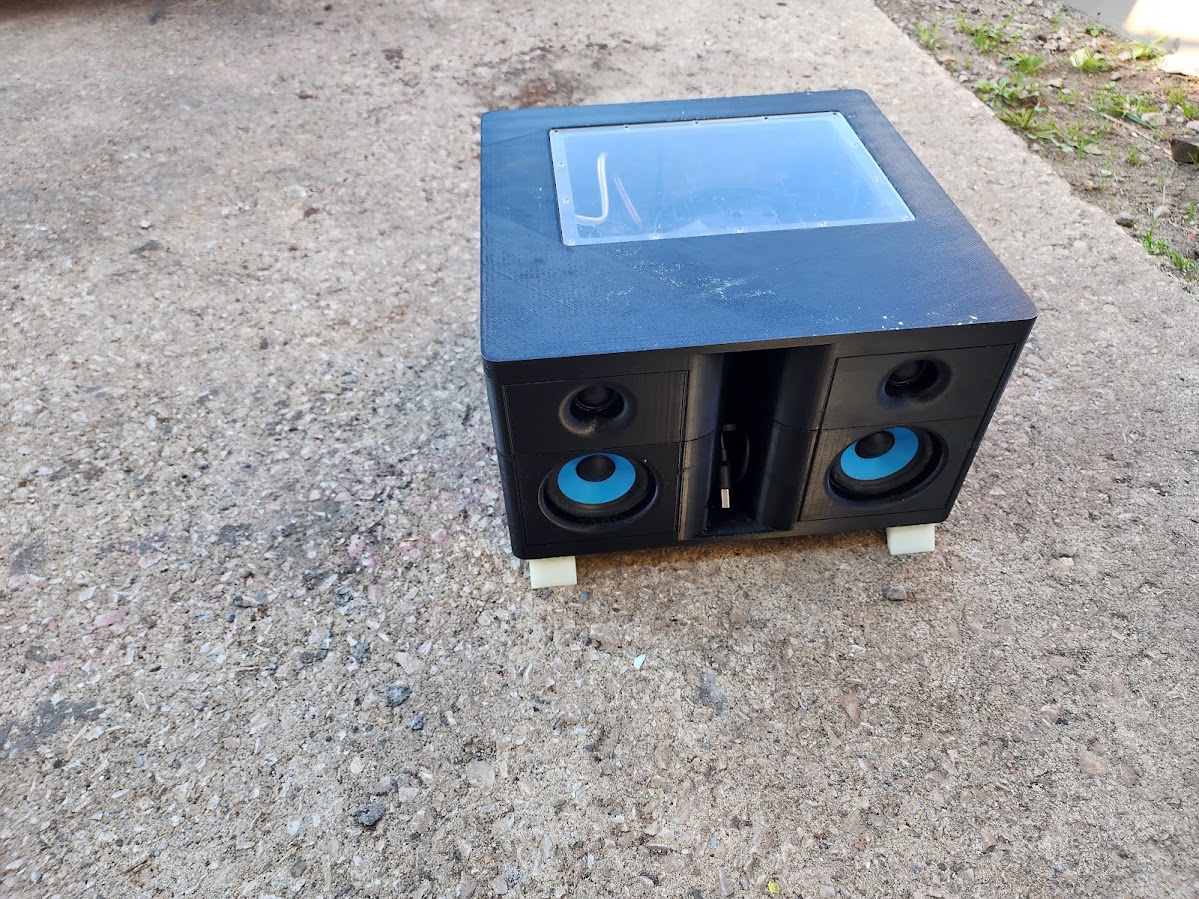

well, life got in the way for a while, and this was a pain to print, but I got it, finally.
Should have it mostly assembled tomorrow, then I need to figure out how to tune the DSP/Amp thing I bought. I got it hooked up on the bench once but the subwoofer seems extremely quiet compared to the mids/highs, it was clearly not getting the same amount of output, but I'm sure there's just a setting in the software somewhere to fix that.

Ah, okay. That means it loses 6dB by no ground coupling and another ~4dB by not having a baffle step support (which is not realistic by such a type of speaker anyway). The spl of the sub is 83dB according to the data sheet.
83dB-6dB-4dB=73dB.
Your drivers for mid and high have (let's assume) 85dB. They are two each and each got their own power, so for the combined spl it's 85+3dB(doubling membrane surface)+3dB(doubling the power, as each side got its own power).
85+3+3dB=91dB!
So your sub is almost 20dB quieter than the other speakers. That means, your sub needs nearly about 100x the power of your mid-high drivers (well, give or take, just a very rough estimate).

In open air, that's how things go. Even with walls or even edges adding to the level, it's still 7dB lower.
My first design of an outdoor boom box also had similar from the ground spacing and seemed relatively balanced, output wise. If I cranked the output on the subwoofer of that the sub would easily overpower the mid/high drivers.
At your first design, the sub had over 90dB spl? I don't remember but I had in mind you had at least double the power for it than for the mid-high. Aside from that, the ventilation on the sub driver is blocked by your enclosure, that robs you of a few dB and leads to very early compression too.
Reactions: Aendn
Well, you were right - it was mostly the open air thing. As soon as I put it into the enclosure it woke right up. I had never tested the other one in open air, I thought you just meant with the spacing from the ground it was the problem.
Amazing how much of a difference the enclosure makes.
Now I need to figure out how to tune the DSP since it doesn't sound right, but it does sound "good enough" to prove the concept.
