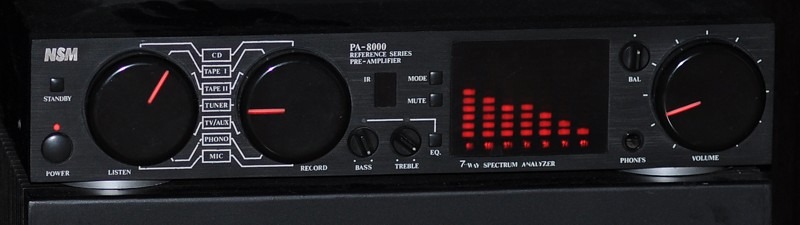

At the same time, I know a lot of amplifiers with separate input switch for record output. Its main idea is to be able to listen to one source, and record from another. I also made such a switch in an preamplifier about 30 years ago.

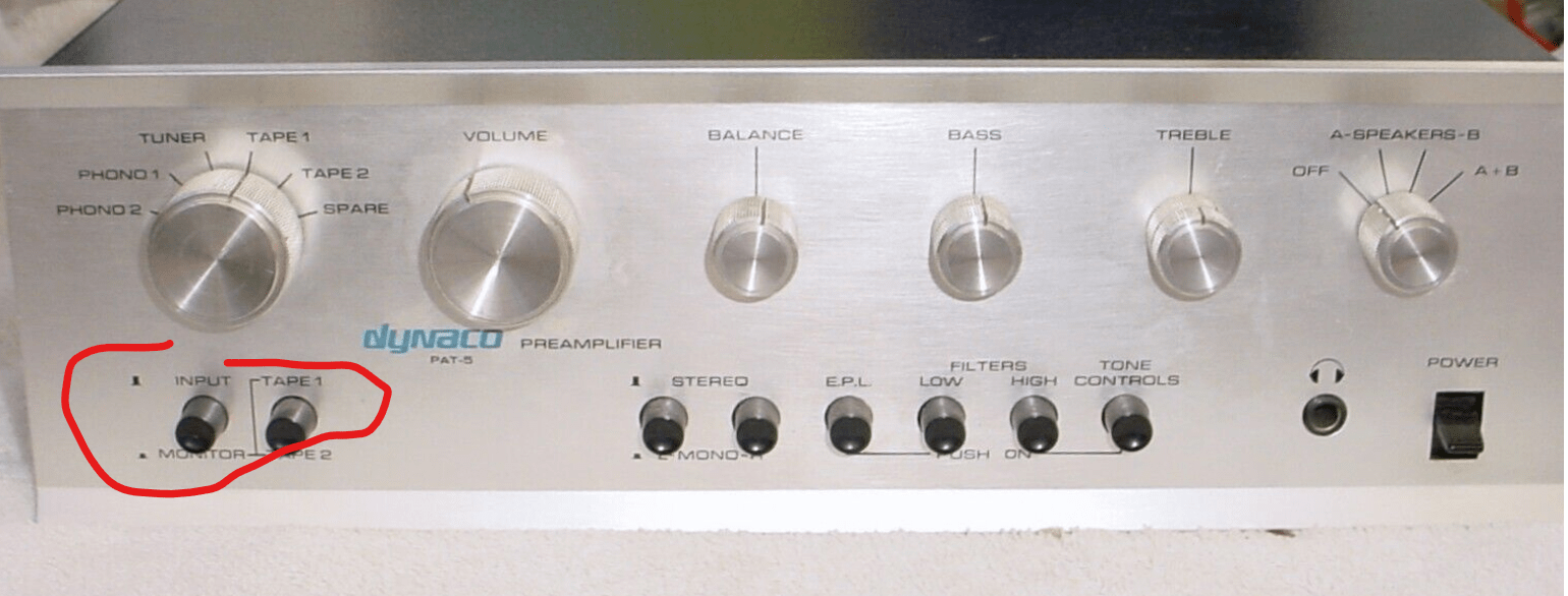

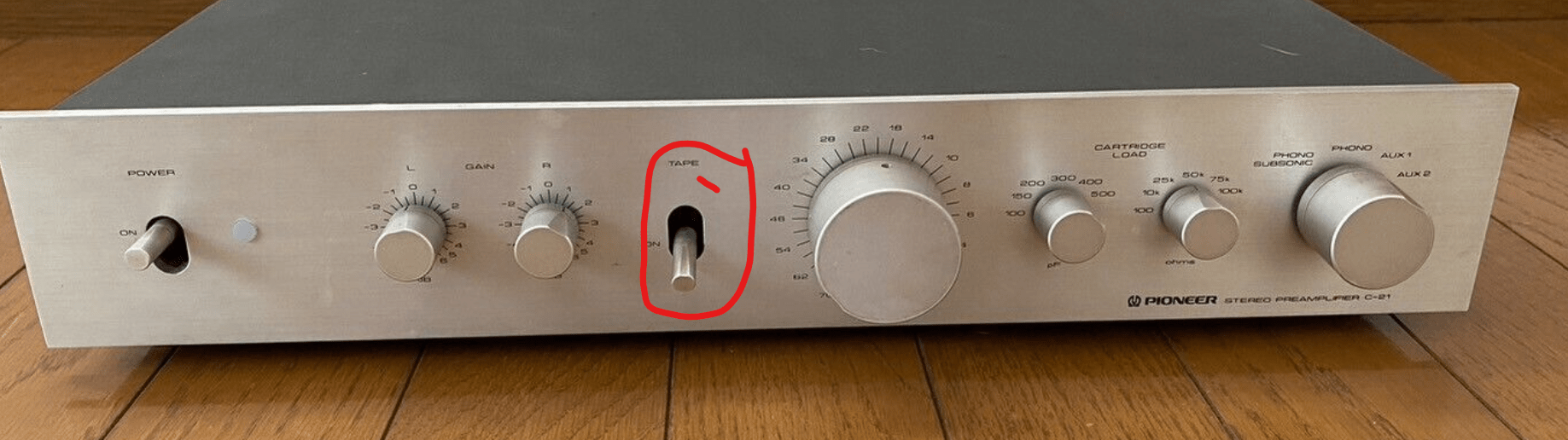

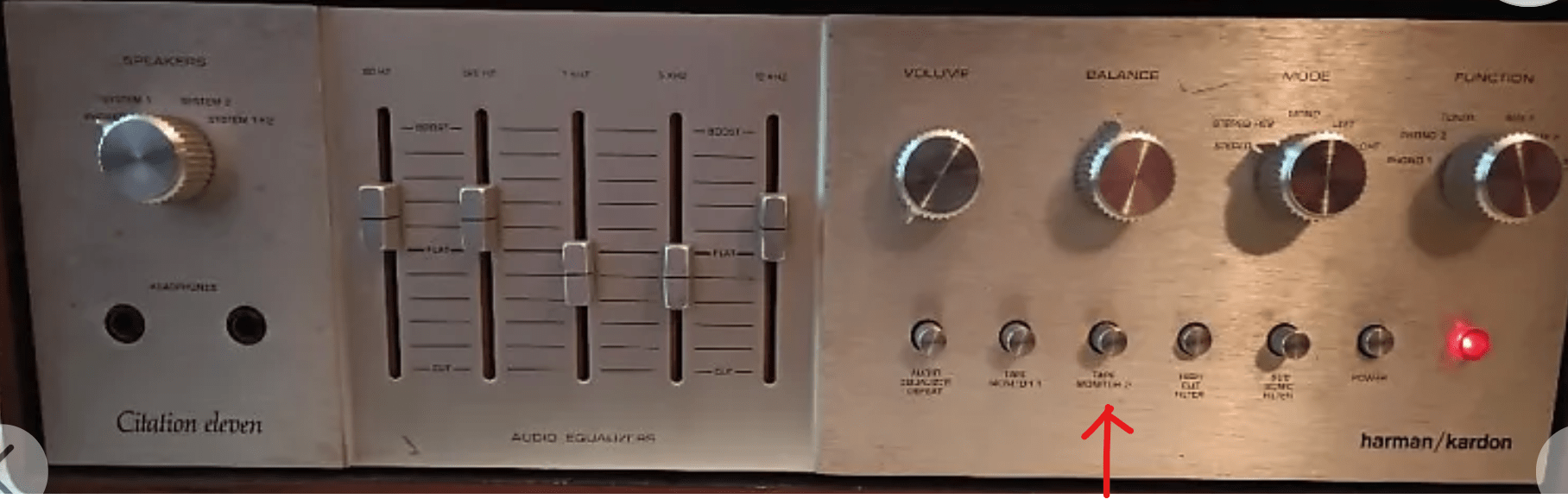

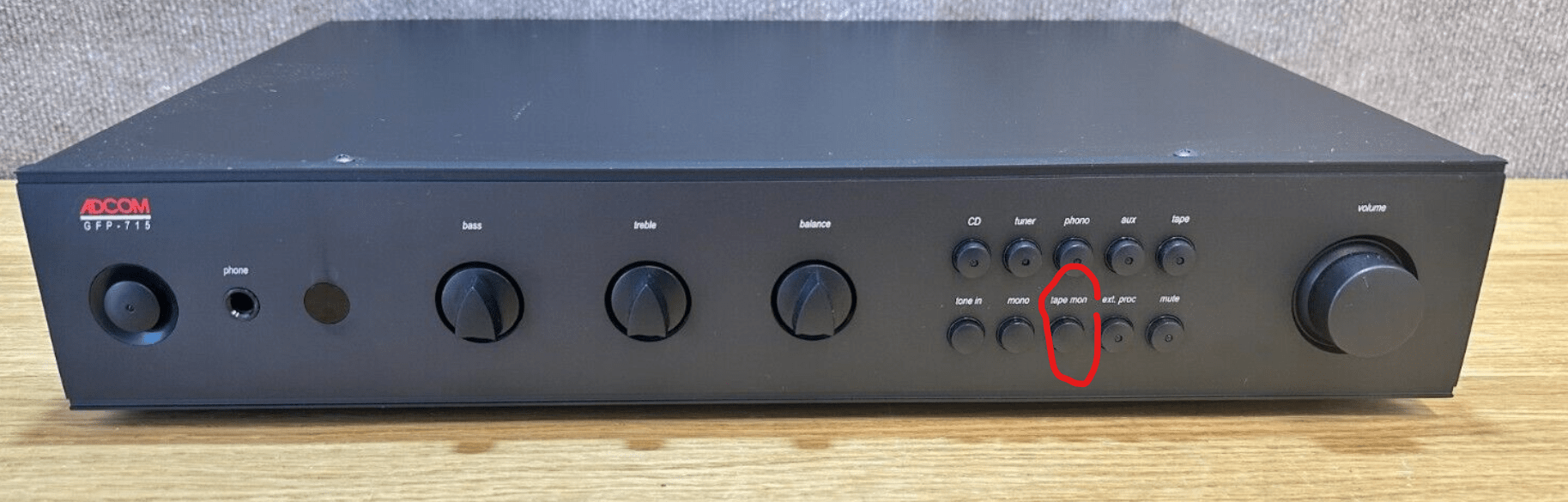

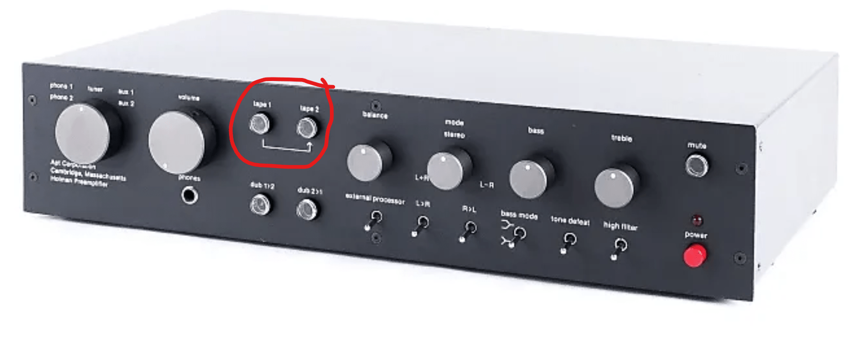

Pre-amps specifically with tape monitor switches, these are just a very few examples and there are many more. Most Japanese and American made receivers and amplifiers also had tape monitor switches.
Some models like the Yamaha C-2A had dedicated record source selector switches and no tape monitor switch. (There are others, but not nearly as common)
Below, just a few that I know about.
HK Citation 11
Dynaco PAT-5 (and PAT 4)

Pioneer C-21
Adcom GFP 715
APT HOLMAN
This one includes dubbing options as well, but select either tape 1 or tape 2 (IIRC tape 1 must selected to play tape 1 or 2) and that tape recorder playback overrides the source selection switch.

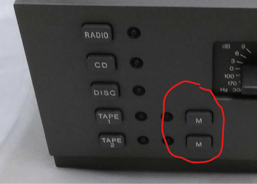

Thank you. I have never seen such amplifiers before. And yet I do not agree that the monitor button is in most amplifiers.
I think it is time to give it a rest you are just wrong. Sorry. Back in the pre-digital days literally every single serious solid state and many tube pre-amplifiers had the tape monitor switch or a tape source switch. It is a feature of limited usefulness today since very few people own 5 tape decks like I do. (All 3 head with off tape monitoring.) Let's agree to move on, OK?
This is correct if you use the SOURCE-TAPE switch on the tape deck. Then the source signal goes through the recording level regulator. But if you use the MONITOR button on the amplifier, the source signal will not pass through the recording level regulator, the volume difference will be.
