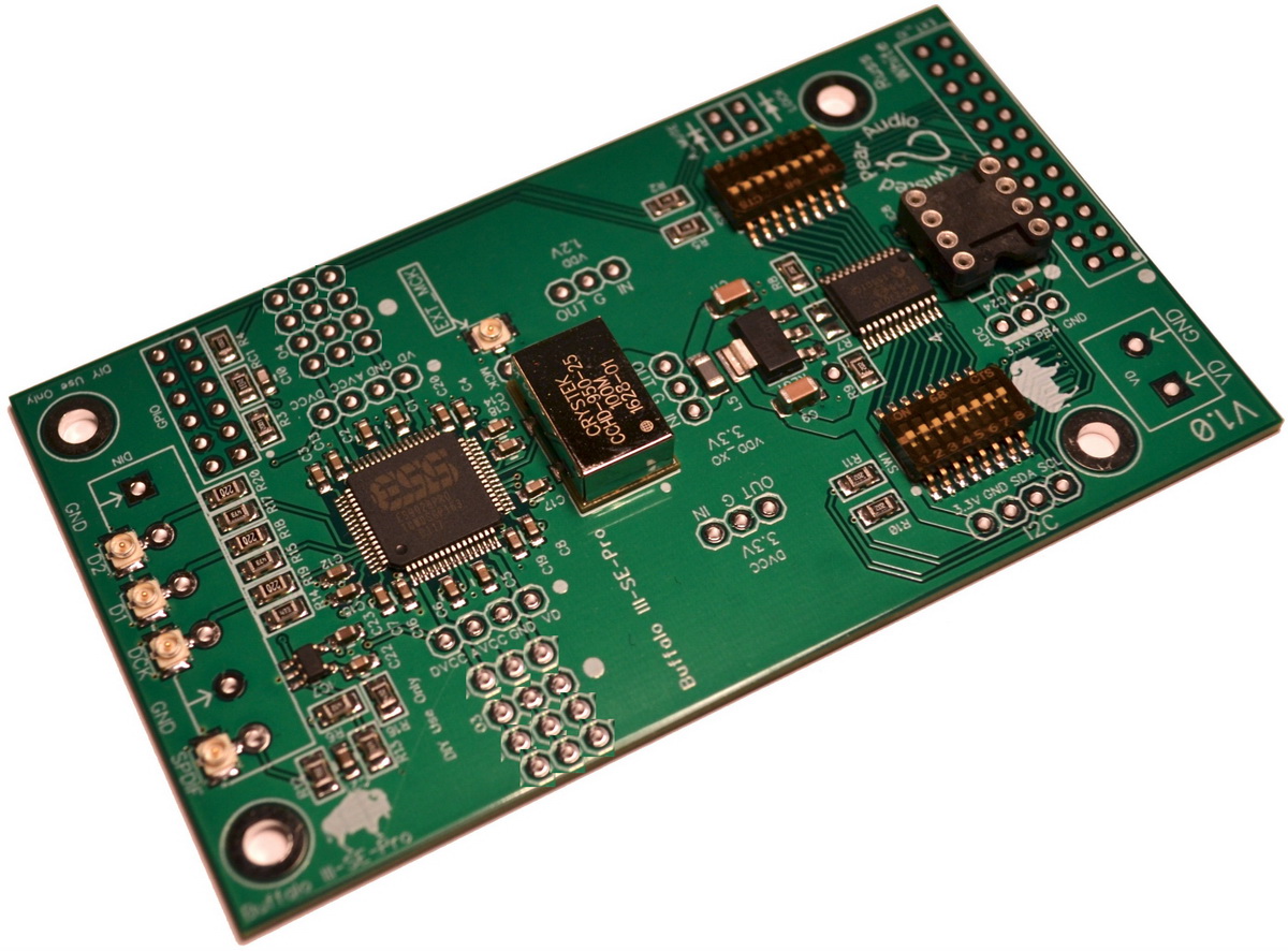

1 - What actual multi-channel source are you planning to use? I2S from TI DSP board (4 way active crossover) @192kHz at least
2 - Will PCM/DSD input be sufficient? Note anything else will likely require some sort of separate input module(s) - so be specific. Only raw I2S/DSD lines as on current BIII
Output:
1 - What are your ideas around the physical layout and casing? same format as current BIII, no casing, no XLR connectors, etc.
2 - Do you prefer individual output boards or a monolithic 8 channel board? Separate 2ch boards
3 - Do you value absolute fidelity(floating - mercury type front end) or lower cost (gnd reffed IVY type front end)? Absolute fidelity
4 - Are you likely to need SE outputs? No. Would like to see smaller output boards without SE.
Control:
1 - How do you anticipate controlling the DAC? external controller via I2C, no config jumpers needed
2 - Is on-board control important to you? no
Regulators:
1 - do you prefer a tight local PCB layout with on-board regs - or would you rather have the flexibility of Trident/AVCC style regulators? flexibility/upgradeability
Output:
Control:
Regulators:

My acyual setup is six channel dac for three way speaker. We have three Buffalo with IVY. Dac chips controled by modified Hifiduino code, to provide general volume and balance between ways. Crossover is on computer with Dephonica sofware (sound better than Mini Shark solutions)
Input:
1 - What actual multi-channel source are you planning to use? DIYinHK multichannel USB card
2 - Will PCM/DSD input be sufficient? Yes. Adaptors for multichannel sources like MiniSark or DIYinHK Xmos card are welcome
Output:
2 - Do you prefer individual output boards or a monolithic 8 channel board? Monolitic whit onboard output connectors
3 - Do you value absolute fidelity(floating - mercury type front end) or lower cost (gnd reffed IVY type front end)? Mercury
4 - Are you likely to need SE outputs? Both

Input:
1 - What actual multi-channel source are you planning to use? PC - would like the choice of USB, HDMI, and LAN inputs. 384 kHz would be nice, but not necessary. For me, it is more for future proofing.
2 - Will PCM/DSD input be sufficient? Perfect
I like the isolation concept You created with the BBB and Cronus boards - so if You can figure a layout with this concept in mind...
Output:
1 - What are your ideas around the physical layout and casing? I like to pick/build my own case work. Ideally sized around Standard 2U chassis.
2 - Do you prefer individual output boards or a monolithic 8 channel board? I like your idea of individual boards, esp if there are different types available (like with Mercury, IVY and Legato) Also, to keep the cost down, maybe You could offer single ended OR balanced iterations of each type. However, if it works better to have a monolithic 8 channel board for board layout in terms of absolute fidelity and cost, then monolithic board.
3 - Do you value absolute fidelity (floating ground - mercury type front end) or lower cost (gnd reffed IVY type front end)? Absolute fidelity for sure.
4 - Are you likely to need SE outputs? Yes, actually I have both balanced and Single ended amps, it would be nice to have the choice to use them all.
Control:
1 - How do you anticipate controlling the DAC? In terms of the audio signal, volume and DSP, I plan on doing those with-in the software in my PC (JRiver). But for the control of the DAC chip itself - software with-in a PC would be cool, but maybe too costly or complicated to implement given different OS everyone has. I would be fine with the DIP switches like used in the earlier designs.
2 - Is on-board control important to you? Not necessarily, as long as I can control it another way via PC (windows) or smartphone app.
Note: This is a crucial topic.
Regulators:
1 - do you prefer a tight local PCB layout with on-board regs - or would you rather have the flexibility of Trident/AVCC style regulators? Which ever produces the better fidelity. I am sure this is subjective, but I am willing to have faith in what ever You feel will lead to the best fidelity. So if the Tridents work best for the Pro38, then that is what I want. 😉
Master Clock:
1 - do you prefer the optimal layout, performance, simplicity and reliability of a local best in class on-board master clock - or the flexibility and added complexity/cost of external clock sources or Rhea modules?Best in class on-board master clock. So if that meant mounted Rhea modules directly on-board, why not? 🙂
As this is being designed as a multi-channel DAC, and one Pro38 chip is being used, it's potential needs to be maximized. So to do that:
Are the Tridents the best regs? Or can this be done with tight local regs and a better PSU up front? Which of these two options is the most cost and/or labor effective, or does it come out in a wash? 🙂
With the master clock, does having an external option complicate the board layout enough to compromise power or signal considerations of the board?
Another option here with the clock would be a multi-channel Cronus option that one could purchase separately and plug into the I2s of the DAC board and have a way to by-pass the on-board clock. Would that be possible?
As I mentioned above, I like the idea of being able to pick and choose different output stages, and even possibly having dedicated single ended and balanced output options. Then everyone could buy what ever output stages suit their budgets and input requirements for their amps. However, I do not know if this is the best option in terms of your production and labor costs. Also, what would work better, again, regarding board layout of the DAC itself, to have individual output sections or one monolithic section containing both single-ended and balanced outputs? Which one is more cost effective, small customized boards or do it all monolithic boards? I could see having different types of the monolithic boards in-terms of IVY vs Mercury as well.
Also, I thought with the inputs, if there was an ADAT toslink option, that might be appalling to the Professional music market, although this might be better as a separate input board.
Sorry Russ and Brain for all the questions, but I think the answers would help others see what You are up against in terms of balancing cost and fidelity.
