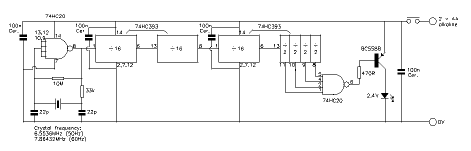

I'll probably just go belt drive. Do you think that would work for controlling the motor speed? Or might it cause problems? I'd probably try and use a DC motor as I suppose they are less noisy then AC. But I think it could work decently. The fine tuning should be able to get it pretty dead on speed wise. Are there like special strobe you use for tuning the turntable speed?
Dougie085 said:Is there a special strobe you use for tuning the turntable speed?
Yes. Use a red high brightness LED.
Read the Teres White paper for a really interesting view of the pros and cons relating to DC and AC motors. If I were you I would build the strobe EC8010 has posted - I use a similiar strobe.
