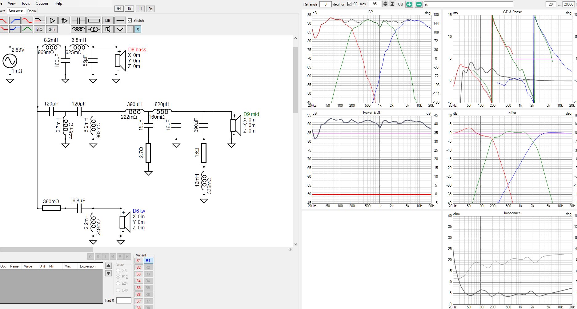

Hi @AlfonsDenmark - there are many more capable here than myself, but I still wanted to give you a take on a simulation - perhaps it can give you some ideas. I don't have XSim so here is the schematic.
Notes:
It's LR4 acoustic with XO at 200hz and 2400hz, SPL at 92db!
The RLC on the mid can probably be omitted, but I included it so you can see what it does.
I tried LR2 on the bass but there is a hump between 50-100hz that can't be flattened without a humungous RLC which also then causes a dip around 100hz right before the filter starts working, so I gave up on that.
I found that LR4 @ 92db levels this all out such that the hump + filter together match quite closely to the textbook curve from 50hz.
I also tried to ensure the filters track the target curves to -50db down from reference level; maybe that is unnecessary. It is easier to do that with LR4, though.
Looked at distortion measurements for the mid on hificompass and saw 200hz is quite OK for this driver. Maybe 300hz would be good, too.
Hificompass also recommended taking it up to 2.4khz, so I did that, which also gives more comfort to the ribbon.
The mid has a little response dip around 1k from the original measurements. Don't think much can be done about that, or if it's a big deal.
As the 92db level is so high, I wondered about attenuation and as you can see there is none on the mid (which should be a good thing) and a tiny amount on the tweeter, but both mid and tweeter can handle this in theory. Perhaps the system db should be set for 91db or such, and give you more adjustment options to balance the sound in the room.
Sim shows nice phase alignment with your provided measurements and this network, and impedance is healthy.

Be careful with complicated networks, especially when there is unknowns regarding measurements. Drive units offsets (x,y,z)?
You won't need 2.2mH in tweeter circuit. Use older B&W service manuals as a starting point for a x/o network.
Unluckilly the datasheets in Vituix can not say the real sensivity of the drivers. For illustration this Audiotechnology is a 88 dB/2.83V in real life. But that is not hard to adapt in the XO with resistors...It makes just a little harder to choose the bass unit to match the mid unit at baffle step.
Yeah. I want to, as far as possible, to keep the parts as few as possible. Especially for mid and tweeter. I might be buying the Hypex FA501 for each sub, to have active crossover.Be careful with complicated networks, especially when there is unknowns regarding measurements. Drive units offsets (x,y,z)?
Yeah, i might cross bass active, to adjust it to the room etc.Unluckilly the datasheets in Vituix can not say the real sensivity of the drivers. For illustration this Audiotechnology is a 88 dB/2.83V in real life. But that is not hard to adapt in the XO with resistors...It makes just a little harder to choose the bass unit to match the mid unit at baffle step.
