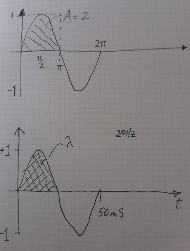

Once you've answered this initial question you can move on to calculate the Volt-seconds for your design. This is a crucial parameter in the design, the more V-s the more turns of wire you have to put on, given a particular physical size of trafo.
I've made a sketch of how to calculate the V-s parameter given your answer to the first question. The top squiggly line is my attempt at a sinewave with a geometrical horizontal axis, the lower one is what you might see on a scope with time as the X-axis. I'm showing the first one because we typically use calculus to determine the area under a curve, the area calculation is what's need to determine V-s, shown as the Greek letter 'lambda'. The lower wave shows a time axis - with 20Hz the whole cycle takes 50mS, for an amplitude of 1V peak, the V-s in the hatched area comes out to be 0.0159.
I got this result by using the area calculation from calculus which says the area under the sine is 2/Pi times the horizontal dimension (25mS in this case).

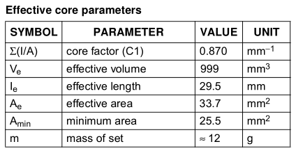

Step 3 - choose your transformer core and extract its Amin value.
Here I'm dealing with the EP17 core, its Amin is shown in the table as 25.5mm^2. Convert this to cm^2 by dividing it by 100, hence we have 0.255 cm^2.
There may be some iteration involved here if you're new to the game and have no feel for what core sizes will work given certain requirements. For example if you're pushing your luck and want the ultimate smallest size you may find when you get to work out what diameter wire you need its unavailable from the normal sources due to being too small to handle without breaking.
The EP17 isn't really optimized here because if you look at the table, the Amin is quite a bit smaller than the Ae. This is telling us the magnetic path isn't a constant cross-section meaning the narrow part is the weak link in the chain. Ideally Amin would be almost identical to Ae.

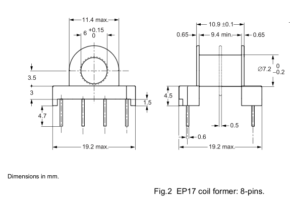

Step 5 - figure out what size of wire is needed for the primary
We choose the wire size to make the best use of the available space on our bobbin, called 'the winding window'. I've clipped the part of the data for the bobbin - I find that its best to check the mechanical data very thoroughly to determine the size of the 'winding window' - oftentimes if this value is given, its in error, so going back to first principles is what I do.
From the diagram the important dimensions are the inner diameter, the outer diameter and the height. Subtract the inner from the outer and divide by 2. Multiply the result by the height, this gives us the area of our winding window. For the EP17 the relevant numbers are 11.4, 7.2 and 9.4. I get 19.74mm^2.
Next, apportion this area between our two windings, primary and secondary. Since the primary will be on the inside it'll have shorter turns, meaning lower resistance -if I'm building an output transformer (for headphones) I'll give it 40% of the available area. But with a signal transformer, as here, optimizing the losses between primary and secondary windings is far less crucial. Sometimes the fact that wire isn't available in every possible diameter means its best to reverse the order and put the secondary on first, it can make better use of the available space. Or I may well give the primary more space simply because it has more turns and thinner wire isn't available (or is too likely to break) to fit it into just 40% of the space.
However I'll work this example through aiming to optimize the resistances between the two windings and go for a primary which only occupies 40% of the space. 0.4*19.74 gives 7.9mm^2. To fit 2500 turns into this area means each turn takes up 3.2*10^-3 mm^2. Take the square root of this number to get the external diameter - 0.056mm. Gulp! This is very thin wire and not widely available - note the gauge of wire is thinner than the external diameter by twice the insulation thickness.

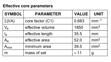

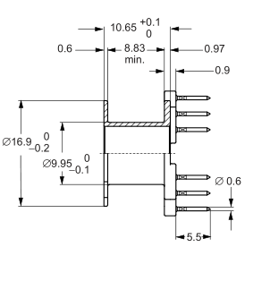

RM8 looks to be a suitable choice, I've attached the vitals for its core and bobbin. Note the Amin of 39.5mm^2 compared to 25.5 for the EP17, the number of turns required scales in direct proportion to the ratio of these two figures. Hence with RM8 we'll need 1600 turns for the primary and 320 for the secondary. The winding window works out to be 30.7mm^2, which for an optimized wind means 0.07mm wire for the primary, but winding with just one wire diameter for convenience means 0.1mm wire works fairly comfortably.
