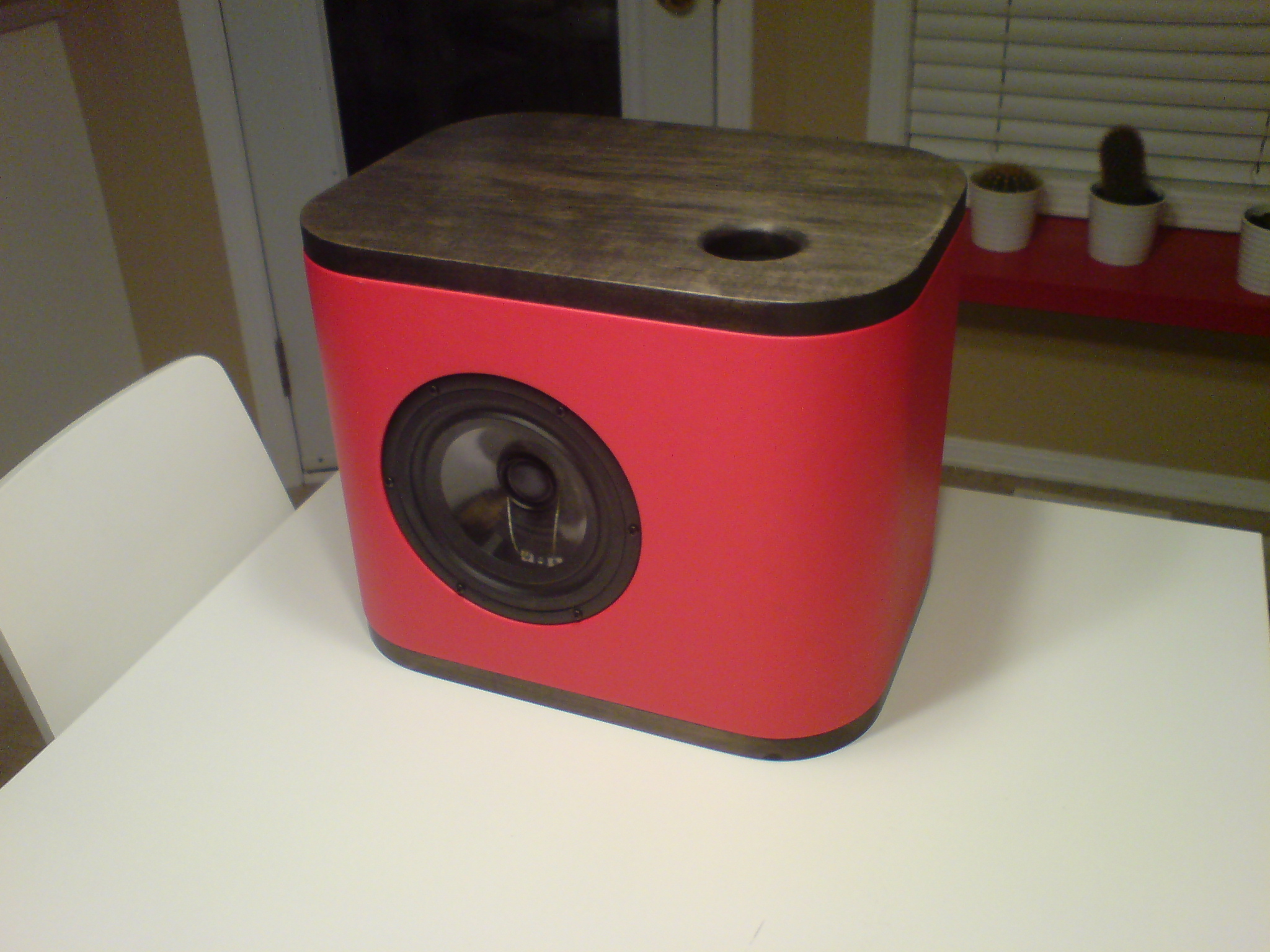

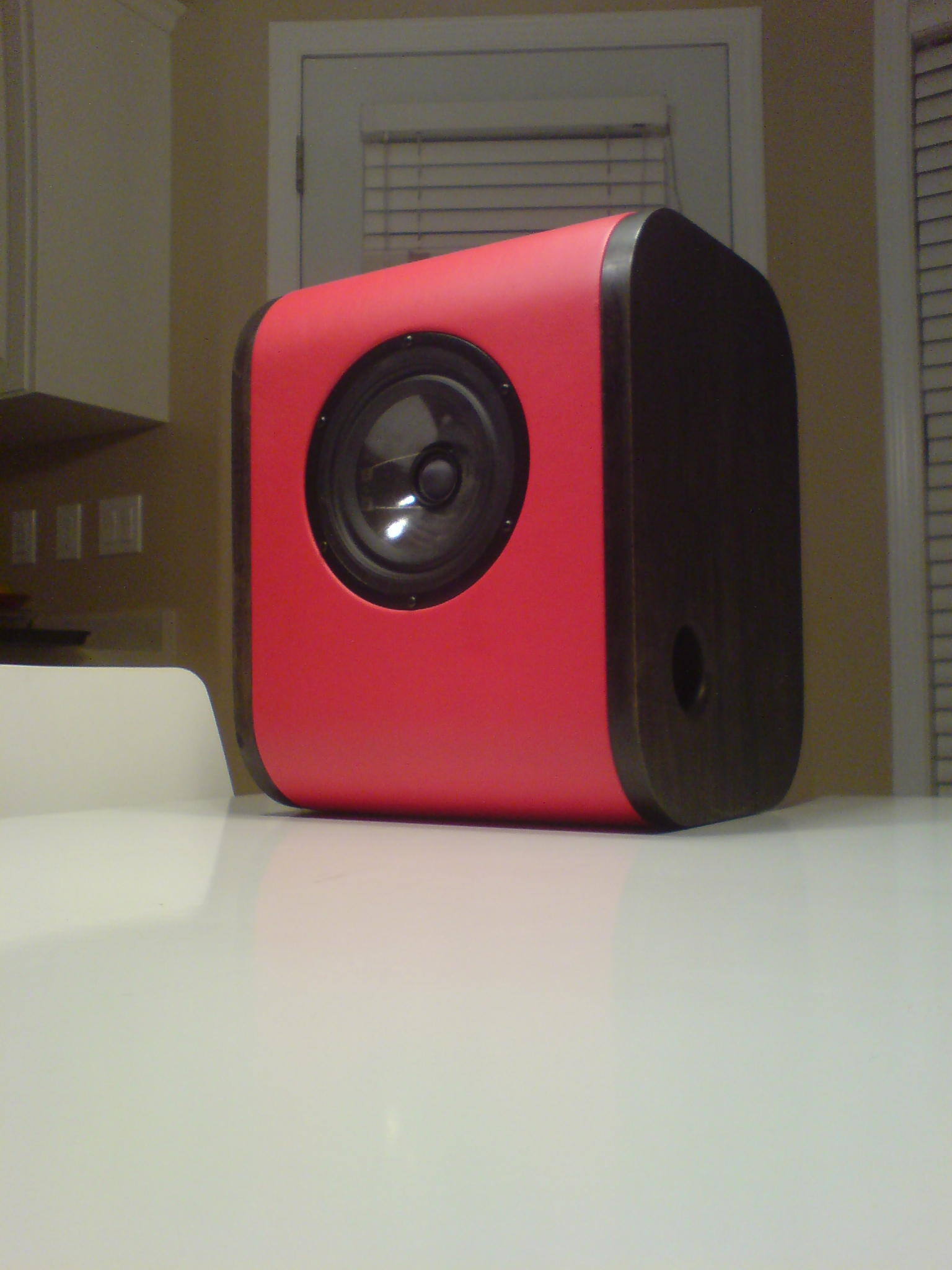

I made a pair of speakers using a Seas coax driver for a local music producer using CNC cut layers. Not very complex but good sounding and visually striking (terrible, old cell phone photos. The colour and dimensional ratios are not how they appear in the flesh. I am too comfortable/lazy to access portfolio photos from this station). The laminations were lined up with half inch diameter register holes filled with half inch brass rods which to add mass and a hefty quality feel. The outside panels are 3/4" ebonized maple. Inside layers are alternating MDF/Baltic birch. Wrapped in a very high quality, buttery soft vinyl (Ultraleather). The vinyl is very, very poppy red (the photos aren't even close).
I have since made a lot of pieces from laminated materials, especially BB. Most of the pieces I have built this way are not audio related though. Of late i have built a cantilever Japanese inspired writing desk, a floating slab vanity and an eight foot workbench all with laminated BB. I like making big slabs from laminations and working them with hand tools using classic tchniques. It sure is hard on tools and my back though. The end result is worth it.
