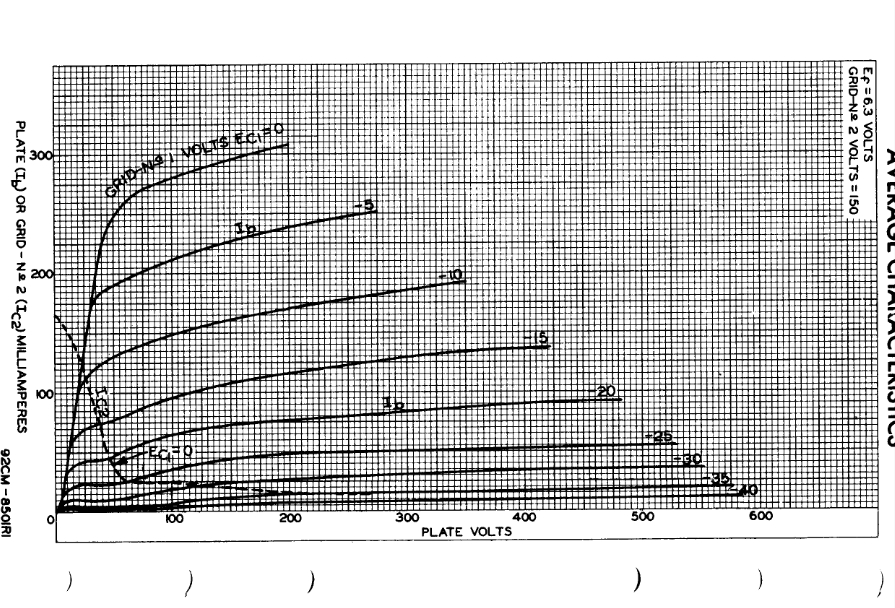

(A) So George, I'm reading through the thread you linked to and noticed in #129 that you were working with 6BQ6 in push-pull, with the best results as follows:
"power supply is 550. Power at 5% distortion is now 73 watts, NO GLOW! Cathode current is 210 mA for both tubes at 73 watts output. This is 110 watts input for 73 watts output or 66% efficiency and 18.5 watts per tube of dissipation at full power."
What simulation software are you using? With both the OP tube screen & the B+ to the driver unbypassed the trace of plate current shewn seems unlikely.🙂
I've never ventured into push-pull, so would those operating points hold for single-ended? They seem excessively high for that.
(B) Following Win's suggestion for 150V screen & 250V plate, attached is a pentode simulation in LTSpice with about 151V on the screen grid, 252V on the plate, and 55mA at idle. With 18V on the cathode that makes 55mA * 234V = 12.87W, a little north of the rated 11W. In the model, a whopping 56K resistor (too much?) is required to drop the B+ voltage to 150V for the screen supply.
Then I tried to model the RCA datasheet suggested configuration for class A1 -- 250Vp, 150Vg2, -22.5V bias. I got close with a 680 ohm cathode resistor, another really big screen resistor (92K), and tweaking some other things (attached). This is about 33mA total for a dissipation of 7.5 watts.
In both cases, the 6SJ7 implements the settings in the 180V Ebb section of the RCA resistor chart for a voltage gain of 55 (this setting worked excellently in my 7C5 experimental amp). Input sensitivity of the simulation is about 0.25V, which is good for being driven by a CD player and comparable sources.
