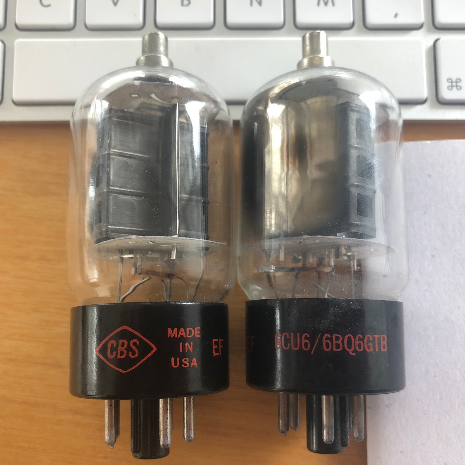

I have a pair of 6CU6 / 6BQ6GTB (and also a pair of 12CU6... and 25CU6...) and would like to try designing a single-ended hi-fi amp for them.

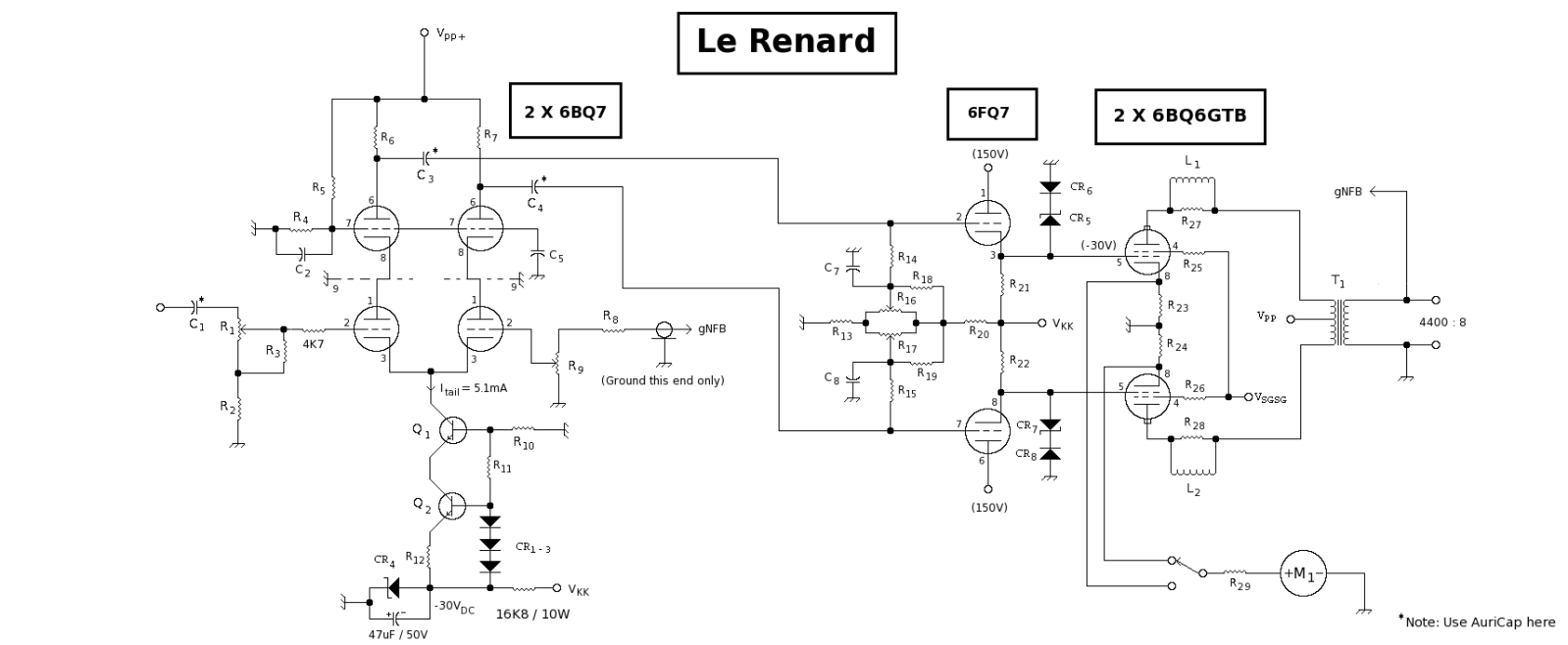

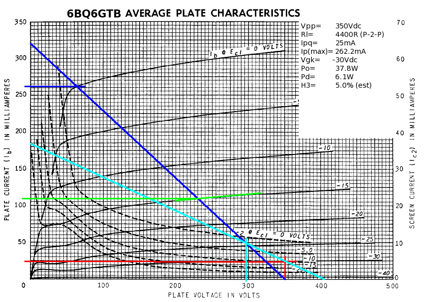

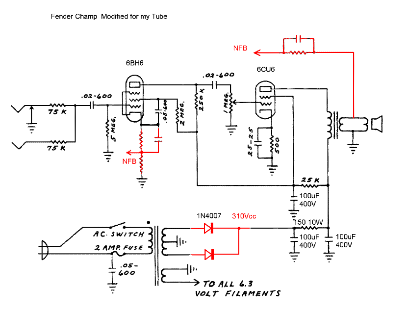

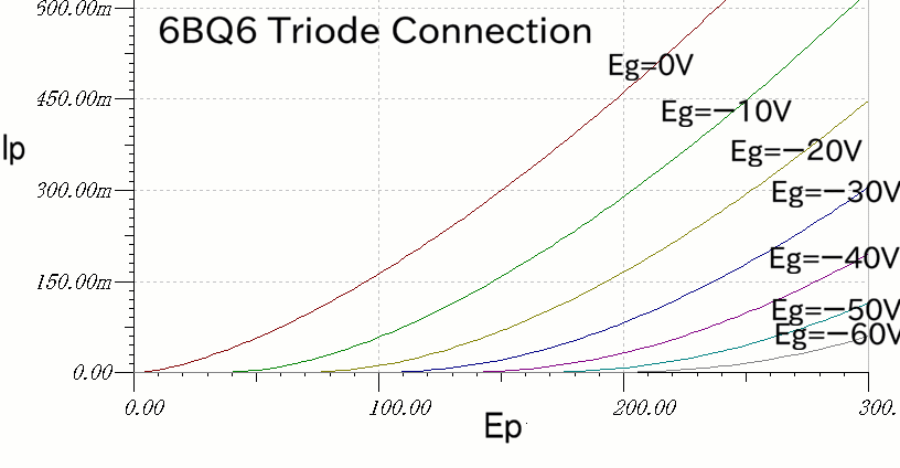

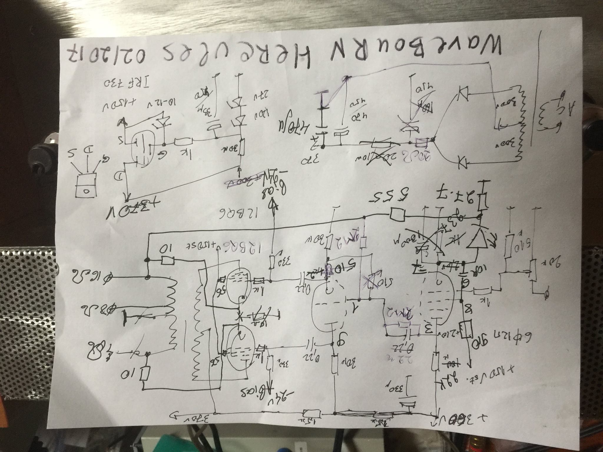

Also attached are computer generated load lines for 6BQ6 in triode mode, a schematic of the Renard P-P amp (I believe Miles Prower's circuit), a 6CU6 version of the Fender Champ guitar amp, and the CBS 6CU6 that are in my stash (I've *really* liked all the CBS tubes I've tried so far, especially 6SJ7).

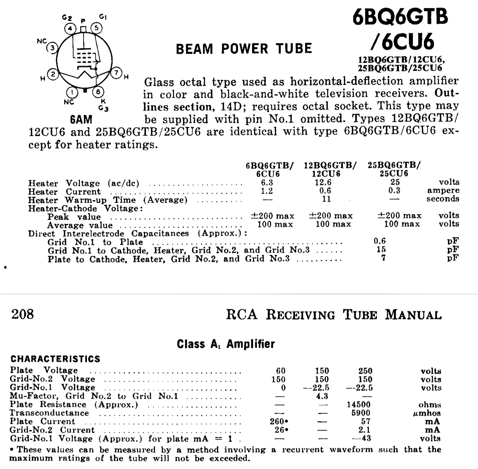

In the datasheets I've not found any common operating conditions for class A1, nor any load line graphs for triode mode, which isn't surprising since these are TV sweep tubes. The Tung-Sol datasheet does give a suggested triode operating condition of:
Eb = Ec2 = 150V and Ec1 = -22.5V
That could be a starting point for triode mode.
I'm trying to figure out what would be a good OPT primary impedance. I've got a pair of 5K:8ohm, 100mA, 15W Electra-Prints. Also a pair of Tektron 3.5K:6ohm & 10ohm, 100mA, 10W. My speakers are 8ohm, so the Tektrons would reflect load impedances of either 2.8K or 4.67K.
The Renard P-P amp uses 4.4K (P-2-P), and the "Eight Tubes" article linked above seems to suggest 2.2K as an OPT primary impedance for SE, which would rhyme with the Renard.
I've also read that that the 11W max dissipation rating can be slightly and safely exceeded for audio use.
So, if anyone has schematics, links, or experiences to share, I'd really appreciate it.

I've used their brother the 6DQ6B in push pull triode. 3K Ra-a, 300V, 60mA. They sound nice and can be run harder than they say.
I've never built an SE amp, but I'd be inclined to try a 1k5 load with 250V and 80-90mA. Since you can't do that by the looks of it, try 300V 60mA into your 2k8 load. Won't have a lot of power, but it'll be very nice. All triode connection.
EDIT: I see now the design was a Fender Champ which implies this is NOT a hifi amp?
This IS a hi-fi amp. I changed the first line in post #1 to reflect that. I posted that guitar schematic as background information for anyone who might want to gain a sense of the field.

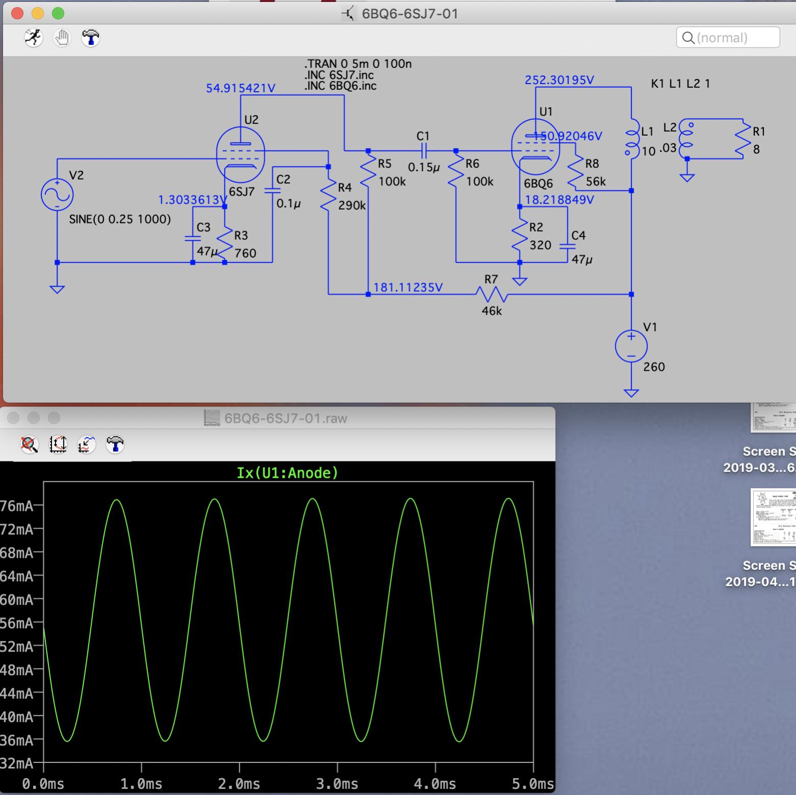

What I have in mind is something more like the attached screenshot of LTSpice, that I just whipped up quickly using the RCA common input tube resistor chart for 6SJ7 to get the voltage, resistor, and capacitor values for a mu of 55. The 6CU6 triode (shown there as 6BQ6T) is running at 200V across the tube at 45mA. I don't know whether that's a good operating condition for 6CU6 in an audio application. In the "Eight Tubes" article linked above, Damon Coffman suggests running the tube at 75mA. Anyway, the circuit appended here has an input sensitivity of about 0.5V, which is a good number for an amp that would be connected to a ~1V source like a CD Player, DAC, phone, etc.
I love 6SJ7 in a few circuits I've breadboarded, and figured I'd start with that as input tube. I also have on hand 6SC7, 6SQ7, and 6AC7.

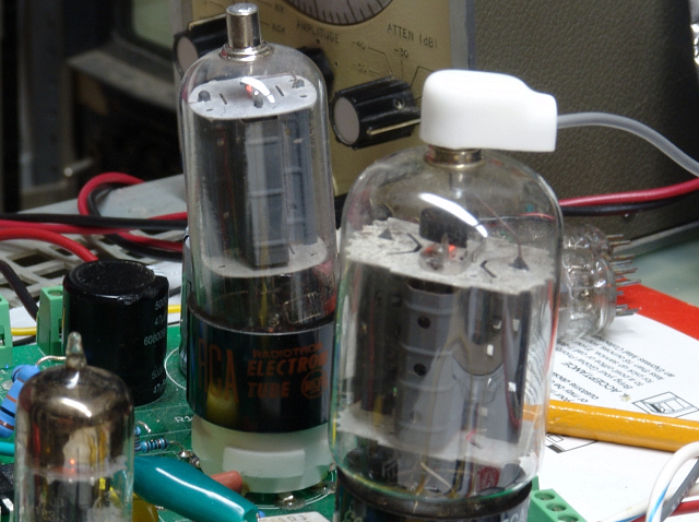

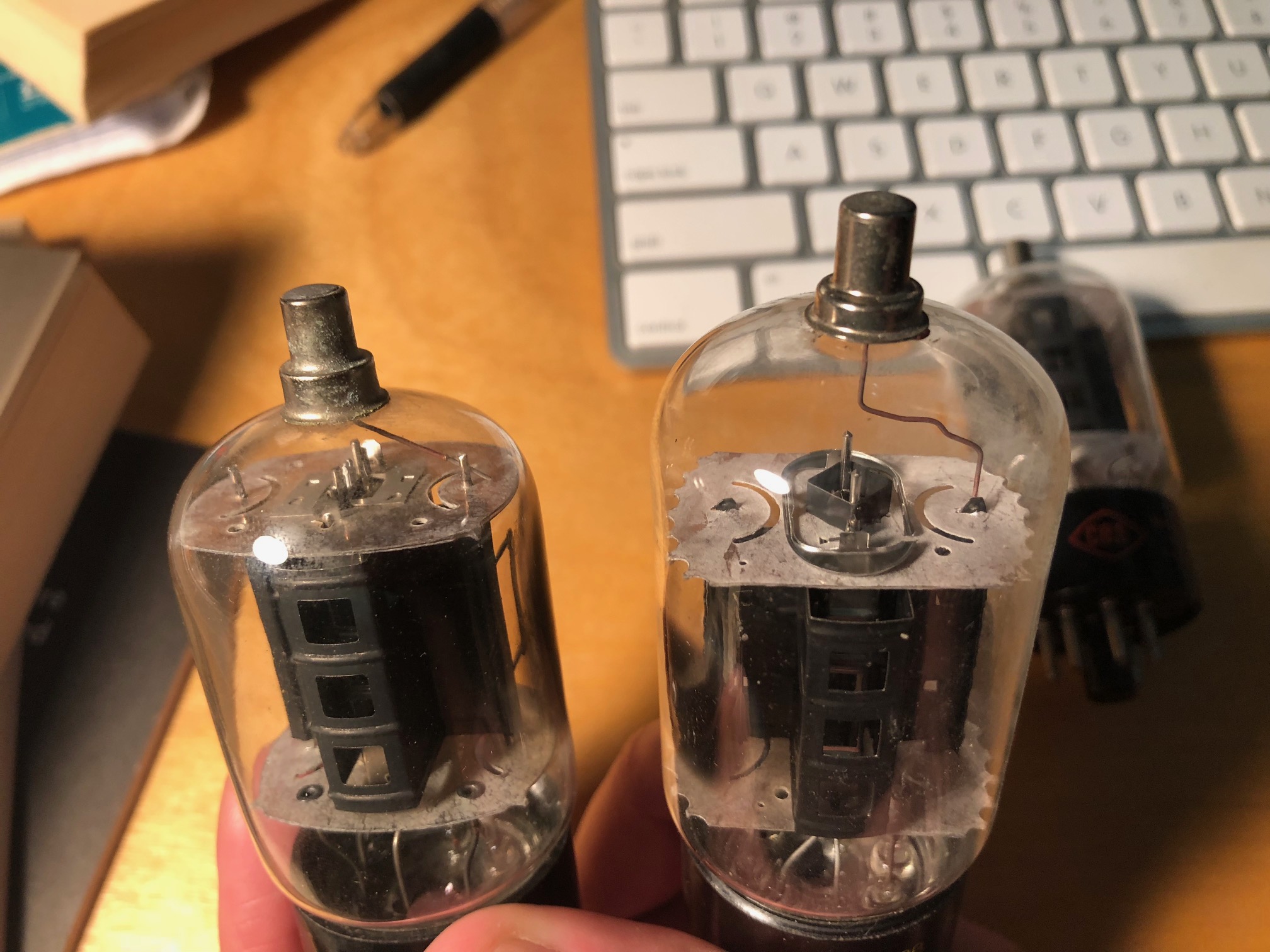

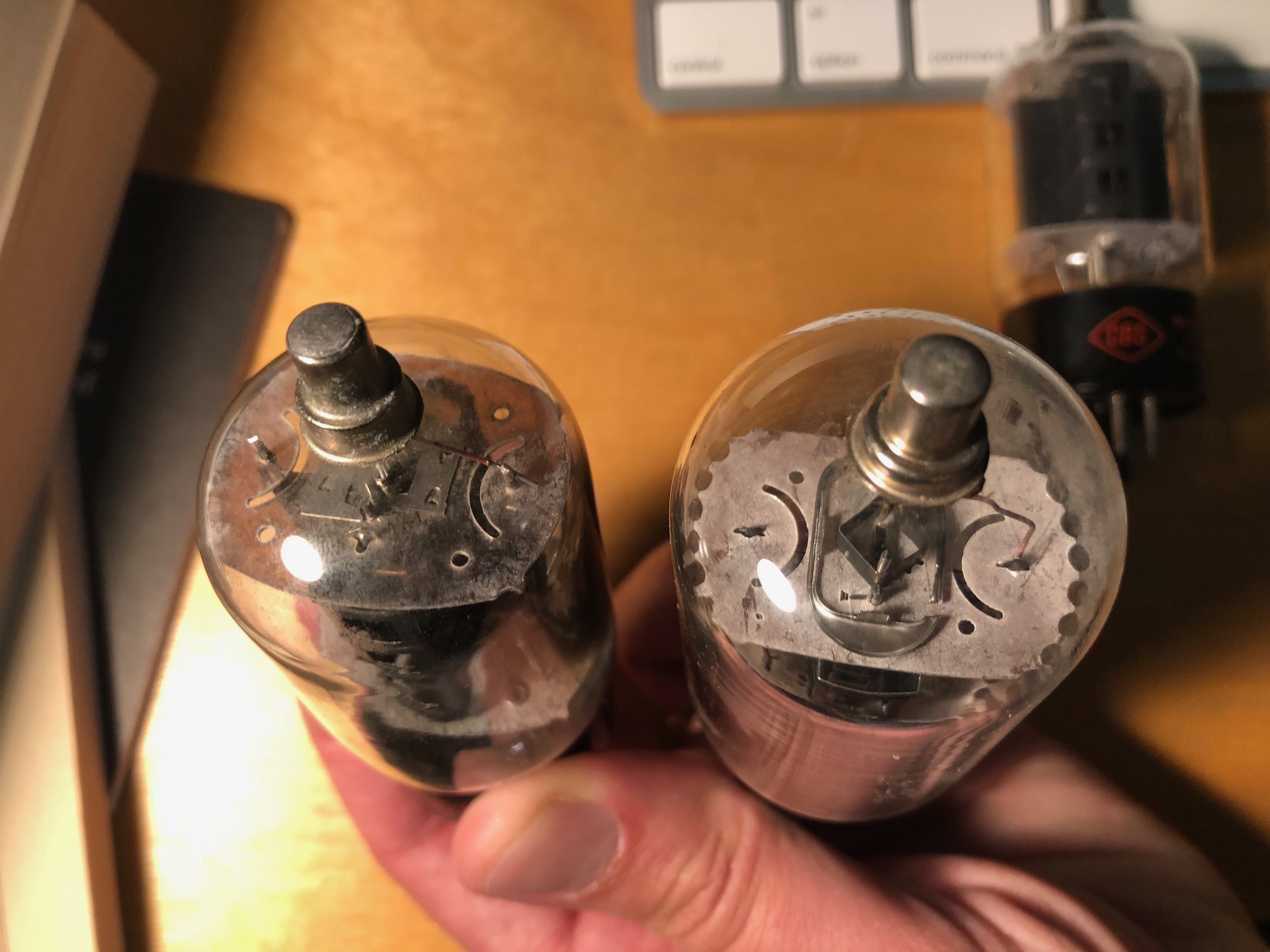

6BQ6 / 6CU6 are all over the place in construction. Markings notwithstanding, those tubes in your picture clearly look to be RCA 6GW6/ 6DQ6.
As many here know I started my vacuum tube journey in the early 60's with parts from trash. You don't find too many 6L6GC's in the trash, but 6BQ6's and 6DQ6's were very common, so many of my early experiments used them.
The 6BQ6 comes in two distinct flavors, as does its cousin the 6AV5. The 6BQ6GT and 6AV5GT are small bottle tubes the same diameter as a 6V6GT. It has an 11 watt plate dissipation rating. As TV sets got bigger, more power was needed, so the 6BQ6GA and 6AV5GA were born. Here the guts from a 6BQ6GT were stuffed into the bigger plate from a 6DQ6 and put into a fatter glass envelope.
This led to some confusion especially since there were TWO different tubes called the 6BQ6GTB. GE used that number for a skinny version with an unknown improvement, while RCA put that number on its fat bottled tube. This led to some confusion and some melted tubes, so new numbers were generated. The 6CU6 is the fat bottled version of the 6BQ6, and the 6FW5 is the fat bottled version of the 6AV5. All "GA" variants of the 6BQ6 and 6AV5 should be fat bottles with 6DQ6 plates inside, but I have seen some oddballs possibly created by a rebrander.
The 6BQ6 types and the 6DQ6's are two very different tubes. As a kid trying to make loud guitar amps I didn't understand why the big tubes (6DQ6) were not as loud and the little tubes (6BQ6GT), and often glowed red. I would not understand things like bias, impedance and load lines until a few years later.

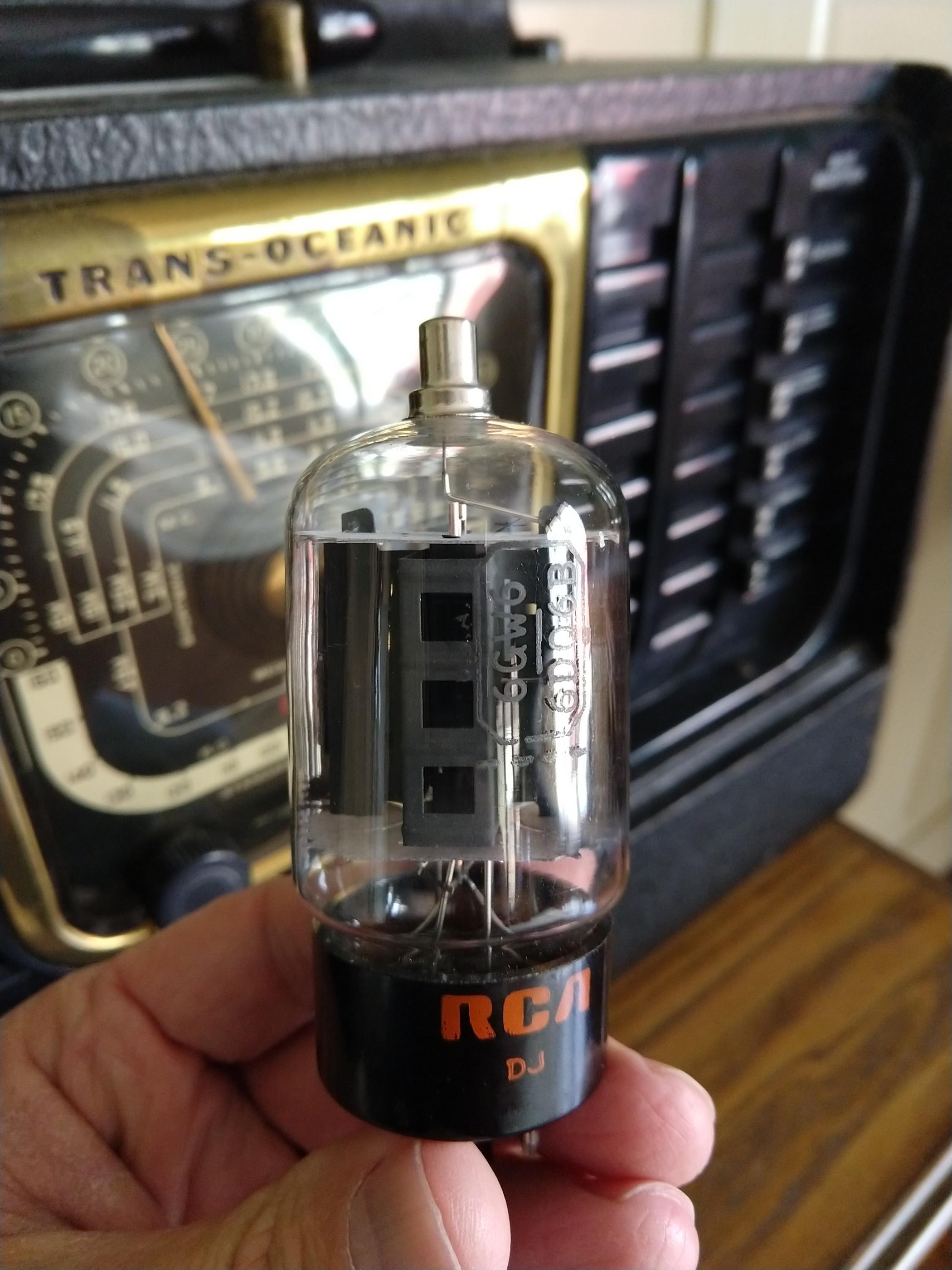

I'm sure that those tubes are indeed 6BQ6GA's made by RCA. I have a big box full of tubes just like them, although none are CBS branded. RCA, GE and Sylvania all made the 6BQ6GA/6CU6 and put anyone's name on them. Most of mine are Dumont, Arcturus, and Emerson branded.
From outside the glass, they all look just like 6DQ6's since the plates are the same. The guts inside are different, and the 6DQ6 will require MUCH more negative bias and drive than the 6BQ6 types in the same circuit.

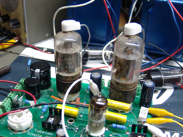

Tubelab has done it......Running any of these sweep tubes as cathode biased triodes, at any type of reasonable plate voltage, gets you into the realm of really high cathode voltages - you'll probably want 100 volt caps for that position.
I bought over 100 6BQ6GA's and 6BQ6GT's at an average price in the 60 cents each range, so I took some of the ugliest ones (sold as new) and "tested" them to find maximum power. Yes, a 63 volt cathode bypass cap explodes right after the 5 watt resistor unsolders itself.....of course I was violating the specs just a wee bit! Two crusty looking GE made 6BQ6GA/6CU6's in the hot seat. I got 20 watts at 3% THD from these tubes.....for about 5 minutes before the cap blew.

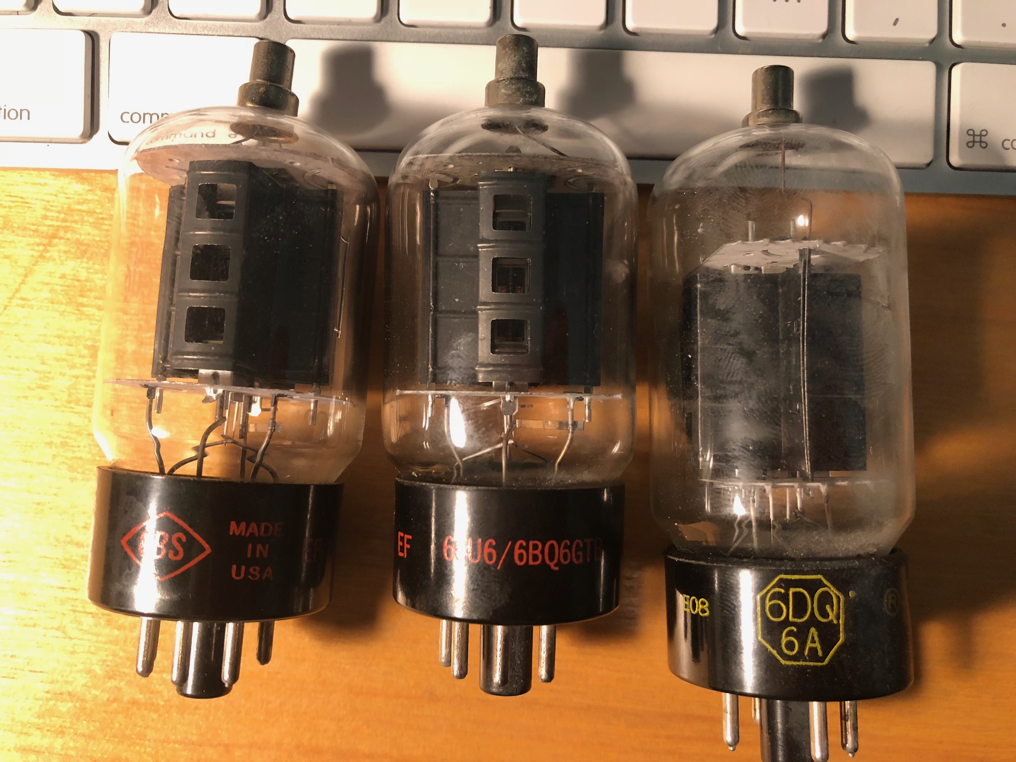

Here is a picture of a Sylvania made, RCA branded, and very crooked 6BQ6GT (rear) next to a GE made 6BQ6GA (front).

I've got one Raytheon 6DQ6, which is in a larger envelope than the 6CU6/6BQ6GTBs. The plate looks similar but not identical. The other innards are a little different too. Pics attached.
I found an RCA datasheet that has common operating conditions for class A1 (also attached) -- Grid 2 150V, plate 250V/57mA. So I could try that in pentode. Maybe even use a 0D3 to regulate Grid 2 to 150V, but I'll just use resistors first. I'm away for work the next few days so I won't be able to get back to this til next week.

The 6BQ6 tube dates back to the 1940's. The oldest data sheet I have is 1953, and its for the 6BQ6GT. There was a 6BQ6G before that in the Coke bottle glass shape. I have old GE tube dated 1943. It is marked 6BQ6GA
In those days the internals changed nearly every year as demand grew. The manufacturers were still learning how to improve the quality, and streamline their manufacturing processes to reduce costs. There are lots of variants in any and all tubes from the 40's and 50's.
By the 1960's GE had started putting the same plate in nearly every tube that had the same dissipation rating, and even putting oversize plates in some tubes so that they could consolidate assembly lines. This meant that all 18 watt sweep tubes got the same "corporate" 18 watt plate. It was also retrofit into lower powered sweep tubes where it would fit. Hence the 6BQ6GA's with the 18 watt plate despite an 11 watt rating. GE also had an identical looking plate that was taller and found in the 22 and 24 watt tubes, and some that were taller still for the bigger tubes. Sylvania and RCA did the same thing, to a lesser degree.
The different plates between your 6DQ6 and the 6BQ6's are due to the different manufacturer's different plate structure. My GE 6DQ6's and GE 6BQ6GA's have exactly the same plates, in both the 50's versions and the 60's versions. Ditto the RCA's.
I know that Raytheon did make their own tubes in the military and industrial markets. The 6DQ6 might have been originally designed for TV sweep duty, but it did find its way into a lot of things. It was the switching device in the SMPS used in the Tektronix 504 scope, yes a switch mode power supply using tubes existed in the 60's. Did Raytheon actually make tubes for the consumer market? I don't know.
All of the 6BQ6 type tubes seem to share a common data sheet with an upgrade in the plate voltage rating coming with the GTB version. All state an 11 watt plate rating including all those later variants with the 18 watt plates. All of the GA and other fat bottled versions can safely eat 18 watts, and maybe a bit more. There are at least two fat bottle sizes in GE tubes. I have some of both. One is about 1/4 inch fatter than the other.

What is the safe operating point for a triode wired 6BQ6? I don't know since I never had one running for long periods. The very similar 6AV5GA will run at 250 volts forever. I haven't done much testing with a pentode wired SE amp, but that's coming soon.
The 6BQ6 types do make good push pull amps, just run the screen grids at 150 volts and feed the plates as much as you want. I managed to blow up a pair somewhere north of 150 watts out on 650 volts. Below that it depends on how you are going to use the amp. If you want to make sine waves at maximum power forever, stay under 50 watts per pair on 400 to 450 volts. Want to play loud music where the amp just hits clipping occasionally, 75 to 100 watts isn't a problem.
Where to start with an SE amp? I would try 200 to 250 volts in triode with a load in the 3K range, 300 to 400 plate volts in pentode with about 150 on G2.

On an SSE board, in TRIODE I was running 290 volts on the plate, a 680 ohm cathode resistor, and was measuring voltage at the cathode between 40 - 42 volts over a handful of 6BQ6GT/A/B.
Looks like 6DQ6B was 50 volts at the cathode under the same conditions.
Apparently, I also have 6BQ6's that are dead ringers for 6DQ6's, because my notes indicate that as to one tube, I thought it could be a 6DQ6. The voltages confirm it was a 6BQ6.
I'm *pretty sure* I ran some small plate / small bottle Tung Sol 6BQ6GT at those ^^^ points for an extended period of time. That is 15 watts if my arithmetic is correct, but they did not fail.
6BQ6 and 6DQ6 had similar SMPTE IMD distortion up to about one half watt, where they differentiated with 6DQ6 having about half the distortion of 6BQ6 above one watt. At that time, I could not measure for THD, so can't speak to that. My test equipment is mediocre at best; I just use it to look for distortion trends up or down.
My recollection is that increasing the cathode current dramatically reduces the IMD and that 6DQ6 was almost as good as 6146, so, as triodes, you want to run them smoking hot. I don't recall power output moving much, if any, probably because of the low plate voltage.
This would have been with a 5K load, that probably hurt the power output.

They are very nice though in push-pull, here is 30W per channel amp, almost class A. I run them at 15W each, at 375V B+ and 150V G2, with cathode feedback from 0-4 Ohm and 4-16 Ohm taps of the secondary.

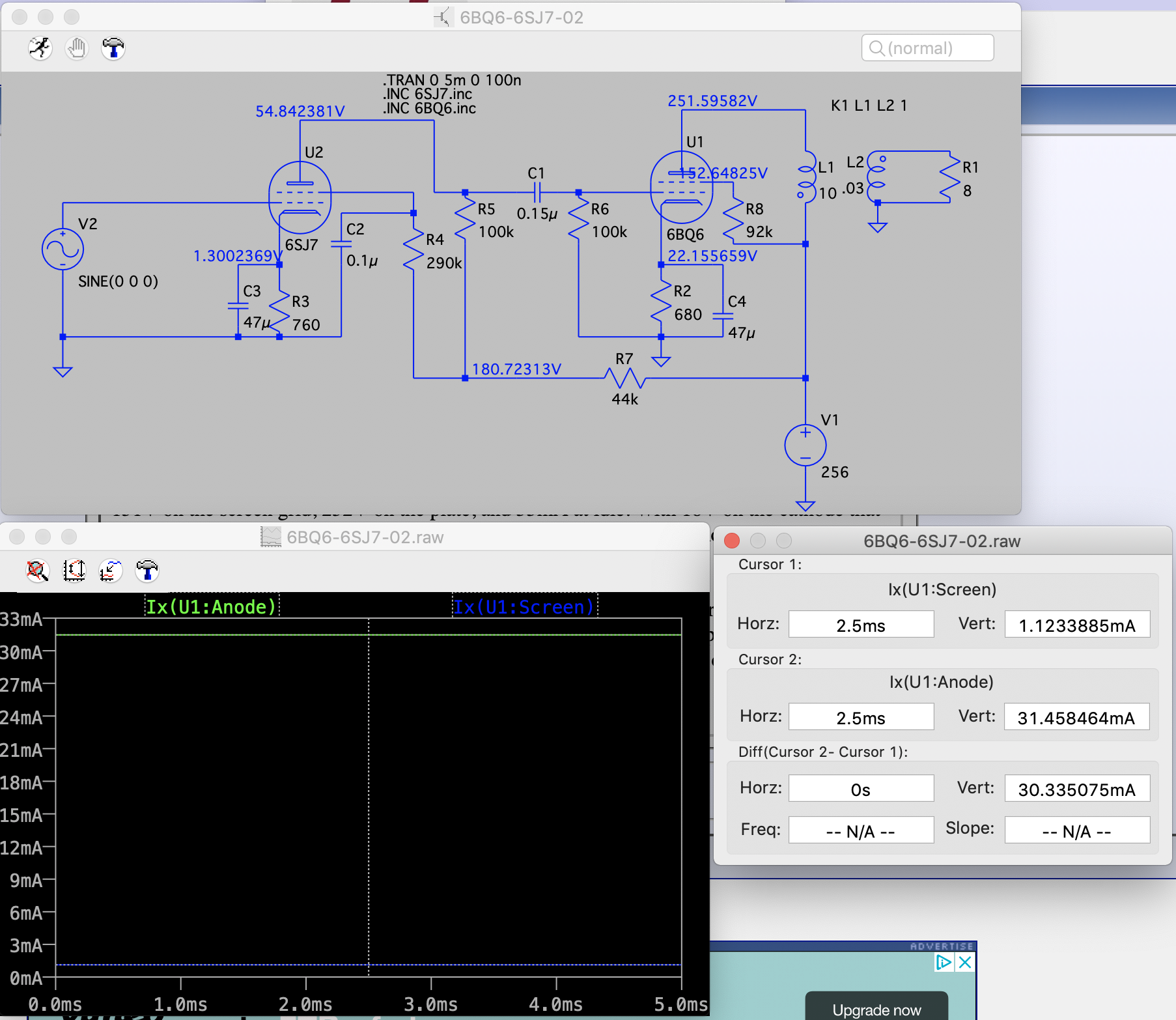

(B) Following Win's suggestion for 150V screen & 250V plate, attached is a pentode simulation in LTSpice with about 151V on the screen grid, 252V on the plate, and 55mA at idle. With 18V on the cathode that makes 55mA * 234V = 12.87W, a little north of the rated 11W. In the model, a whopping 56K resistor (too much?) is required to drop the B+ voltage to 150V for the screen supply.
Then I tried to model the RCA datasheet suggested configuration for class A1 -- 250Vp, 150Vg2, -22.5V bias. I got close with a 680 ohm cathode resistor, another really big screen resistor (92K), and tweaking some other things (attached). This is about 33mA total for a dissipation of 7.5 watts.
In both cases, the 6SJ7 implements the settings in the 180V Ebb section of the RCA resistor chart for a voltage gain of 55 (this setting worked excellently in my 7C5 experimental amp). Input sensitivity of the simulation is about 0.25V, which is good for being driven by a CD player and comparable sources.
