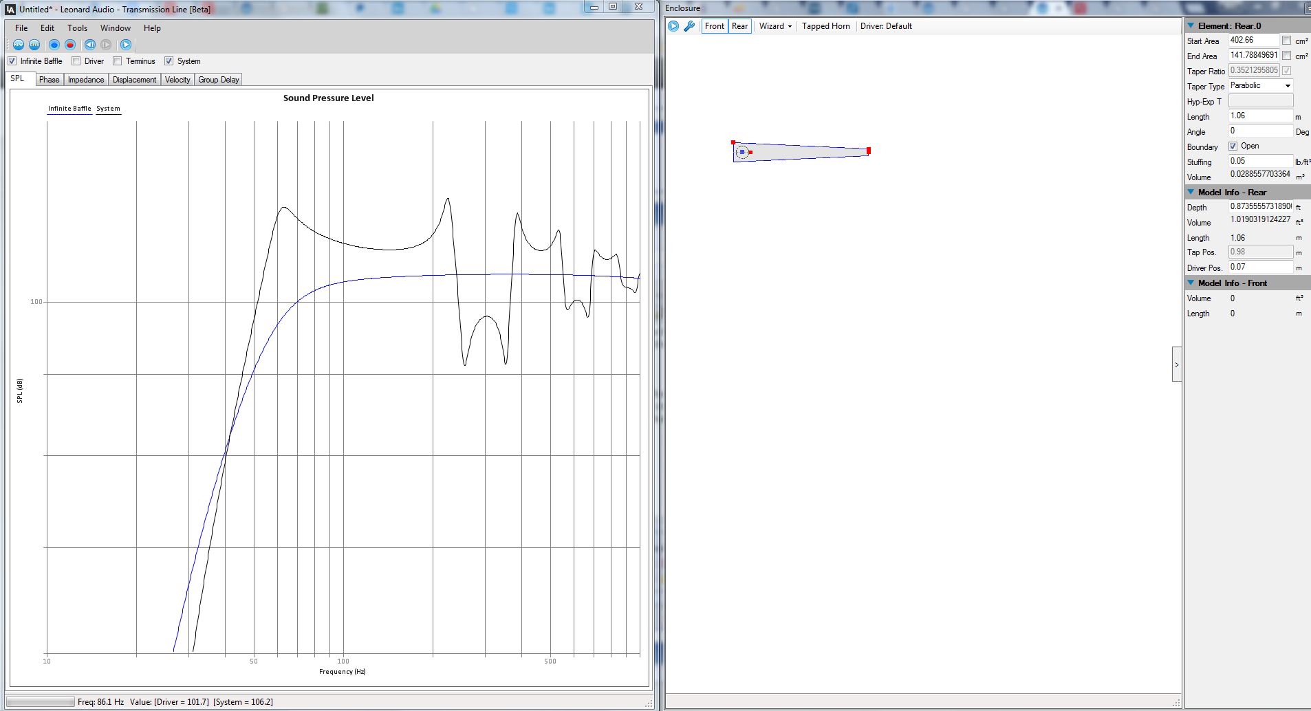

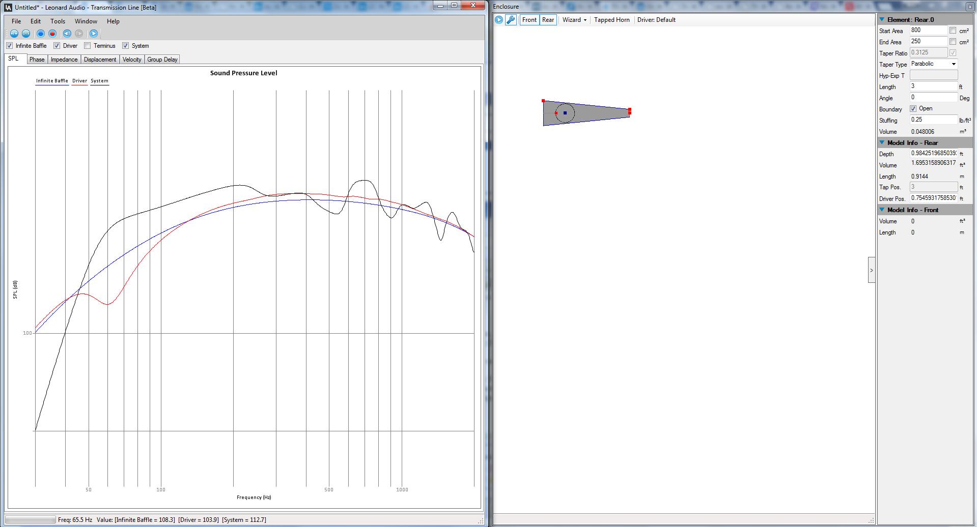

I haven't used Leonard's software but in the graph, which line is the predicted finished response, the black line with the ripples or the red line that's perfectly smooth?

Here is a preliminary ballpark using Leonard's software: 1 cubic foot internal, tapered, .3 lb/cu ft stuffing. If the ripple looks this solid we're in business but something tells me it's smoothing out more than in real life. Simulation is done using a single driver because I don't know if it can handle multiple.

The ripple one represents system response, the flat line is modeling that driver on an infinite baffle (for reference). Adjusting stuffing rate affects the ripple of the mid-range as expected. See attached for minimal (.05 lb/cu ft) stuffing.
0.4 lb/cu ft yields a ripple of about 1.5 dB, not including imperfect driver response.

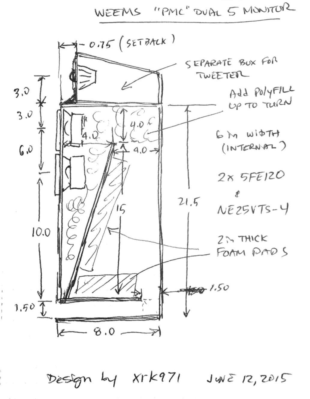

Here is a dual 5in driver (the one you suggested connected in parallel) TL with f3 of 60Hz, 105dB max SPL in 4pi space, 89dB sensitivity at 2.83v. It uses the Tymphany NE25VTS-4 silk dome tweeter mounted in a separate box above the main TL. I have the design set for an acoustic XO of 2500Hz, with the electrical LR2 XO frequencies in the sim set at 2700Hz LPF on the 5FE120's, and 3000Hz HPF on the NE25VTS-4. There is a 1st order Butterworth HPF to limit excursion on the woofers set at 51Hz (BW1 used here to reduce group delay). Xmax is reached at about 19v drive at 87Hz, and 9mm (xmech limit) at 35Hz is reached at same 19v. So keep amp below 19v peak values.
Here is the sketch of the design. Use stuffing in TL all the way up just past 180 deg turn, line rest of TL with 2in open cell foam (or felt if you have it) on 2 walls and at bottom, don't block vent.

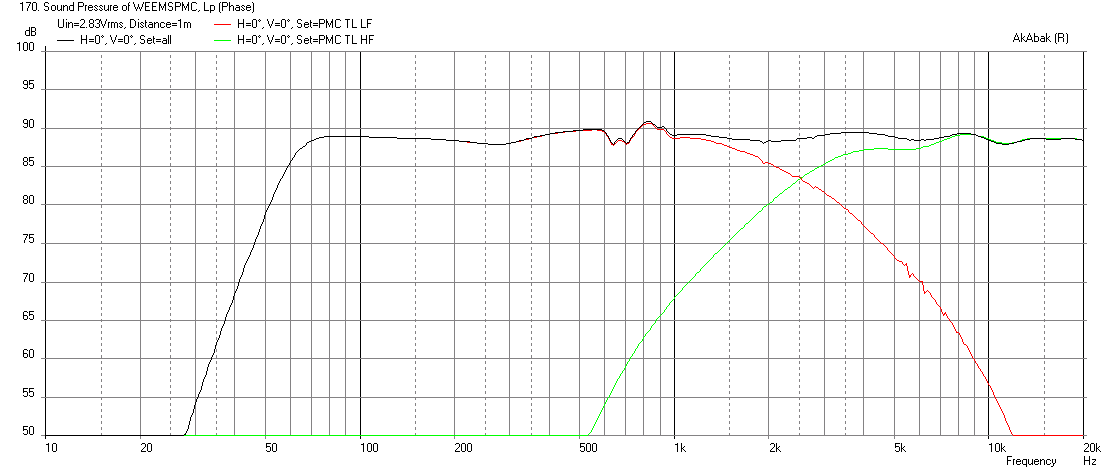

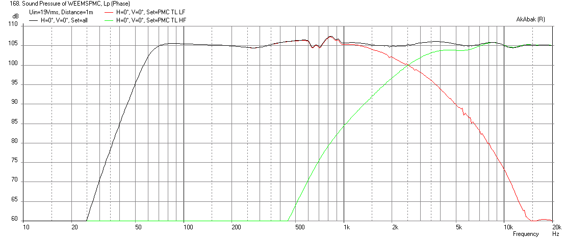

Here is predicted freq response at 2.83v in 4pi space:

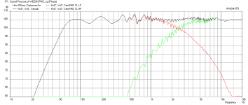

Here is predicted response at 19v to reach xmax and xlimit - you get 105dB max SPL which is decent for a couple of 5in drivers:

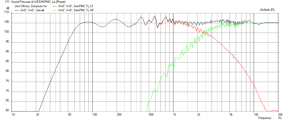

This is what it looks like when you set it on a 30in high stand and put it 5 ft in front of a back wall and turn the reflections on in a room with pretty absorptive carpeted floors and treated walls (like a studio):

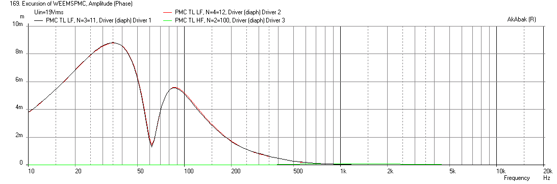

This is predicted cone displacement at 19v (with 51Hz BW1 HPF):

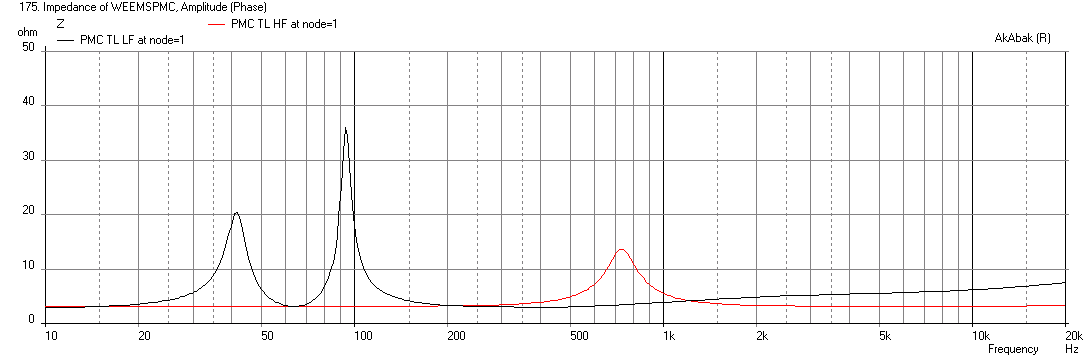

Here is system electrical impedance:

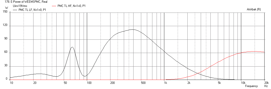

Here is electrical power input at 19v (woofers will see 56 watts peak each):

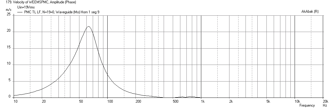

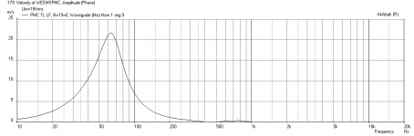

This is predicted vent velocity at 19v, at 20+m/s, it's a bit high but is only reached for peak SPL's:

I picked f3 of 60 Hz for an arbitrarily solid transition point. Mainly because all my other speakers cross at 80-120 Hz and the room acoustics of small rooms make it hard to effectively get flat bass and especially upper bass in any given listening position. I'm looking for something with enough 60 Hz to smoothly transition and handle power without fatigue, below that -> PA subwoofer. I figure that making the enclosure work with 40 Hz tuning would just be a waste of potential output. I also hope to learn Akabak with this experience as I feel it is the best suited to simulate the system in combination with Hornresp as a starter.
I'm leaning towards the dual 5 inch version because it allows for a really slick baffle and half the fun is making a really nice finish (once the acoustics have been tested out).

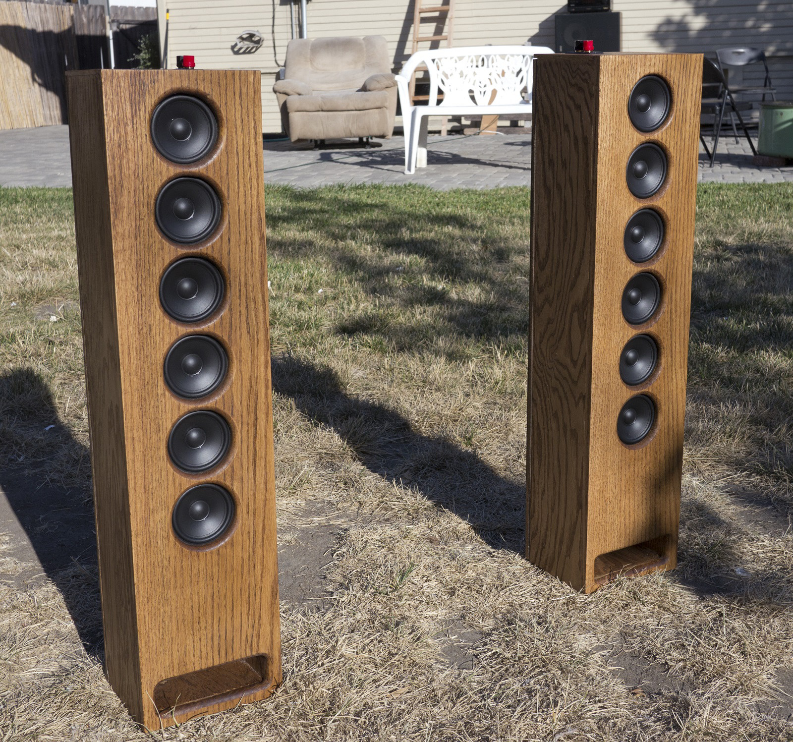

Oh, I've still been building 🙂 here is a photo of a build for a client (1st one, excited). It's a stuffed transmission/line array with TC9FD's, it hits the snare drum like nothing I've heard.
I've built 3 different custom designs since we spoke last 🙂.

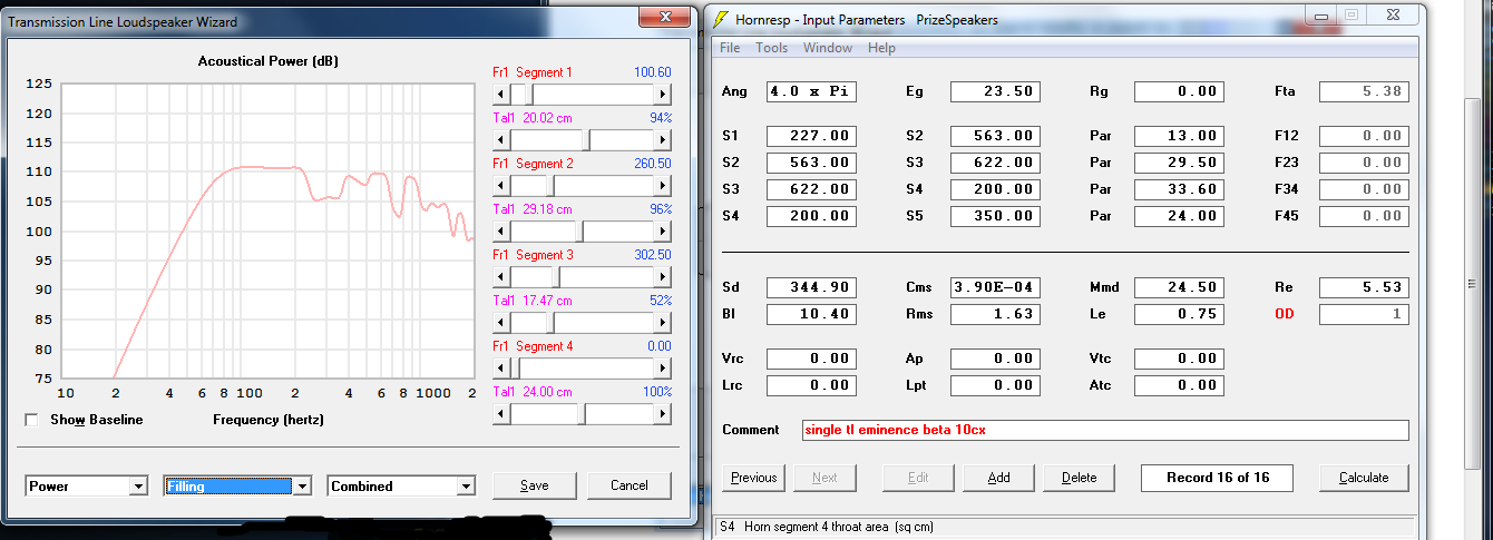

The beta 10CX seems really attractive with it being more excursion and displacement, probably 1 would be enough. Survey says 2 10cx's per side will take the house down, sounds right on spec 🙂.
Thing I noticed, designing as a TL doesn't seem to get much pro with the added con of unsmooth response (in hornresp it looks particularly ugly before damping and added features are taken into account). Is there really a point to not just building this as a dual ported box with the top coax having a compression driver?
