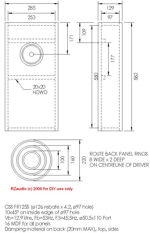

Thinking a retro-ish (slim-line, wide baffle) shaped box would suit them Rabbitz came up with dimensions based on golden ratios and various other voodoo art stuff. They were completed yesterday and stuff me if they don't sound even better than the narrow baffled box. More open all round, a fuller bottom end and the mids are a little more forward which brings the overall balance up nicely. There's a few things I'd like to try but can't drag myself away from the things they sound so damn good! WOOHOO!

Here's the drawing of the box. Port not shown but can be located on the sides or bottom. The driver cutout on the baffle needs to have a radius or bevel on the inside to assist with airflow.
Lazyfly has reported that 40mm damping works well and any more is detrimental. He still has to do the stand for these and think about port location with that in mind when constructing.
The difference in sound between the slim wide box vs the deep narrow box is interesting.... almost same volume and Fb. Maybe someone has an explanation as all I can come up with is lower baffle step and difference in back wave handling and reflections.

Hi kristleifur, the rings were something Rabbitz hooked onto that he'd seen in some old Mission or B&W or both. Something about breaking up the resonances immediately behind the driver, though he also noted that the basket design kind of has the backwaves shooting 'sideways' I'll let Rabbitz elaborate on it all as my knowledge is a spit in the ocean compared to his :D

I like the port at the bottom too though Rabbitz will testify I've been mildly complaining ever since as it limits the stand options. With regards to stands, I haven't done them yet :whazzat:
A short listen showed that with the cabinets sitting on some 400mm high metal stands the plate covers the port. Quite a bit of the bottom end disappears and the mids lost out a bit by sounding a little recessed. I'll plug the ports properly and have a proper go later on this evening, I'm guessing covering vs plugging will make a fair difference as there'd be air leaks the way I did it.
Maxdd & onespeed, I've had a good listen to this speaker sealed, and obviously not sealed :)
Initial impressions were that there wasn't a great deal of difference aside from what you'd expect, tighter bottom end though less of it and the driver working harder. There was one thing however that was improved by a margin and that was imaging. It was noticeably more precise which suits the speaker remarkably well! The music was a shade or two tighter.
That's the biggest plus but the loss of bass weight and extension makes it a tough choice as I personally love the tonal quality of these down low. I have a M22 8" Vifa 'sub' that goes down to the low 30's and I much prefer that to be off when these are playing.
So it's a bummer as that imaging makes the choice a little bit harder, bass-reflex or sealed? These will likely live happily without a sock in the port but that imaging does have appeal and it's nice to have it both ways :)
one1speed, it's great to have the choice and tried it again last night just to be sure I wasn't making things up. I wasn't though do prefer the port opened.
A tip: Put the port on the side or rear (with an elbow)!
fergs, if Rabbitz were to perform a true random act of kindness - well said by the way - he'd have put me out of my misery while he was visiting! *mumble* *port placement* *mumble*
