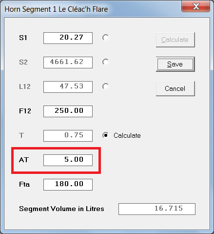

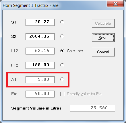

Hi David,
Yes I found that but with Tractrix I have to lower Fc to get to the 5 degrees.
Is it a big problem if it's not exactly 5 degrees?
Rob
Rob
