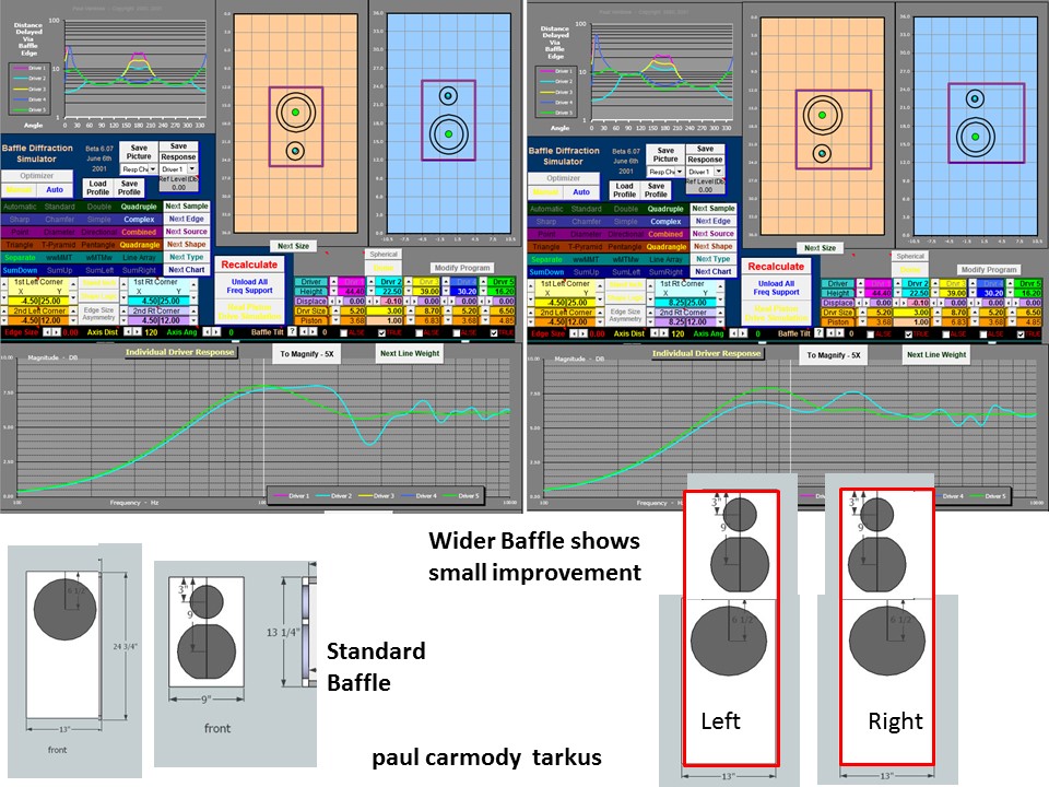

I ran this sim before suggesting a single cabinet alternative.
This baffle sim of the standard Tarkus TM-baffle-dimensions vs. the proposed dimensions of a wider single box suggests the SPL difference is small, and the wider baffle sim shows reduced edge diffraction.
