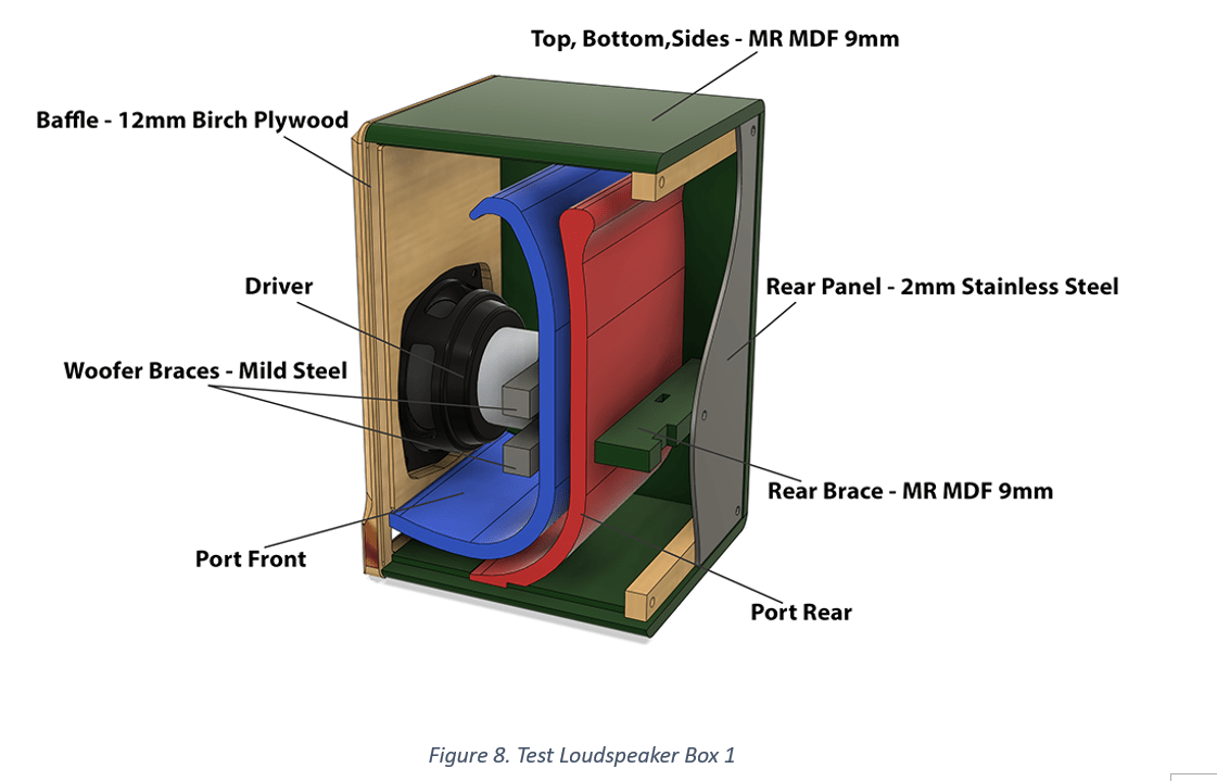

I would like to share with you the concussions of a study I have been working on over the past months to design an optimised 3D printed port for a desktop loudspeaker. I tested various methods to reduce unwanted resonances, while keeping an eye on port turbulence.

There is a whole lot of info in the paper beyond this including the effect of holes in ports, reduced wall thickness, constrained layer damping and what bending ports does to the response. I encourage you to check it out, since it took me a lot of work :)

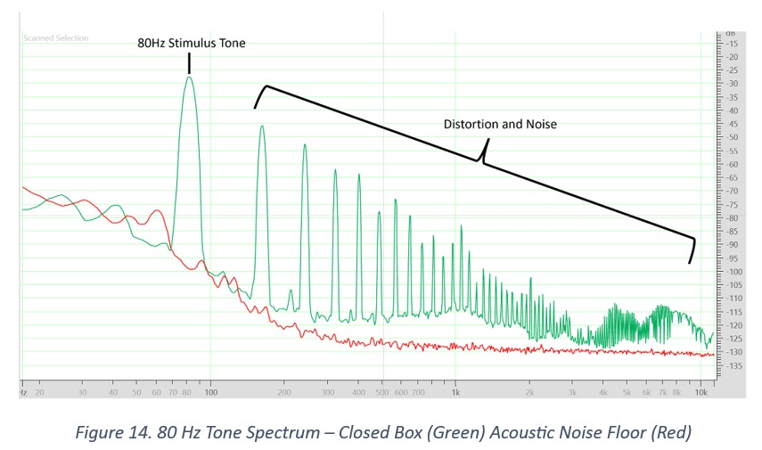

You might want to review the reference to the Dayton Audio ND91-4 where you write "The high cone excursion of 25 mm peak".
The ND91-4 specifications list it has a voice coil diameter of 25mm, an Xmax of 4.6mm (9.2mm peak to peak).
It is possible that Xlim/Xmech might be 12.5mm (25mm peak to peak) but considering 2nd harmonic distortion at 80Hz in the sealed box at 8.7volts was about -18dB (~13%) looks like it reached or exceeded Xmax at ~90dB at 1meter.
Port resonance problems are a tough nut to crack, interesting to see the results between the "baseline" and "optimised".
Reducing the out of phase 600Hz port resonance reduced the cancellation notch there, while increasing the problem at 900Hz.
Not a bad trade.

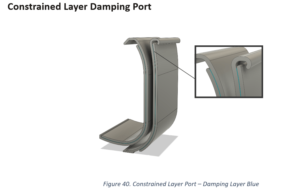

I would never have guessed CLD would be the most effective. So it isn't simply the air in the pipe taking part in the resonance, but it gets some support by the characteristics of the wall? I suppose the Kef port kind of points to this but when I tried to copy it the results showed some small benefit but nothing to get excited about.

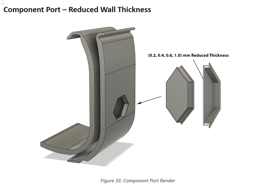

I don't quite understand the wall thickness tests. You only thinned a small hexagon shape in the center of the port? Why not the entire wall at the center?
I suppose it highlights that nothing is perfectly stiff, everything is elastic especilly when resonance shows its face. The ports all feel quite sturdy to the touch.
Regarding the reduced thickness, I already tried a full thin wall and it was terrible so I knew there are limits. I didn't make it the full width of the port because I wanted to keep some structural connection between the top and bottom parts of the wall. Width of the area is 40 mm out of 100 mm.
It appears to be a tuned absorber where the energy in the acoustic resonance drives bending in the port which is absorbed by the damping layer. I would expect a combination of mass, stiffness, damping and geometry that works well to involve a fair degree of design effort. A degree of luck may have been involved in this respect.
A port that is flapping around will be generating unwanted sound (as will the cabinet) which will be showing up as the sound that isn't from the Helmholtz resonance, the acoustic modes in the port or the aerodynamic noise from turbulent vortex shedding which all have expected behaviours. How much of this should be traded? The acoustic modes within the cabinet are also likely having an influence given the dimensions. Correctly identifying and quantifying the relevant physics is far from straightforward without simulations that capture the relevant physics.
I think the extremely high level of damping makes application easier than one might expect for a 'tuned absorber' since the Q will be low.
The CLD port does show slightly higher turbulent chuffing noise than the baseline port and focused where the frequency of the resonance peaks are (1 KHz - 2KHz). Interestingly addition of the thin wall section did not increase this, if any reduced it slightly. I wonder how much is noise due to flexing of the port walls disturbing the air motion and how much might be the two layers of wall touching / rubbing on each other especially if there were small gaps (I did my best to ensure a complete bond). It will be interesting to see if a slightly thicker damping layer reduces that noise region.
I should have the opportunity in the future to try this on a larger cabinet and port with round or oval cross-section shape.

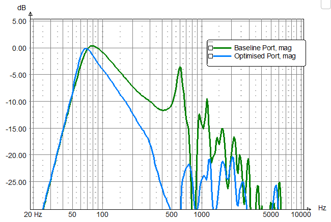

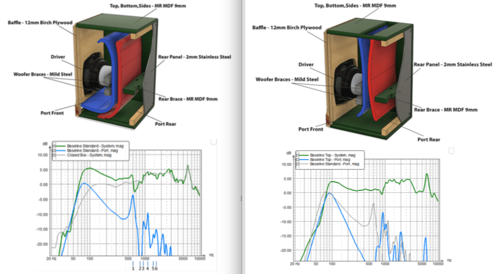

Using this picture for an easy visual reference (thanks weltersys), we can see the 600hz resonance is gone, but we have two variables.
1. The port is changed.
2. The port opening location is changed.
How confident can one be of the conclusion that the elimination of the 600hz resonance is due to variable 1, but not variable 2?
If the driver was placed symmetrically in the box, orientation of the port opening (top vs bottom) wouldn’t matter, but with the asymmetric location of the driver, nodes/antinodes will also be different throughout the box. Perhaps one port location was where there was a 600hz node, but not in the other?
Reactions: 1 user
That's a very good point, the driver is slightly off centre on the height of the baffle. I tried flipping the baffle 180 degrees quite a long time ago and saw only minor changes. That was before I started taking it seriously to document everything.
I don't think the response is entirely dictated by the port shape there does seem to be a cancelation going on on the right hand graph. Perhaps as the length of the port and the cabinet are similar they interact.
I should note the entrance to the ports is all in the same location other than the inversion vertically.
