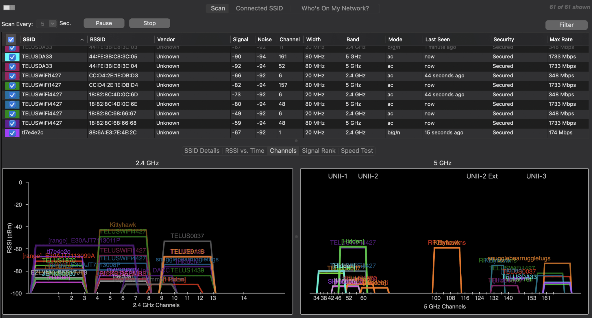

This is the wifi environment as viewed from my backyard. Only two of those networks are mine. Granted, I live in "inner city" Calgary, which is a fairly broad term. I'm about 4-5 km from City Hall.

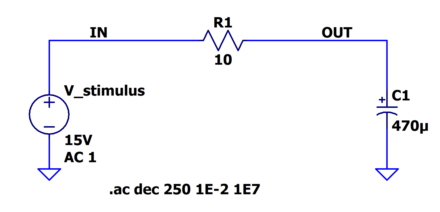

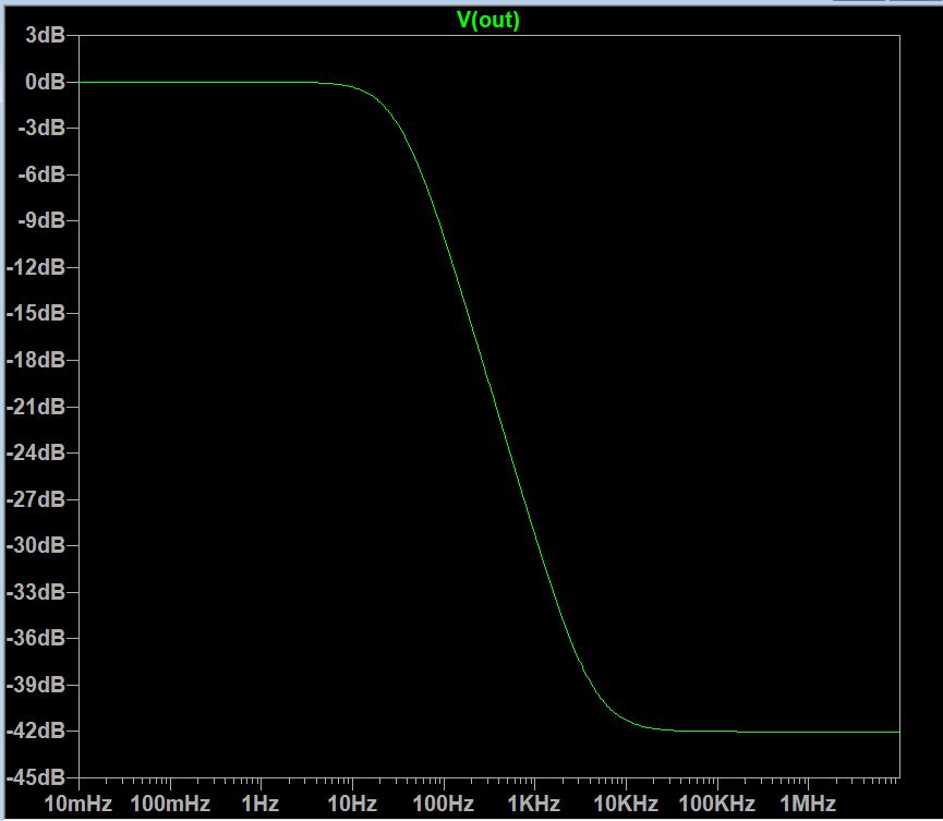

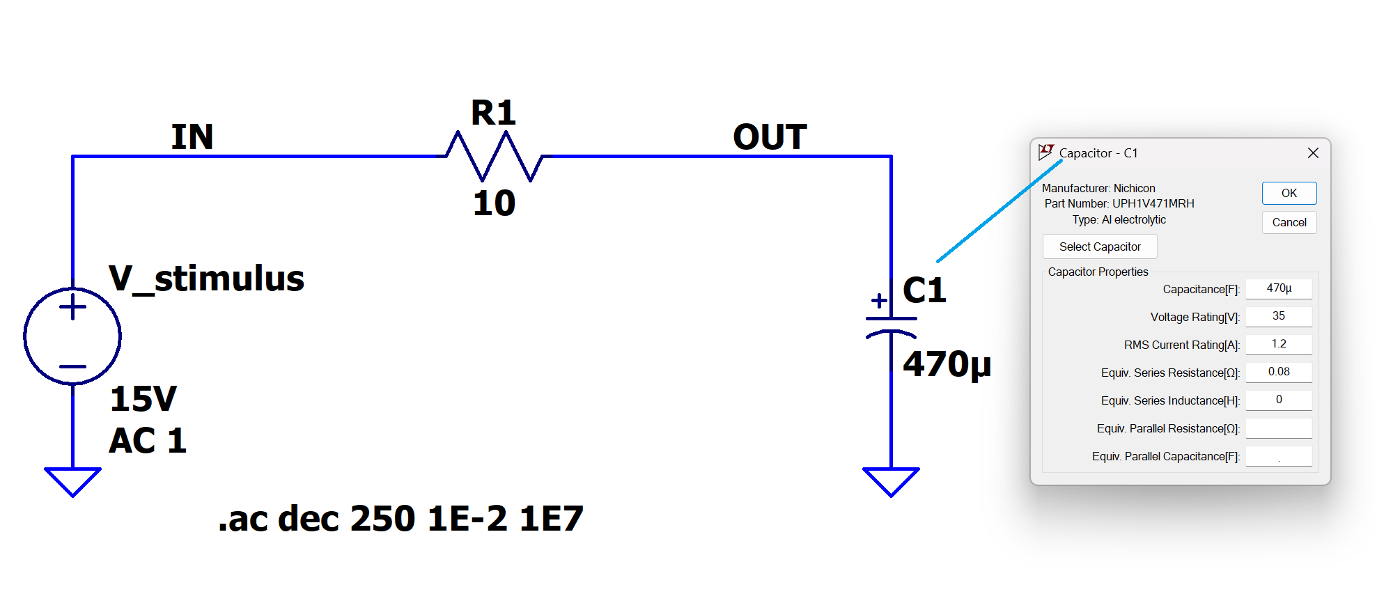

What is taught in school is that lowpass filters have increasing attenuation in the stop band. That's not the case in reality.
I was thinking specifically of active filters where the loop gain of the opamp limits the stop band attenuation, but as Mark pointed out undesirable stop band performance is not limited to active filters.
Your own wifi and smartphones will generate much higher RF levels than a base station or outdoor access point, even if its fairly near.
