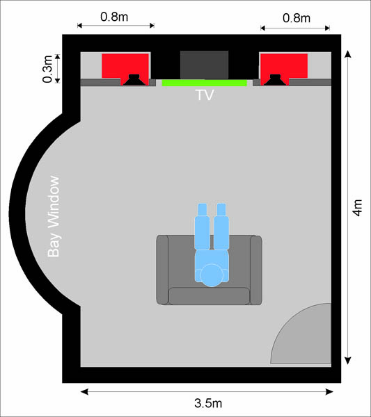

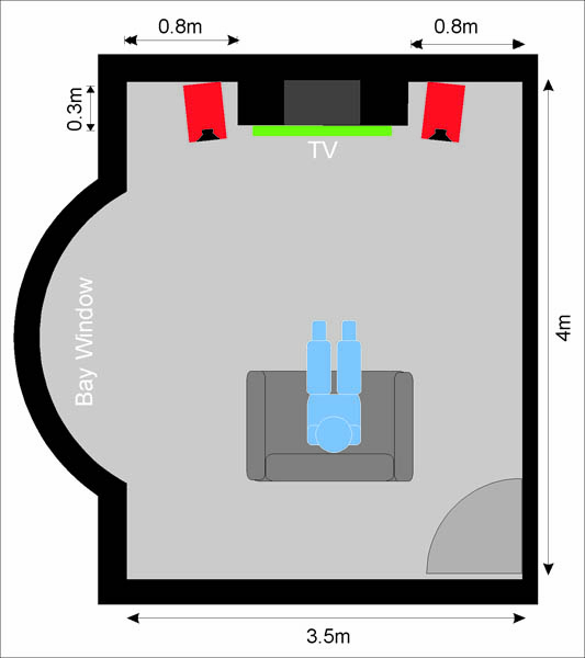

I'm intending some active 3-ways, and another thread has suggested the possibility of soffit mounting them. There is a diagram attached of my living room more or less as it is now, with my current small bookshelf speakers (there are other chairs and coffee tables etc not shown). And then another diagram of how I envisage some larger 3-ways could perhaps be built behind a new false wall or soffit. This should turn the awkward alcoves into a smooth flat baffle to work with, and I could also hide quite large bass enclosures with only a small proportion showing and virtually no intrusion into the room.
So.. If I were setting out to design a 3-way specifically for this type of mounting, clearly I wouldn't design my active crossovers for much in the way of baffle step, and presumably I would choose drivers that have a nice flat FR without narrow/shaped baffles to tweak it. And if my false wall is vertical I could perhaps recess the tweeter in a modest waveguide to allign its acoustic centre with the mid (and perhaps control directivity), although I'm also tempted to keep it flush for simplicity. But those are just my ideas and could be naive.
Probably its my ineptitude with the search facility, but I can't find many threads dealing with design criteria for soffit mounting or 'very' wide baffles. There are some room-build threads which are also useful, but often they're for control rooms that require the speakers to be above a large desk and/or window, which I don't need to accomodate. Are there any special things I need to consider in a design for soffit mounting and/or are there any good threads on it?

With active crossovers smoothness in a driver response is probably more important than flatness. The response is going to be shaped anyway and so including a correction for smooth slopes and bumps is straightforward. This is less so for sharp wiggles particularly if they do not occur off-axis.
You do not want to mount the drivers directly on the baffle. Putting them in their own enclosure and then isolating it is perhaps the simplest and most flexible approach. The reason is that a large flat baffle has the potential to radiate a lot of sound if vibrated.
There is a lot on soffit mounting on the web with much of it being sensible. Pretty much all of the control room information is relevant to your situation despite your reservations about mixing desks and windows (one of which you have). If you do decide to go for soffit mounting then you may well receive better practical advice from forums focussing on the acoustics of small rooms such as this one among several others.

Given the size of the IEC baffle the manufacturers charts are probably more reliable for your situation than for 'normal' speakers, at least for mids and treble.
As for the bass driver I think your choices may have increased since it should be easy to disguise quite a large volume bass enclosure. You've got about 500L to play with at a rough estimation.

Thanks for those suggestions! Thick curtains and some sort of hanging should be very do-able, and I'm glad the manufacturers charts could be reasonably reliable (for mid and tweeter); I'll probably have more confidence to select drivers of my own choice, rather than copying other designs.
