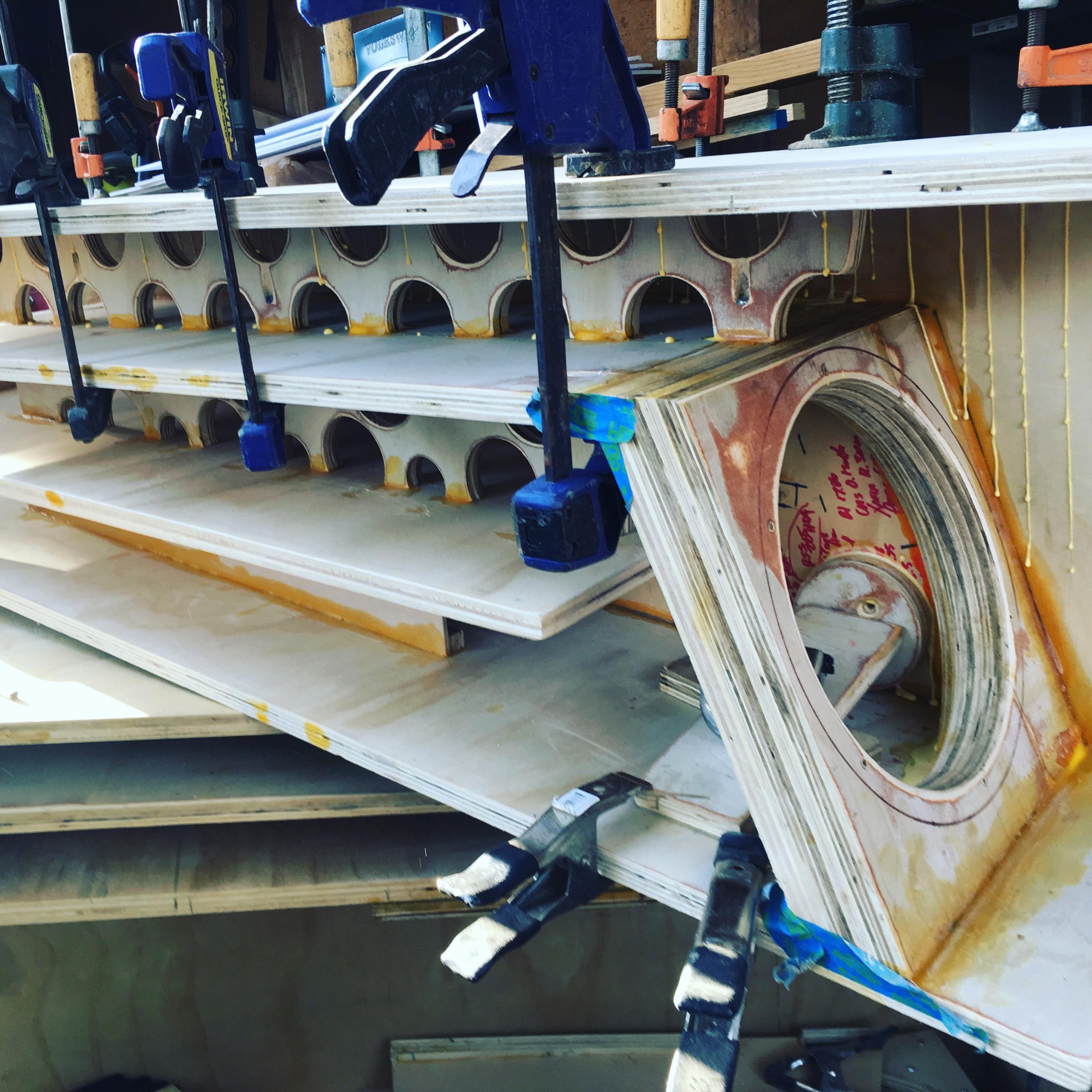

The offset driver is using the same fulcrum
As a paraflex endfired from
Both sides pipes if its built exactky the same interval( plus one) . thats all blurred in goofy flare rates and undefined folding and spacing between specifiic nulls. its nit a paraflex its a compound horn with no path whatso ever to offser the fromt output and vented distance to the full wave form length. just put that imtoa roar and mind the next harmonic or watch the spike reform
If nit repeatmh the folds as 3 to 1 that equals 1/4 of tge fundamental real wave.
1200 cm is then 300 and 100. and if you havebt tried it out. I guess it because that sim has nobody thinking? I ever forget everything i learned a month ago and gotta repeat the process?
Iguess if you fold these up an leave no exit path to the other output itss a bt different?

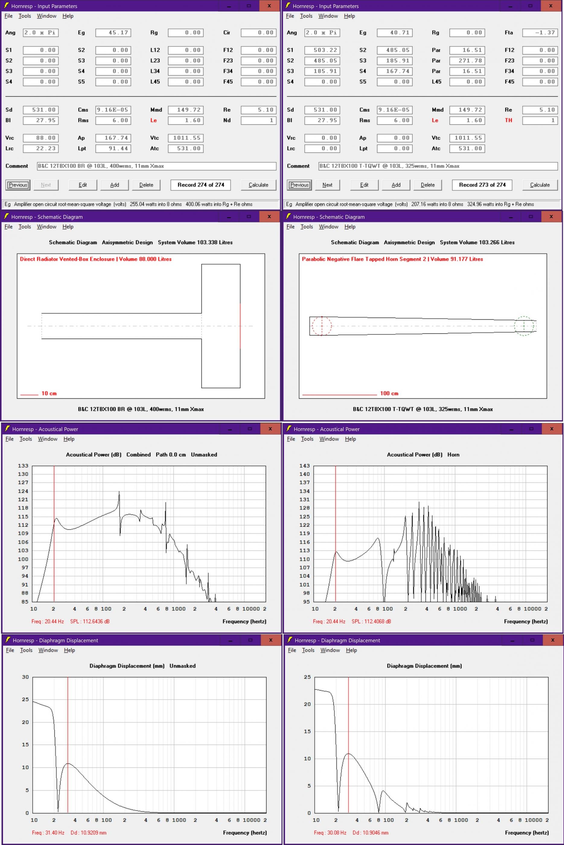

All I know is BR's and TH's only need 7 panels in their simplest form.
There is no way a properly built 30Hz BR can compete with a properly built 30hz TH.
The TH wins in distortion, efficiency, and SQ.
A negative flare TH (T-TQWT or T-TQWP) can compete with a BR in enclosure size.
When comparing different design principles we can do so using several metrics, the question is what makes most sence? SQ and other subjective criterias that cannot be arrived at using a data driven approach will be difficult to argue for since this is down to personal reference, and extremely few, if anybody, are willing to take chances in that regard nowadays.
