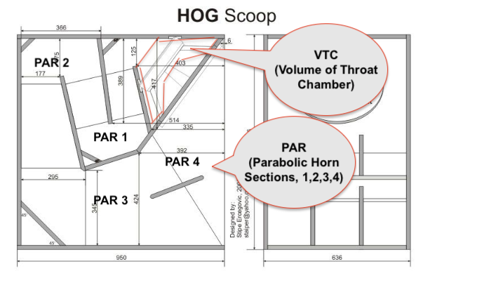

Proposed plan is based on the well known "Hog Scoop",
a tried and tested free design hosted over on the freespeakerplans.com forum.
https://www.freespeakerplans.com/?view=article&id=31:hog-scoop
Drawn up nearly 20 years ago, this well proven classic has stood the test of time and is a very
clever piece of speaker box design, still to this day.
Credit for this creation must go to Stipe Ercegovic, more commonly known a Staiper, a well respected member on the Speakerplans Scoop subforum for a long time,
but he disappearred from there several years ago and doesn't seem to frequent these places anymore.
The Hog Scoop, technically an F1 hybrid of sorts, the offspring of two genetically similar species,
living a life somewhere between a tapped horn and a traditional back loaded "scoop".
A rear loaded horn with the bonus of the driver shooting into the horn path, or a tapped horn enclosure
equipped with a compression chamber.... Call it what you will, this quarter wave resonator is well capable of
hitting the low bass notes and producing high SPL when equipped with the right hardware.

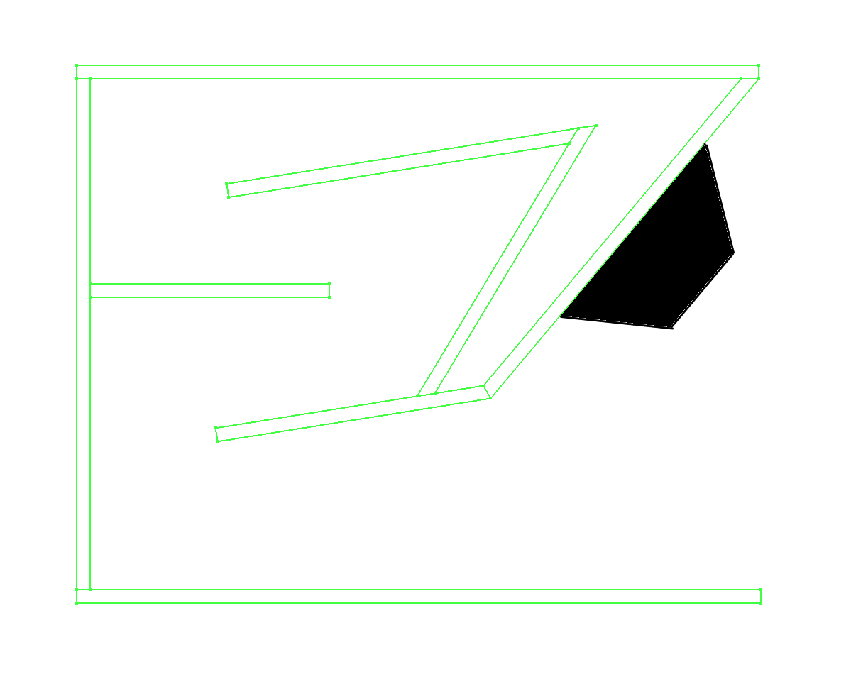

So, I would like to run inverted drivers in a slightly tweaked version of this enclosure, something similar to the image attached to the end of this post.

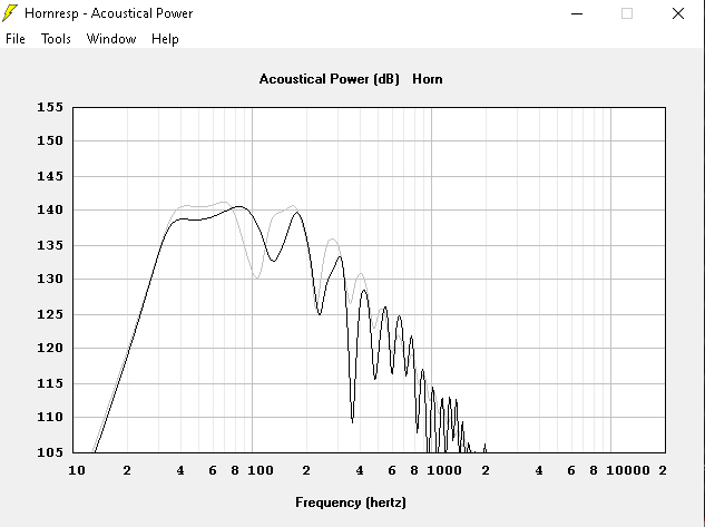

Hog Scoop Hornresp input parameters
First things first, I decided it would bee prudent to simulate a hog scoop with a driver in it's normal orientation first..... Cone side out.
This was to bee my baseline sim, a benchmark to work from before l went tweaking the original design.

Here are the most posted (and reposted) HR Hog Scoop numbers, I beleive they orignally came from Staiper, and these ones were the most common to bee found online,
copy and pasted in at least 4 different places, so I am inclined to stick with the guy who originally penned the Hog Scoop design. He did create it after all.
Stipe Hog Scoop
S1 = 750
Con = 112.8
S2 = 1062
Con = 42
S3 = 1770
Con = 51
S4 = 2544
Con = 47
S5 = 5700
Vrc = 0
Lrc = 0
Fr = 0
Tal = 0
Vtc = 49456
Atc = 86

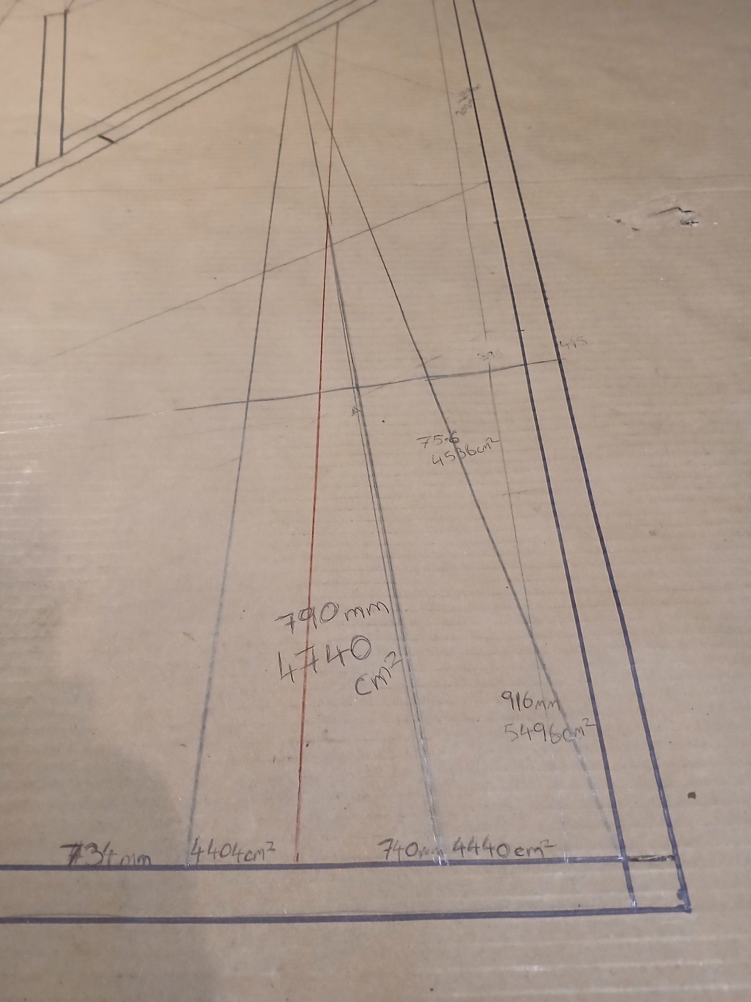

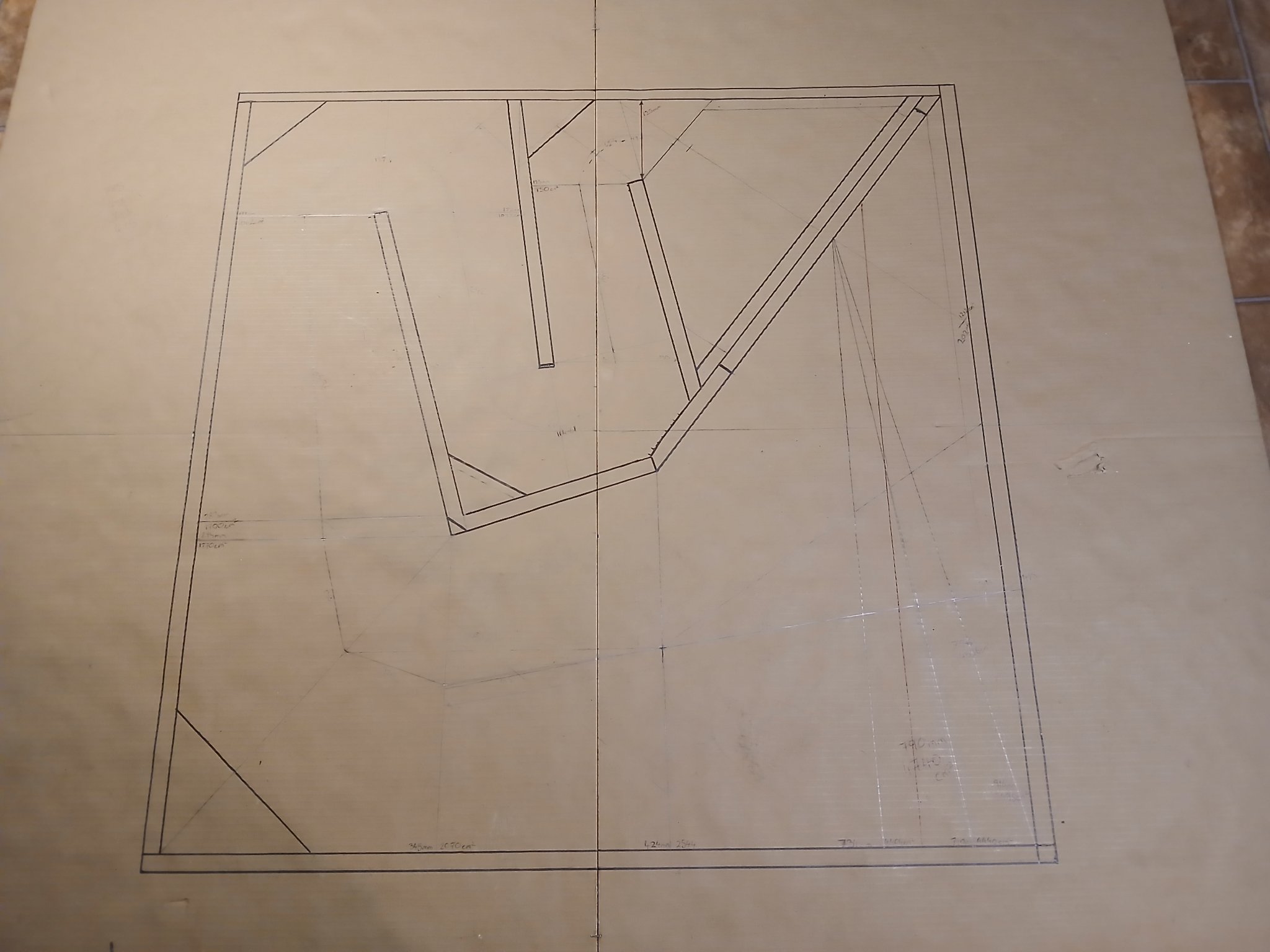

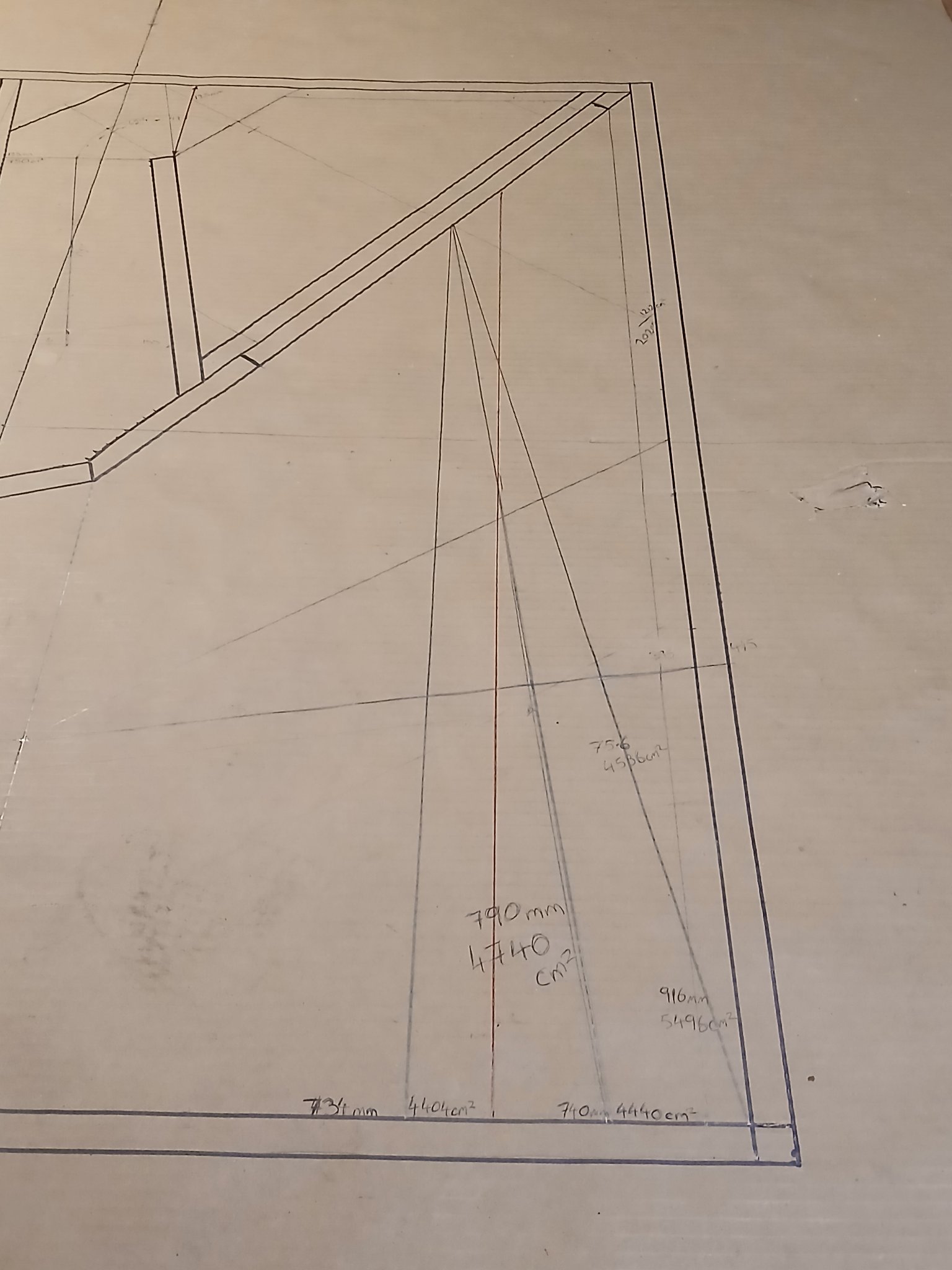

So, I took some time out and drew up a scaled plan of the Hog, just enough to play with.
it gave me a much more definite idea of the direction I asm going in, speaker boxes ofthen quite literally build themselves as the project goes on.
Solutions are often just so obvious when you have the material object taking shape before your eyes.
And measurements can bee taken from the plan and scaled up to something that resembles real world numbers.
(Drawing attached)
And just to bee sure, I am going to get my hands on one side panel first, (18mm sheet board 986 x 950mm) and draw it out @ a life size scale on the floor.
(Drawing attached)

Your "Monster Front Loaded BR Sub" was ~160 liters.
The Hog scoop extended to mount the driver magnet out will be over 600 liters, about four times the size (volume) of your "Monster Front Loaded BR Sub".
How much more will it weigh?

i have attached a plot comparison of two sims, both the same hog scoop, the first modelled as a tapped horn and the second as an ND normal horn.
seeing as they are a mix of the two, I feel something can bee learned from this.

1) The Hog Scoop design has no compression chamber.
A compression chamber is a sealed chamber a horn driver is enclosed within.
2) What you may have thought is a compression chamber is a throat chamber.
The volume of the throat chamber (VTC) will be greater if the driver is reverse mounted.
The distinction between where VTC ends and the horn begins is interesting...
3) The Hog Scoop design is not an exponential horn expansion, it is a series of parabolic sections that may be similar to an exponential expansion.
For a folded horn with two parallel walls, using multiple "PAR" segments is closer to the design as built than using an arbitrary exponential horn flare cut off frequency to define them.
A "back loaded horn" has the driver mounted on the front panel, which changes the layout of the horn somewhat.A tapped horn I presume but it is also a back loaded horn of sorts.

A simulation has no sound 😉In a lot of my recent simming, exponential horn flare cut off frequency (F12) is about 20Hz and my drivers fs is 30Hz.
This sounds good, no....?
Since you have raised your design goal from a 35Hz Fc to 40Hz, using a driver with a 30Hz Fs may not be the best choice.
F12 is the theoretical cutoff frequency of an exponential horn having a certain rate of expansion (flare rate).

That config might be more of an offset-driver RLH than a TH, because of the location of the driver in the horn's effective mouth. And the size, which is huge for a TH based on one 18" driver. That volume is larger than what would be needed for a two driver 32 Hz MTH layout for the 18TBX100.
As you mention that will depend how this layout is fined tuned, the driver can be moved closer to S1, angles can be adjusted, etc, with simple generic sketch it's hard to define, but your warning needs to be taken into account.
I'm curious to simulate this design once you can have 3 different expansions. It's kind of SS style but in a horizontal fashion.

I spent many nights trying to get my head around Hornresp, doing random simulations, reading many forum
threads, the Help file, the Hornresp Manual posted online and other literature.
Many attempts were made trying to reverse engineer the already published HR input numbers posted upthread
but in the end my crappy little scale drawing would just not cut it so I drew the original Hog Scoop plan
in full size on a giant piece of cardboard and began to take my own measurements and reach my own conclusions.
The only thing that really stumped me was deciding where exactly the S4 parameter lay, and even working
backwards from epa's numbers in his two separate (and different) simulations it would seem that the S4 area
is measured forward of the speaker cone centre line.
Is this correct......?
I will post some photos taken on the phone, maybe someone has some input.
Once I have this final parameter down I will move onto discussing
e horn path length.... Because again,
I have come up with different and conflicting numbers.
It is a small problem really, as soon as I have the S4 decided I will continue on with my own horn dimensions.
Photos attached below....
