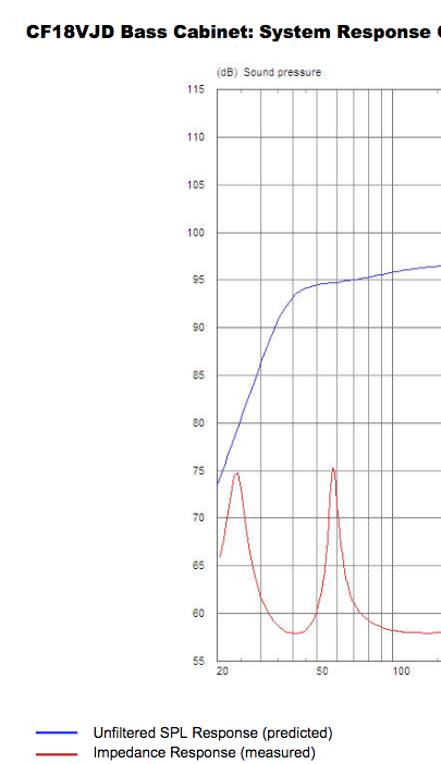

I found 2 sets of enclosure plans, one for the 18Sound 18LW2500 and one for the Celestion CF18VJD.
I will attach the pdfs to this post.
The 18Sound design has an effective volume of 177 litres yet I read somewhere in their literature that the recommended
enclosure size is just shy of 200 litres.
The plans from Celestion quote an effective volume of 167 litres so these two drivers of similar spec would appear to need
an almost identical sized enclosure.

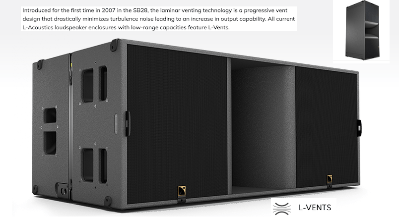

"Huffing round ports" waste power and "blow". Large laminar vents avoid port compression, chuffing and huffing.
L'Acoustics subwoofers are a good example of this style of porting, which lends itself to DIY easier than round laminar vents, and also provides cabinet bracing absent in a round port.

The Celestion plan you attached has an Fb above 40Hz, some techno has another octave of bass below that.

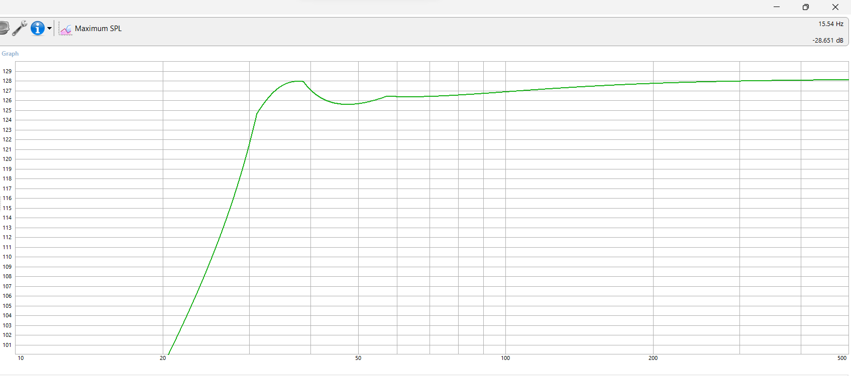

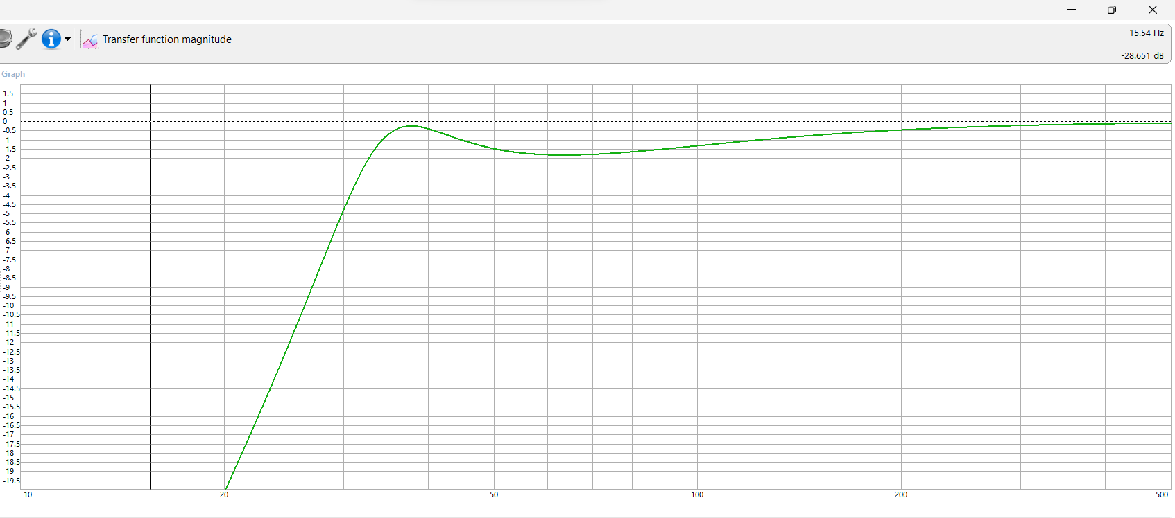

I suppose the honest answer to that is "as low and as loud as possible and as big as I can tolerate"
Thank you for your reply... It really got me thinking (thumbs up !!)
After much reading and a few WinISD binges I was slowly getting to grips with the calculator.
I loosely modelled many drivers of similar specs against a "guesstimate" box volume of 200 litres and it became quickly apparent that the
Eighteensound 18LW2500 in 4 ohm flavour was the clear winner.
But unfortunately, these rare beasts were out of stock every where and pretty much unobtainable.
So, in the end, I settled for the next best thing, and ordered a pair of Faital Pro 18XL1600 C, again in 4 ohm specification.
(Datasheet attached).
Having heard of this now famous "Hofmann's Iron Law", I was already resigned to the fact that I was going to give up size for low bass notes
and sensitivity.
That one's is just a no-brainer !!
The horse race between Low Bass Notes and Maximum SPL was neck a neck but in the end Max won, and I sold my soul to the devil down the
crossroads at midnight.... Yes people, I traded a couple of hertz for a few decibles.... Using the length of the port and it's tuning.
Final results -
128dB @ 37Hz (frequency range)
Freq. Range - 30-1500
Speaker Fs - 32Hz
292 litre Box tuned to 34Hz Resonance Frequency with 2 6" inch round ports running on the raggy edge of "chuff". 34 m/s
(This can bee slowed down to 18 with a pair of flares if I have to)
Everything else checks out, cone excursion was good, etc., etc.
Well, except Group Delay, but I will revisit that later.
F3 is now almost 32Hz
Transfer Magnitude and Maximum SPL graphs attached below.
I think I have pulled the best tune for what I want out of the software.
Which led me to think what exactly were the parameters I was shooting for, I didn't really knpw what I was doing.

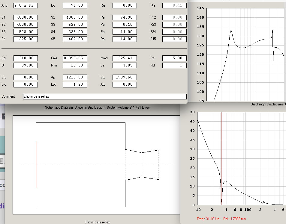

And another thing.... How the hell does somebody model one of those L'Acoustics ports like you posted above....?

It could be modeled in Akabak, and probably in Hornresp.And another thing.... How the hell does somebody model one of those L'Acoustics ports like you posted above....?
This model is lacking the proper parabolic/elliptic curve of the port, but gives hope that it could be done, though somebody familiar with the program could probably figure out how to do it.
This sim has Fb about 31.4 Hz, excursion about 12.5mm.
The 133dB peak would be less than the sim predicts, there is a "QL=7" setting that should be applied, but I missed where..
The Hornresp thread would be the place to get a better model suggestion.

I was reading something earlier and one member mentioned modelling it as a rear horn, I thought that sounded promising..
My WinISD thinks I'm in a rear chamber and I have to check the rear port velocity for my vent airspeed.

The KS28 bass reflex design (based on a Helmholtz resonator) is similar to L'Acoustics (and other's) use of laminar vents.Actually, while we are on the subject, I found this design as a starting point to the KS28 single 18" "mini-scoop" or whatever it should bee called.
And comes with a claimed 137.5 dB...... Wow !!!
Laminar vents are not really horns, though can be modeled as such. A "scoop" design uses a small volume rear (band pass) chamber and a relatively large scoop shaped horn.
The video sim with 137.5dB SPL has no reference to Fb, driver, power, excursion or loading (1/2 space, 1/4 space, etc.) so is not very useful, other than showing a recent example of laminar venting.
BIC introduced their “Venturi Port” in 1973, various forms of low-turbulence port shapes to reduce noise and air velocity are nothing new, but the increasing displacement of drivers since then has required far larger port volume to be linear at high drive levels.
Rounded vent can be simulated using dual exponential horns profile, the results will be very close from real use case purpose.

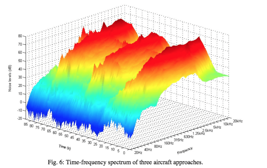

Maybe cheaper and safer to stand behind a 747 on take-off. Then a pair of tapped horns tuned to 16Hz seem to be what the OP would need perhaps
It would be about -6dB cheaper for "Databass" to use tapped horns, but he already stated his preference for "Front Loaded BR Subs" in the OP.
As far as jet engine noise, it rolls off in the bottom considerably, about -30 dB at 40Hz compared to 3kHz.
Jet noise at close range will tear your hearing up in a hurry- low bass takes much longer.
