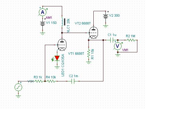

I am curious about plate load chokes. I have been studying them a little bit but I would like to understand more. I have corresponded with an expert in the field and he states that a good plate choke presents a back emf to the tubes plate AC voltage, increasing output voltage and effectively making the next stage the load since the impedance of the choke becomes extremely high. I am finding in my spice simulations that choke loaded plates make a tube pre amplifier have lower S/N than any kind of constant current source load that I can find. The difference is about 8 dB in my simulations, but it varies of course (based on the tube type and circuit). I intend to pursue this in real life when funds allow. What are your thoughts on plate load chokes?
Everyone likes pictures so here's a circuit I tested in Tina. S/N is some 126dB and gain is about 18dB. These things really shine when the gain is really high.

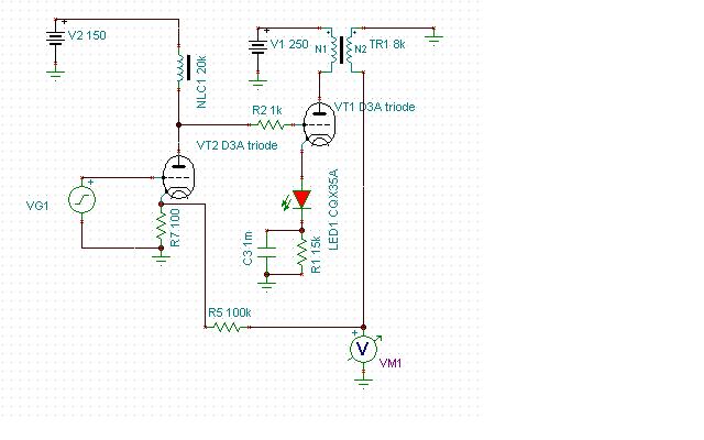

This one has a gain of some 55 dB, THD of 0.02% and S/N of 135 dB. I'm just scratching my head at these numbers because they are remarkable. How difficult is it to design the choke and transformer for something like this? Tube DC current is around 11 mA each. Xfr has a turns ratio of 4:1 step down.

This is only certain below the resonant frequency of the choque. Self plus external capacitances (really or virtual, like the Miller one) resonates with the choke inductance at a frequency, above which the inductive reactance becomes capacitive, then causing several loss of gain increasing frequency. The problem is the same as with transformers, except it hasn't pri' to sec capacitance.
I would opt for cascoded CSS (with up to 160dB PSRR rate) instead of massive and expensive plate choke. Additionally, plate choke will have quite high stray capacitance no matter what.
OK, great, thank you. So the goal is to make the resonant frequency (stray capacitance + inductance) outside of the audio range? How do you do that?
Also, based on your comments, it appears that it would be best to use a tube that has a low Miller capacitance, like the VHF frame grid pentodes D3A, etc? I already understand that this technique is only good for tubes that operate at relatively high DC current and have low Rp, like the D3A, etc. So, no 12AX7, etc. is suitable for this technique. Would you agree with that?
Further, so would you agree with the idea that the back emf from the choke makes the plate load so high that the load becomes the next stage in the amplifier (below the resonant frequency of the choke/tube combination of course)? If that's the case, then I think it seems obvious that to maximize the back emf you have to maximize the inductance of the choke. What other parameters for the choke are important in maximizing back emf?
