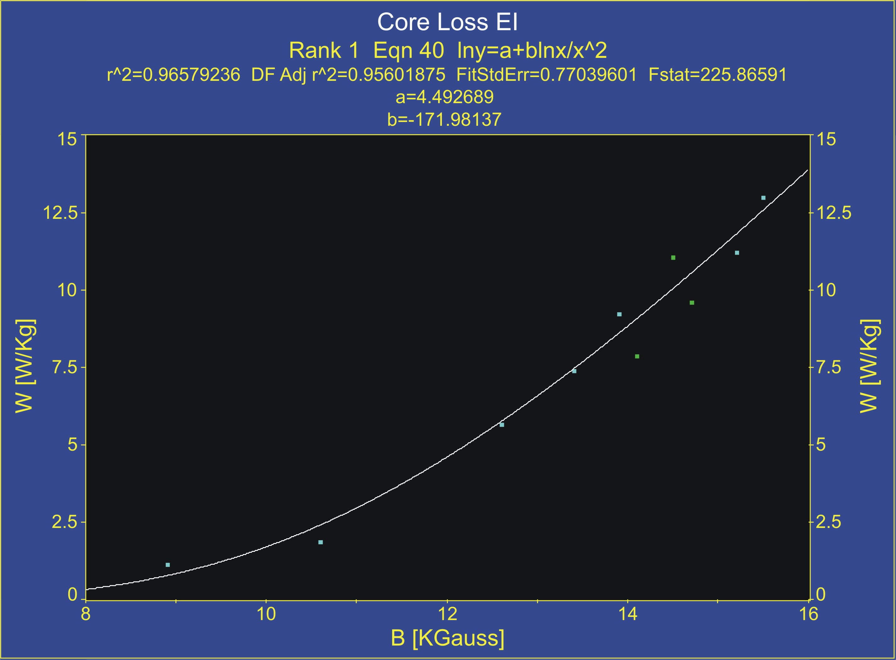

EI M6 GOSS vs C NOSS core loss, roughly indirectly measured @ 50 Hz ! 🙄
I'm designing a new experiment to make this measurement, my cores are bad, but not that bad...😀

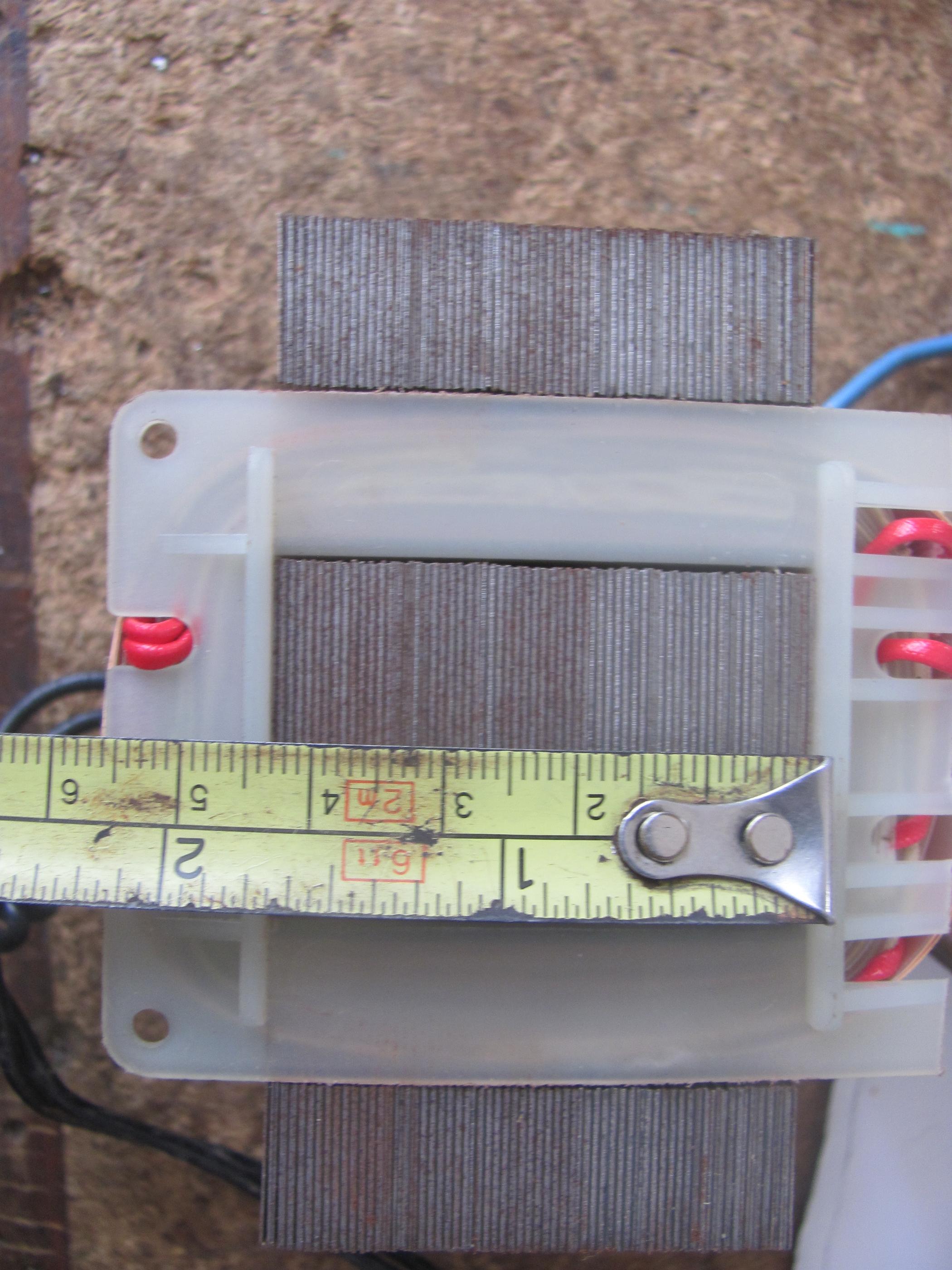

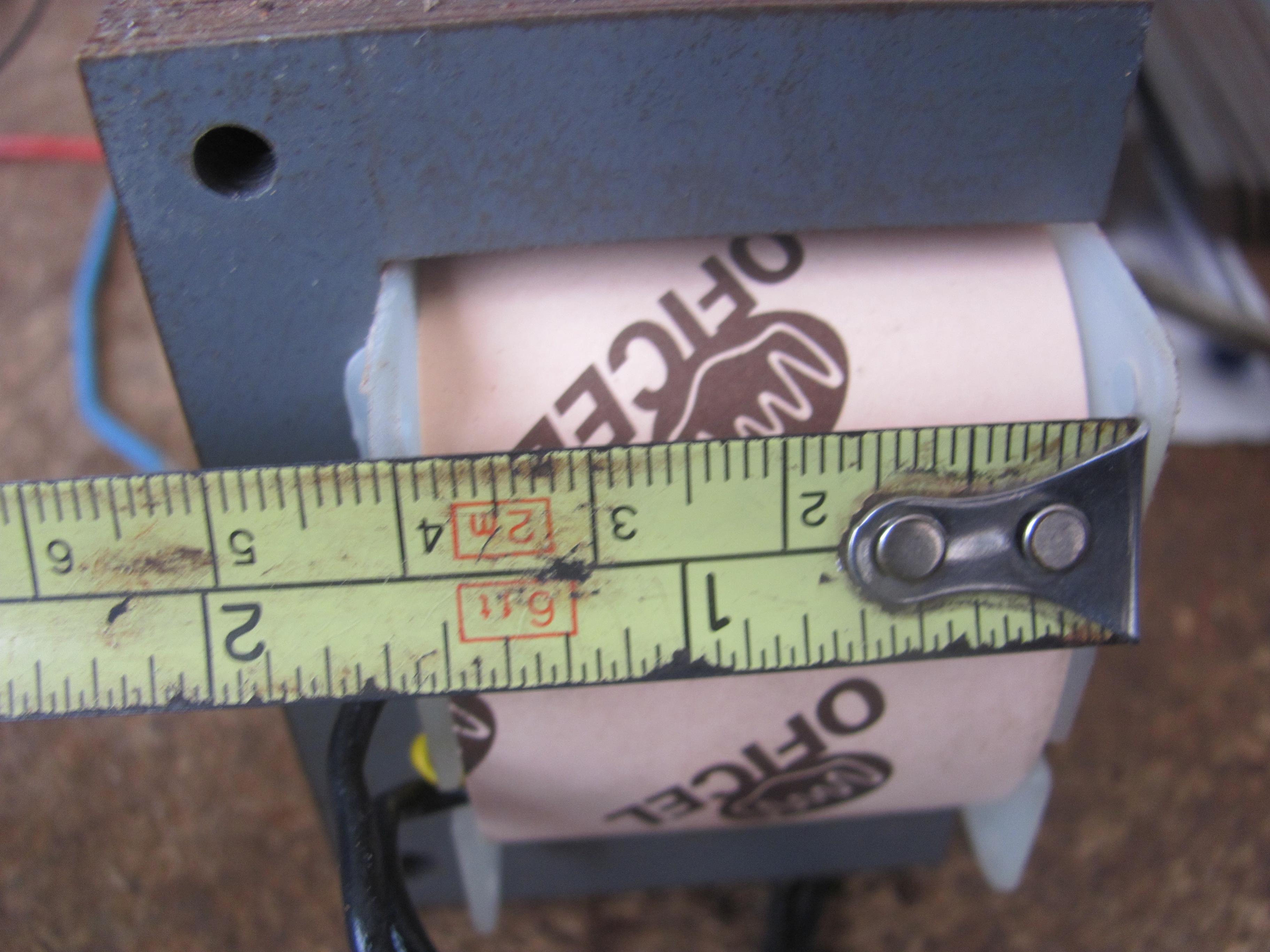

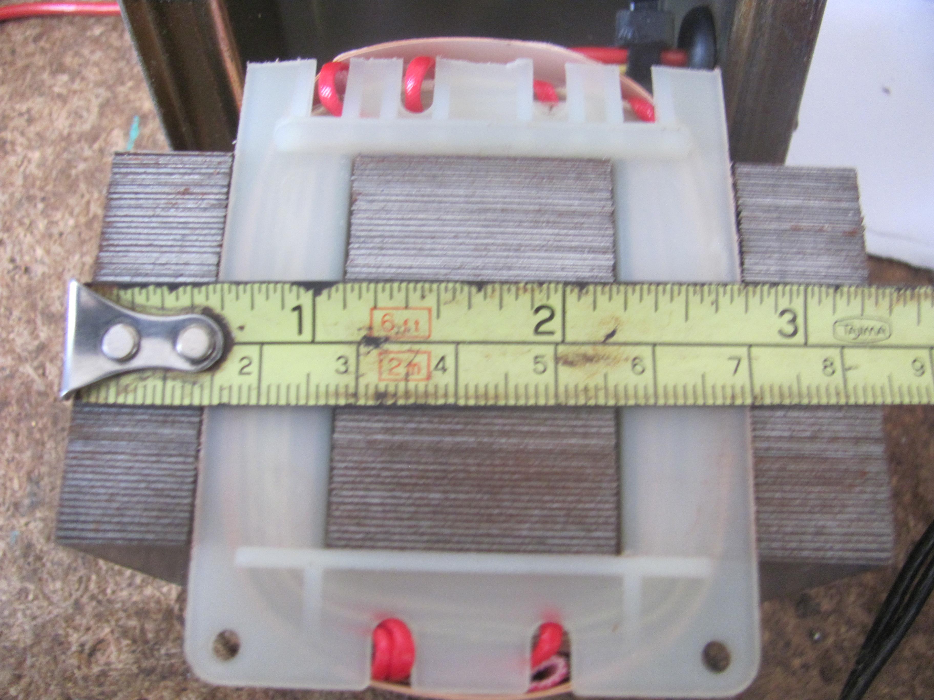

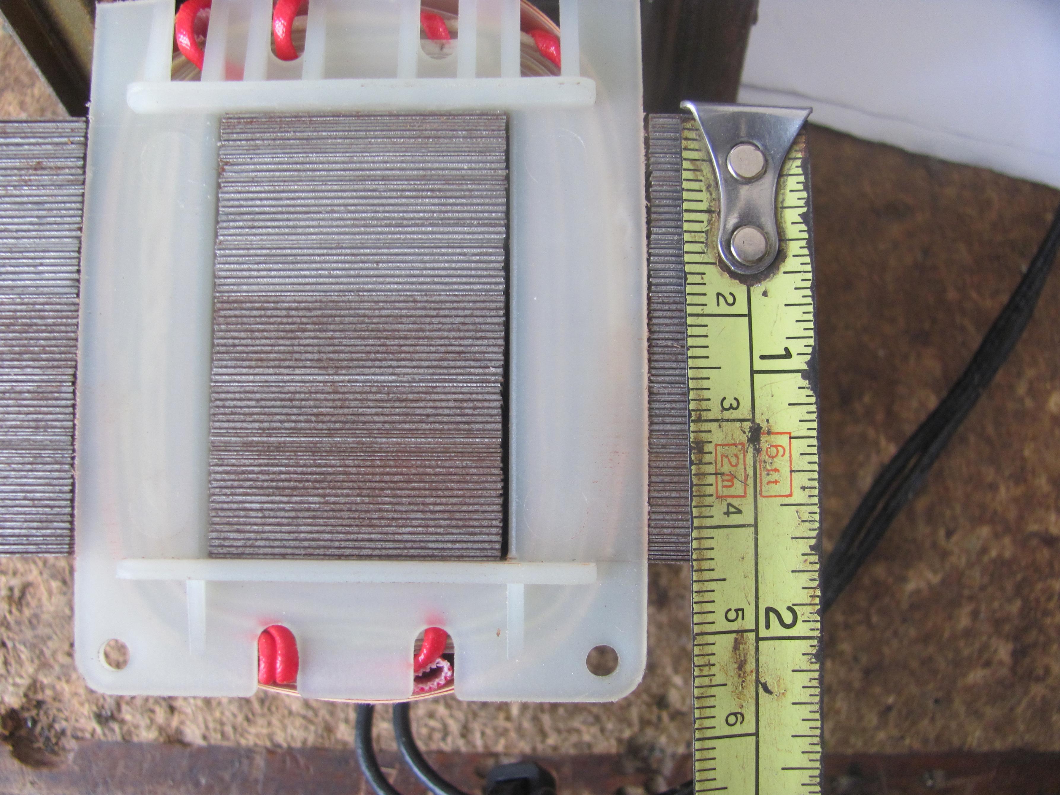

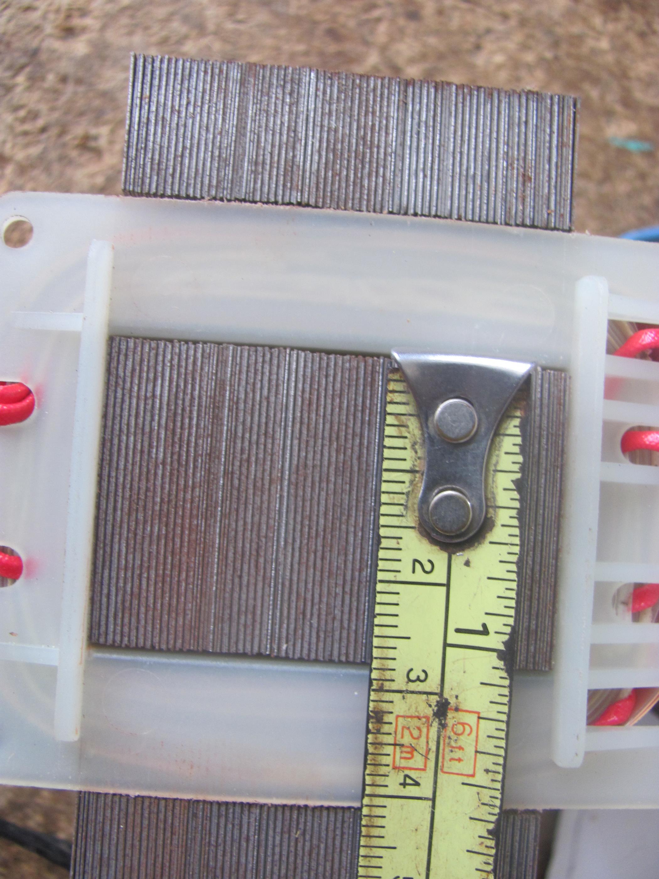

Hi, I do not consider myself as a specialist in transformers, but if you can put more info, maybe for tomorrow I can post a complete design as an example of how equations work.
I need: Primary impedance, power, primary DC current, lowest frequency and more details about core and coil former (geometry)
Ok...primary impedance should be 3K
Power 10 Watts
Dc current max 80 Ma
The core is M6 steel
The size is as i show in the pictures
Lowest frequency 20 Hz
Now...is it possible to make a transformer with this material?

Almost always it can be done, however your core is a bit small, surely will have a couple of compromises, give me time, I hope by tomorrow I will have all calculations.
No, I have little experience (Which may be why I will try to rewind the Magnavox transformer). This is not a high quality transformer like Harmon Karden or HH Scott, etc. It is a simple SE output transformer for an EL84.
Come on, I had seen your handmade winding machine, it talks for itself. 😉
With that skills, surely you will make an excellent transformer, I bet you will rewind both, because the new will sound better than the other. 😀
Definitely NO !. . .
Unless you accept to reduce your ambitions . . .
If you accept to limit the lowest frequency at 30Hz for full power (10W), it becomes feasible and will produce more than decent results at high end.
You'll still be able to obtain some 4.5 W "clean" at 20Hz.
In other words, it will be a 10W OPT able to go down to 20Hz but not both simultaneously 😎

Ok, i think 30 Hz is good enought for me, and now i only need to know how many turns of primary and secundary, and gauge of copper wire to use, and then i will ask a friend to wind it for me. Secundary should be 8 ohms.

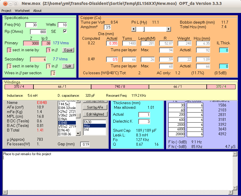

Is this the program you use Yves?
( i can check it now because i have an Imac computer)
OPT Calucator
OPT Calucator
So Yvesm, your computer says that i need to wind 1480 turns of 0,35 mm wire for my transformer? well, i will wait for popilin slow calculations !!!🙂Definitely NO !

Uac = √(P Zp) = √(10 x 3000) ≈ 173 VRMS
S = 2.86 x 4.3 x 0.9 ≈ 11 cm²
l ≈ 17.2 cm
Supposing Bac=Bdc=6500 Gauss
Np = (Uac x 10⁸) / [√2 π fo S Bac(max)] ≈ 2722
Ns = Np √(η Zs / Zp) ≈ 133
Bdc(max) = [4 π μ Np i(DC)] / (9 l)
We have i(DC) = 80 mA, so
μeff ≈ 368
Lp = (4 π μ S Np²) / (9 l x 10⁸) ≈ 24 H
lG = l (μ - μeff) / (μ μeff) Depends on your lamination
Is possible, only need to find wire diameters that fits in the bobbin, so copper losses is the only parameter to resign. 😉
Just give me more time to find a winding pattern too. 🙂

If your core is good, we can do
l ≈ 17.2 cm
Supposing now Bac=8000 Gauss, Bdc=6500 Gauss
Np = (Uac x 10⁸) / [√2 π fo S Bac(max)] ≈ 2212
Ns = Np √(η Zs / Zp) ≈ 108
μeff ≈ 452
Lp = (8000/6500) (4 π μ S Np²) / (9 l x 10⁸) ≈ 24 H
Patience please...🙂
