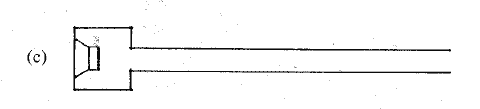

Augspurger defines a line geometry, where given the volume of the TL, you use a 1/3 of the volume for a chamber behind the driver and the rest of the volume for a line tuned to the driver Fs. This geometry improves the low pass function on the terminus vrs a straight line.
I always associated this geometry with a daline.

planet10 said:Augspurger defines a line geometry, where given the volume of the TL, you use a 1/3 of the volume for a chamber behind the driver and the rest of the volume for a line tuned to the driver Fs. This geometry improves the low pass function on the terminus vrs a straight line.
dave
Fris uses that same picture.
Can you spell it out for dumbo here?
"Given the volume of the TL..." Is this Sd*(L/4) where L is the wave length of Fs -- or what?
dave
Glancing back at http://www.ejjordan.co.uk/enclosures.html , it does appear that about 1/3 of the volume is in the box, 2/3 in the pipe.

GM said:How did he determine the Vb required to divide up?
Augspurgers lines are volume oriented. He gets a volume and divides by the length to get a cross-section (or average cross-section).
dave
