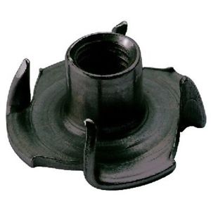

No screws, except to mount the drivers and the terminal plate and crossover board.
No screws but bolts and nuts like the one pictured.
