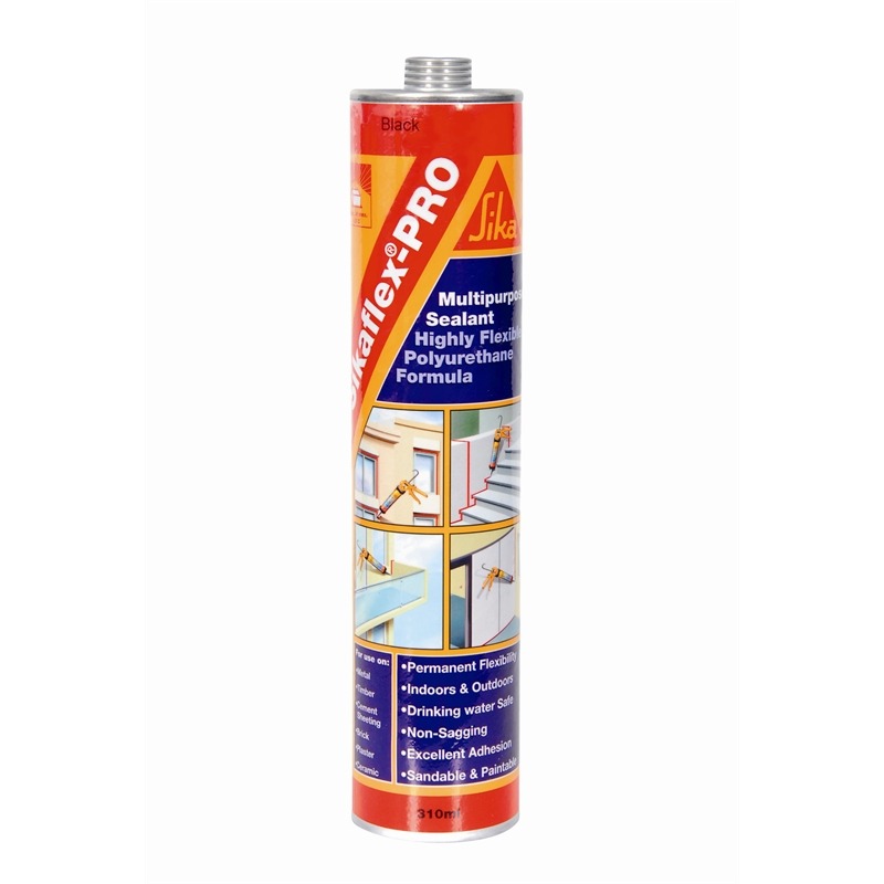

PU glue can be a blessing or a curse. It's excellent for building ie a horn enclosure because it expands and fills gaps, imprecise angles, it is not impressed by moisture after curing and glues almost anything very fast. But it prevents "zero thickness" glue joints too. I like to have a bottle of it at hand but usually the normal wood glue is the better choice.
Wait, I'm not talking about polyurethane glue as used for woodworking.
Not..
I'm talking about this..
I can't remember the type but Bunnings have two I can think of. The one shown here is softer, I'd try to get the other first but this will work. It's easy to test, just use two scrap pieces of MDF and after it sets, tilt it and drop a hammer on it.
Not..
