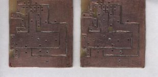

So far I found out:
Paper type is relatively irrelevant as long as use print nice black and fuse it good.
Toner HOLDS, you cant scrape it with your hand as long as it fused good.
This method better siuts projects with loose part placement, coz if you have alot copper space compared to that you'll etch, paper fibers will tent to clog those in-betweeen-traces-space and will not etch.
As for the first time, I'm satisfied.
Soldered boards commin in an hour.
