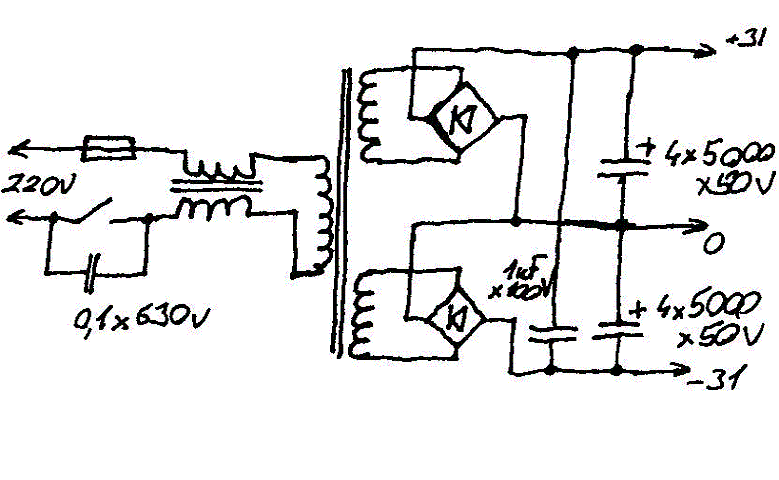

Picked up my tranny today, 100VA 2x24V with 2 full bridge rectifiers this gonna get me a nice 31V on each rail. I also think about putting caps on bridge diodes, as for filter caps I'll stick to 4-6 10000x35V (I'm not biulding a GC with 200VA tranny and 1k caps), they cost reasonably (for the cost of 1 22k I can have nearly 6 10k's). According to nationals formula for 50W @ 4ohms we need ~31V so we fit just right.

This is what I came for at the moment. Inverting amp with 22x gain. Havent decided on the vol. regulator yet, I think about putting a trimmer instead of a pot, but what value ? mm 20K will be enough ? :scratch:
PSU and decoupling caps are not shown.
Do I miss something really important ? Ugh, do I need a resistor between the ground and the non-inverting input or I just connect non-inverting to the ground ?

Your dc impedance from the - input to ground is 220k, (The input is capacitor-coupled so has an infinite dc impedance. To get the best thermal tracking of the dc offset you could put a 220k resistor from the + input to ground to match the dc impedance on both inputs.
My view is that 220k will increase the noise. Try it with a direct short from + to ground as you have at the moment. If the dc offset voltage is OK then you could leave it as it is.
(The other option is to put a 220k resistor, but bypassed with a capacitor.)
