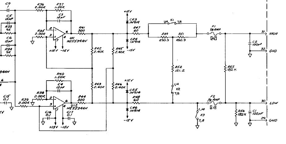

That is an active balanced circuit that will have a constant output even if one side is grounded. The cap is a problem in that application. Also when I played with it in sim trying to get 50 Ohms to work I never could. All the resistors need to scale for that to work properly (i.e. 1V into a 600 Ohm load is 1V even if one side is shorted). The plus is that its good at dealing with significant common mode which is why I pursued it. Attached is a simulation that I started from. The Lynx looks simpler and maybe i should try it. I don't think Mike Lynch added complexity without good reason.
Squinting at my board it looks to have caps. Jumpering is not too hard. The weakness in the opamps would be driving a lowZ load. The new ones from TI for headphones would be a good option but those are duals and the board is setup for singles.
This core of this is an interesting circuit that looks to have its genesis in the HP8903 circa 1980. The engineer (George Pontis) walks through the operation starting on page 10 of the PDF linked below. With the input shorted, a voltage can be applied to both the outputs and you can observe zero current flowing suggesting isolation (as long as you are withing the supply rails give or take). Pontis indicates the output stage on the 8903 had to be ground referenced given the number (roughly 30!) of digital control signals they had. So, rather than the obvious approach of an isolated supply and digital isolators, Pontis came up with this circuit and kept the output ground referenced but allowed it to float.
Starting around 2015, a range of very cheap and simple push-pull ICs emerged to generate isolated supplies. Power was limited to a watt or three, but they run open loop and rely on a very tightly spec'd transformer with a clearly spec'd lower bound on volt*time product. Around that same time, some very economical digital isolators also appeared. Taken together, it became very easy to move a lot of digital signals across an iso barrier and generate a true 2-3W isolated supply with several kv of isolation.
Given the launch date on the L22 (2002?), there probably wasn't an economical way to generate a true isolated output, and so falling back to this approach made sense. But no idea why they added all the other stuff around Pontis' original core. What usually happens is a first product uses the circuit, and then that engineer leaves, and the new engineer doesn't quite understand the circuit and encounters a problem, and they starting adding caps to try and make the circuit behave. And later that person leaves, and the next person is even more confused at what they are looking at in the product evolution. But they don't dare touch it without understanding it, and so they replicate it with some tweaks and hope it works. Maybe that happened here and that's how it morphed from the original.
https://www.keysight.com/upload/cmc_upload/All/EPSG085898.pdf
