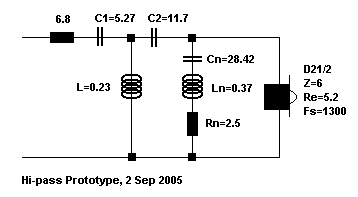

This morning I designed a 3rd order crossover using a notch filter for my Dynaudio D21/2. Like always, I rely on my golden ears (huehehe 😛). I don't trust formulas, and I don't have the tools to measure the tweeter (even the must-have LCR-meter 🙁), except for the information I found on the net covering the Fs of 1300, Z of 6, Re of 5.2 and a sensitivity of something.
Okay, I trust formulas a bit, so I use the basic formulas for impedance, and use 5.2 as a 'design' impedance to predict the location of tweeter resonance for the notch. Of course, I need the formula just to help me locate the starting trial CL values. The rest is on my ears (Can you imagine what speaker this going to turn out to be if I'm deaf 😀)
So, for a few days I'm going to listen to this filter. Not perfect but listenable...
R input = 6.8 ohm
3rd filter C1/C2/L = 5.27uF / 11.7uF / 0.23mH
Notch C/L/R = 28.42uF / 0.36mH / 2.5ohm
The inductance is approximation (but close!) as I unwind inductors without LCR meter.
You may ask, why is this 6.8 ohm located before the filter? That's art. That's the benefit of not having the necessary tools for speaker design 😀, so I don't care how to calculate the real impedance, or the rate of the sensitivity padding (to meet that of the woofer). Whether it is equivalent to put this R before or after the filter, I don't care, as the major purpose of the R is to create a notch/zobel related to the woofer.
So now I want to elaborate the effect of changes to a few components on the above network.
C1 (5.27uF) is the first filter determining the roll-off. C1 should 'lock' the woofer, with phase issue as the major problem (I'm not sure if what I usually hear is phase, it's just it).
Just about it's highest value, C1 changes (increase/decrease) can be easily heard with woofer on. Decreasing C1 (a bit! about 100n) will create a 'gap', or 'disconnection' with the woofer. Increasing C1 (a bit! about 100n) will create an 'overlap' which will be more audible when there's a phase issue. The common effect is loss of sonic and no enjoyment to music. If this C1 is too small than what it has to be, 100n difference may be in-audible.
L (0.23mH?) is the inductor parallel with the tweeter. Usually I unwind inductor and design for only one channel. For the other channel, I tried to unwind second inductor such that they will have equal winding (except when LCR meter is available). Trust me, with similar winding they always sound different!

Cn (28.42uF) is the capacitance determining the lowest frequency of the signal to be padded in the notch filter. I could hear the effect of an increase of 0.081uF and a decrease of 0.0899uF! How come??? Well, it depends on the critical instrument sound just about that frequency, or the critical resonance just about that corner. This notch filter might only cut half of the bump toward the higher end, leaving another 'minor' bump. Flat response and impedance is never my objective anyway...
R input = 6.8 ohm

that's where I'm at now
- Design calls for .7mh, is .68 OK?
