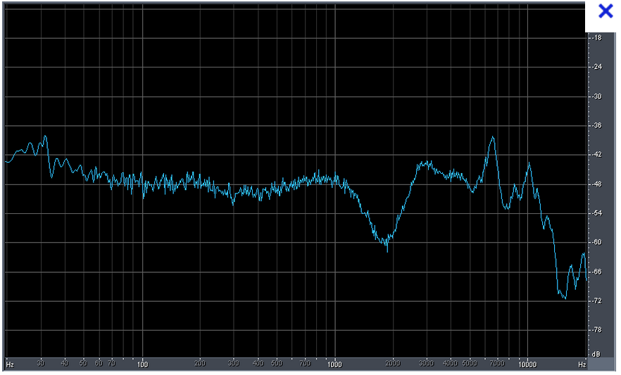

There are privately produced FR results.
Of course Bose wouldn't publish their own. They rely on the research that has shown that people prefer certain frequencies over others and tailor their sound to it. Nothing wrong with developing a people pleaser is there?
My beef with them is not related to the tailoring, far from it. I think that is the one thing they should get credit for. No sir, my beef has to do with the parts and production quality. Anyone who has worked on or even just disassembled a Bose product knows what I mean. I think it's near criminal to represent it as a quality product.
You have seen this no doubt?
http://www.intellexual.net/bose.html
