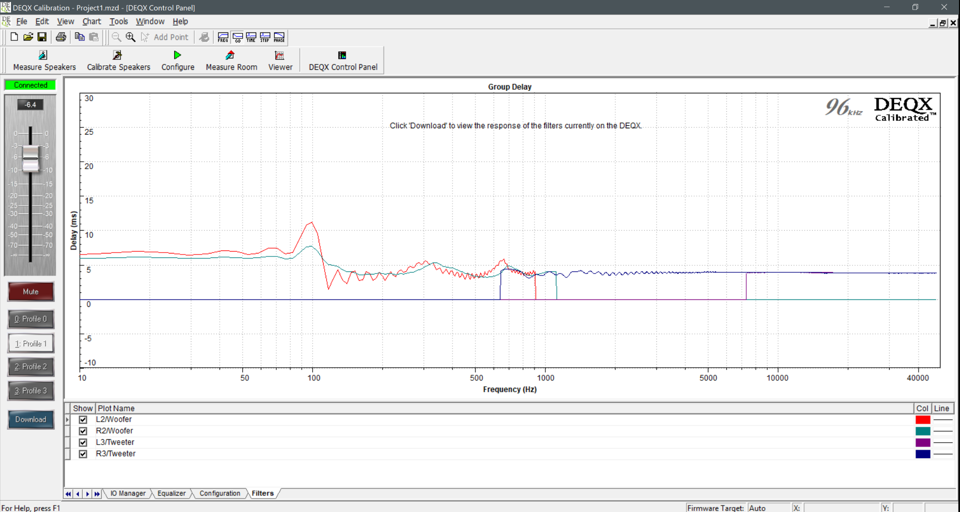

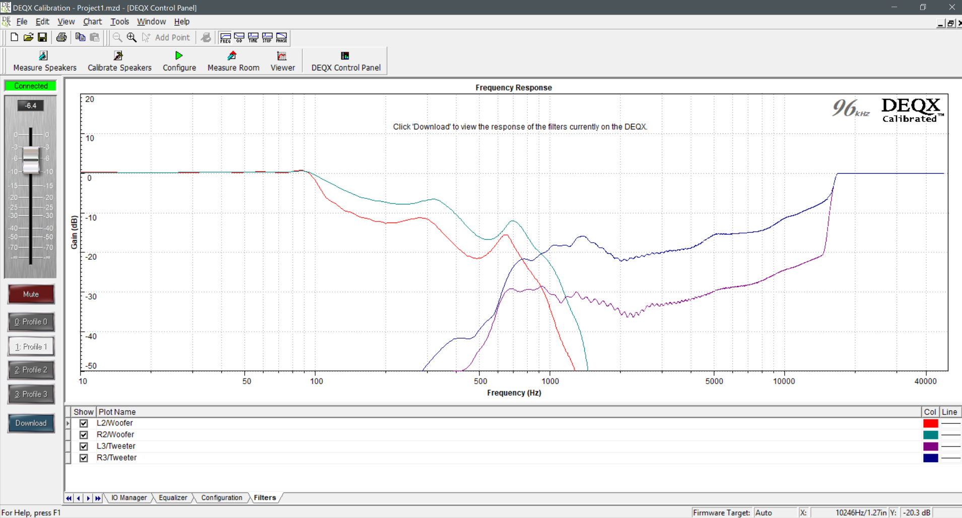

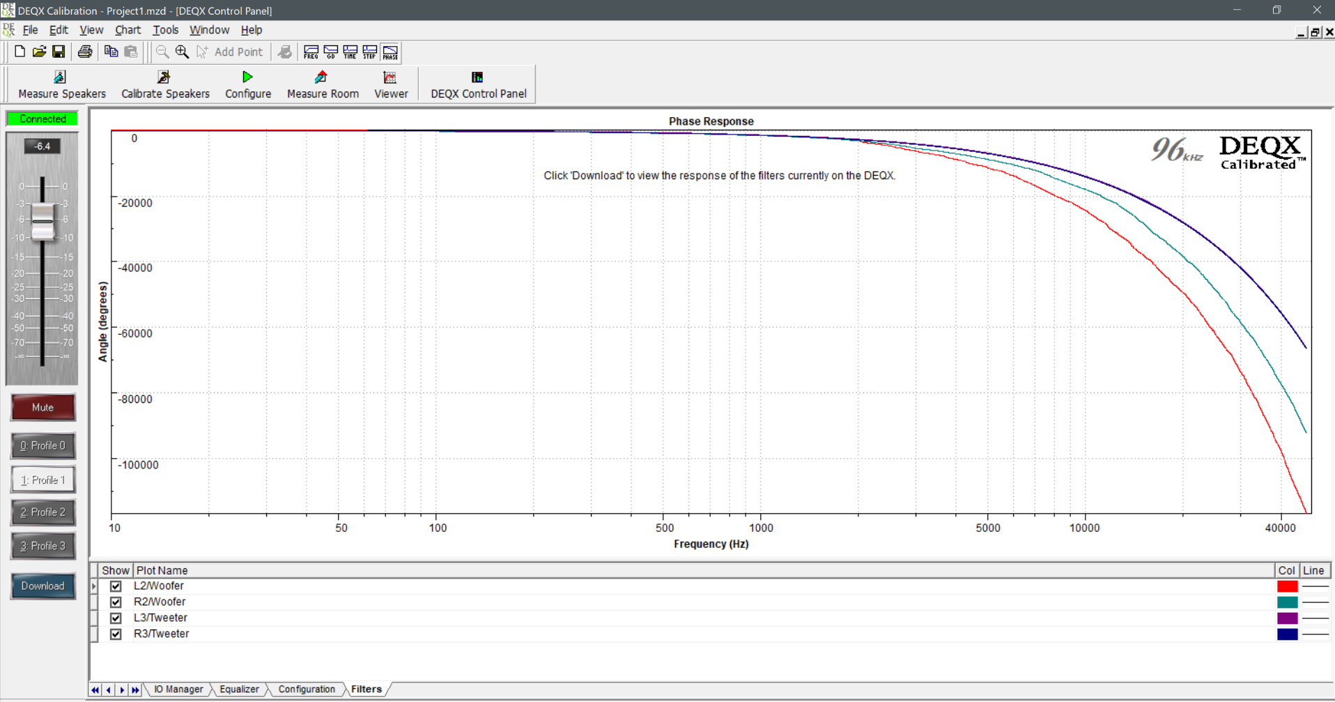

Hi SMathews, so the reason is dependant on the type of setup you run. But I'll
give you an example based off of my setup. I've learned alot already just dingling
with this DEQX thing and it sure is fun 😀
So right now I've just got the two Nathans which have quite sensitive speakers so the DB is
ALREADY quite high, so you would need even more power for less sensitive speakers.
FIRSTLY... the cuts to shape teh eq on my speakers go as low as 30db. SO presumably
youneed enough amp to boost up those lowered portions that you're making up for.
THEN.... the other issue is I had a horrible buzz going straight from the DEQX into my amp. Its 75 ohms output so that shouldnt be the issue.
What I disovered is its simply the noise coming from the unit itself that needs to be attenuated. I use a high end power conditioner
and it still wasnt enough to deal with the problem. So I got some sescom
20db and 30db attenuators to put between DEQX and amp...problem solved! Hiss is
practically inaudible now, BUT... I'm down a whopping 50-60db from peak volume.
So fully cranked I can JUST eek out enough volume to be enjoyable, And thats WITH compression drivers that are 107.5db sensitivity
with 250WPC into 8 ohms! but what I hear now is better than I've ever heard, at least in my system.
Very low noise, inky black background but with the bass and mids simply being "there". I'm a believer in EQ now.
I simply dont think the setup I have now would be possible with a simple knob unit. The
interface and setting I have had to be visually tuned in with graphs and bring speakers
to their absolute limits. For example I'm crossing over the de250 CD at 700hz. AND
its a very shallow slope. Finding that without a visual interface and making it flat, I
just cant see it happening.
