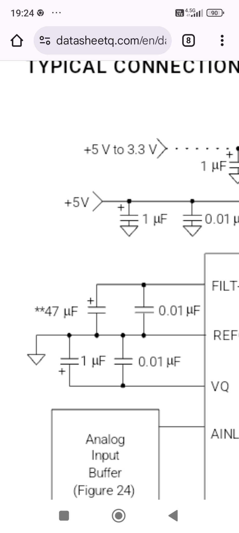

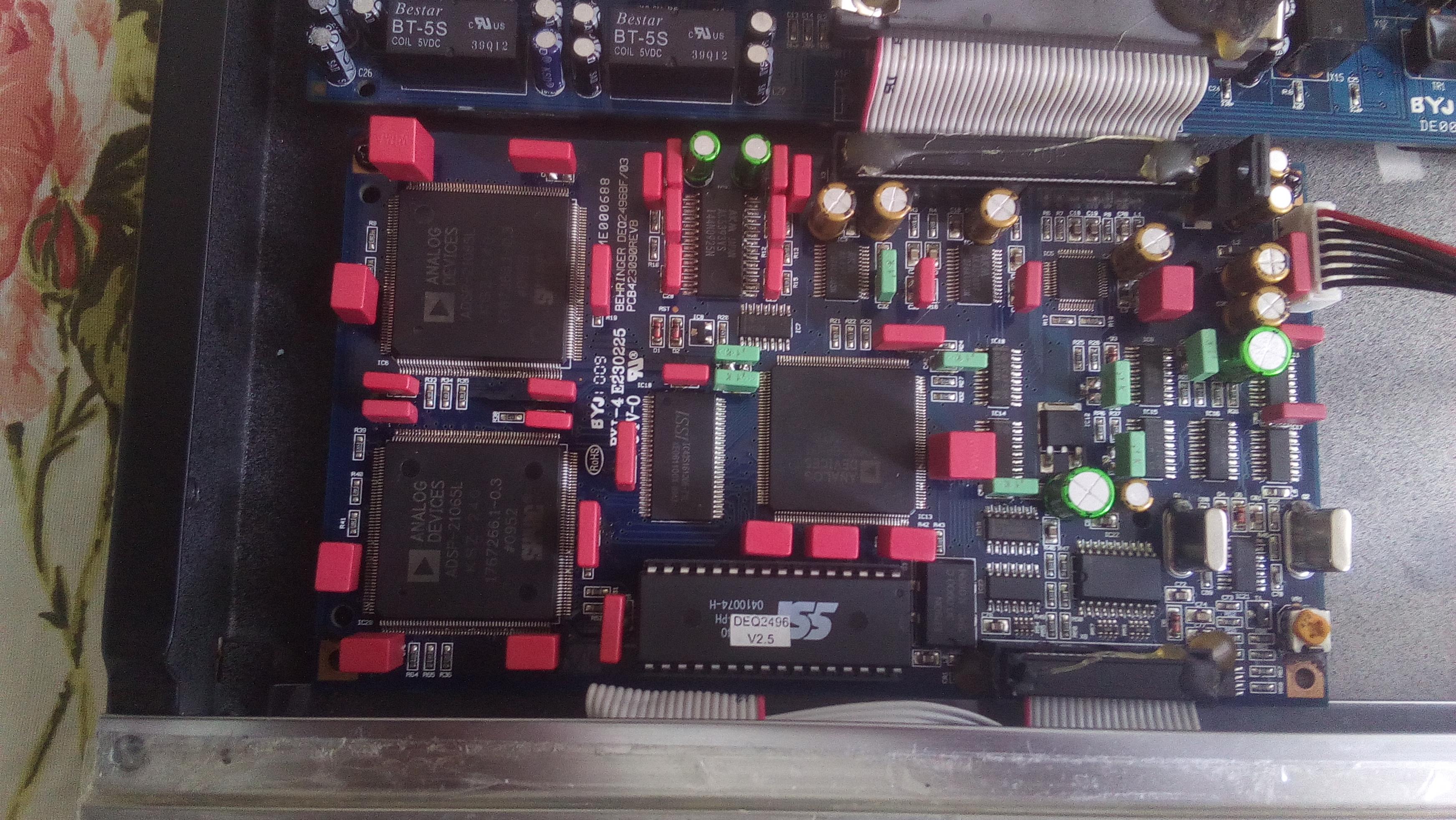

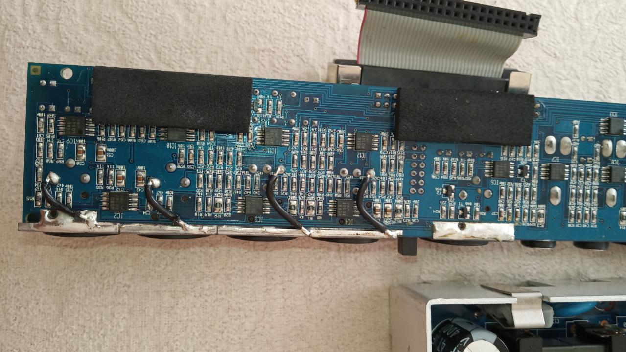

I will be recapping and upgrading the opamps on my recently purchased DEQ2496.
I noticed that the digital board is v2.5. Based on the rigorous work of stef1777 of diyaudio and awdiy.com, I noticed that my board layout was different from the photos and descriptions he provided.
As such, I believe this may be the first DEQ2496 mod featuring the v2.5 board.
The AKM AK5393 ADC has been replaced with a Cirrus Logic CS5381-KZZ and the capacitors around this ADC now include a few 1uF 50V radials which were absent on the previous layout.
See attached photo of the digital board. I have annotated some of my plans, including how I plan to follow stef1777's suggestions to piggyback 10uF 10V OSCONS on some of the ceramic caps. It seems as if there are actually several more candidates for similar piggybacking or outright replacement which I have left without annotation.
I am excited to increase my electrical engineering knowledge as I am an economist by trade so I do have one initial question for the gurus of diyaudio - looking at frequency coefficients, it seems that 50V capacitors have higher (worse?) frequency coefficients versus their 25V cousins (usually on a datasheet you can see both variants side-by-side). I find it odd that there would be 50V caps on this board, especially when it seems this is the first time 50V caps have ever been used on the DEQ2496 (at least on the digital board). Can I use 25V instead? I know this is not a simple question, but perhaps my detailed photo and the experience of this community can help me answer this question.
Thanks!
(I have mostly settled on Elna Silmic II caps for the analog board's 47uF 25V caps, the (ridiculously) more expensive Panasonic OSCONS for the 10uF 25v caps on the digital board, and PPS Film caps for the 1n5, 2n2, and 390p ceramic smds. If I'm feeling sadistic, I may replace some of the 100n and 100p smds as well. There are a few others, for example, stev1777 suggested replacement of C1 10uF 25V on digital board with a 22uF 25V and 2.2uF 50V that I will need to choose as well - <strike>assuming that v2.5 C1 cap is the same as v2!</strike> *there are differences because the ADC is different, see post #12)
I have also included stev1777's awdiy.com picture of the v2 board so you can see the differences (at least some of them).
I'll leave the analog board for a separate post in this thread.

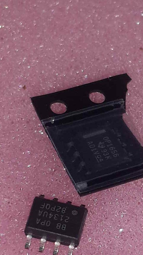

ÒPA1656 is the latest, the cleanest, lowest distortion, lowest noise. A no-brainer!
