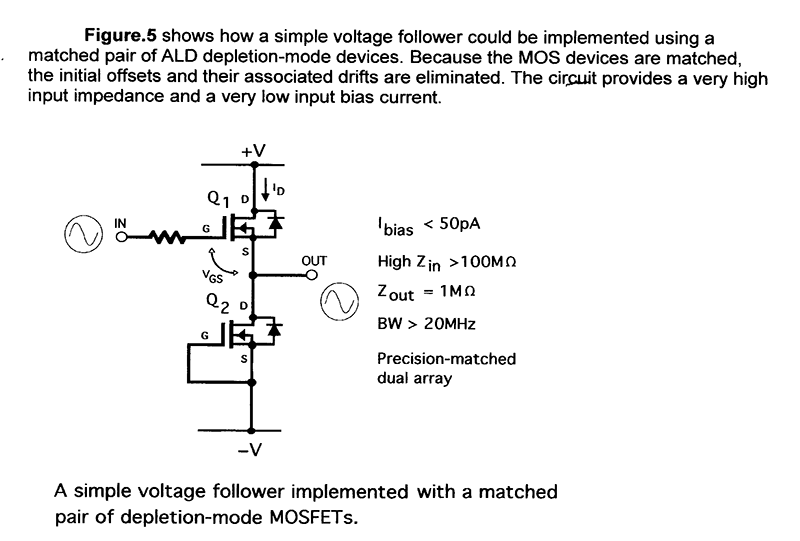

You need to thermally couple both devices through a heatsink to reduce DC drift.
Can of course be done, need to plan upfront.
Or add a DC Servo as in the Tubecad link :
https://www.tubecad.com/2004/blog0023.htm

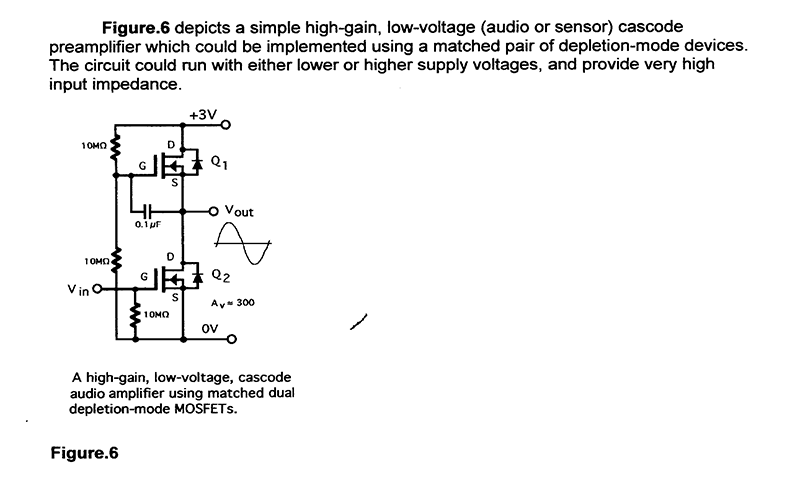

But I prefer LU1014 cascoded a la Zen V9, biased at 200~300mA.
Just need to simulate first to find the optimum bias.

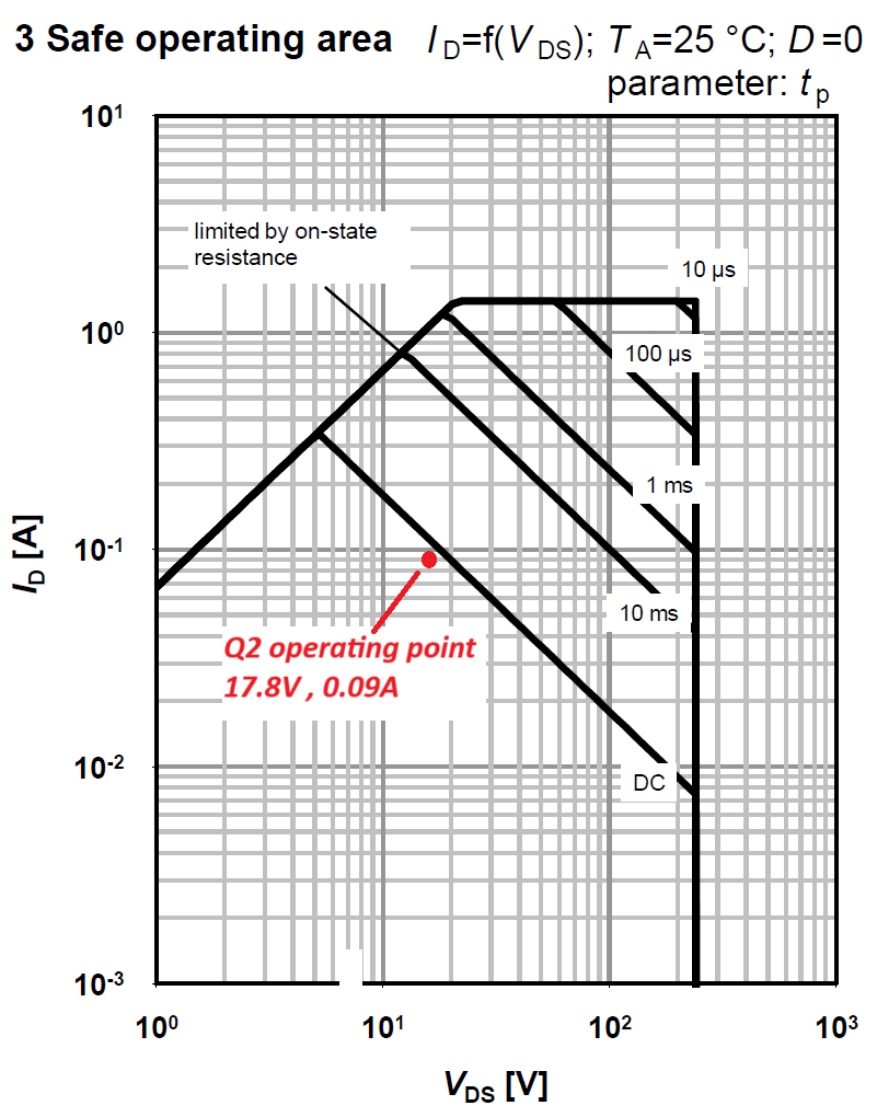

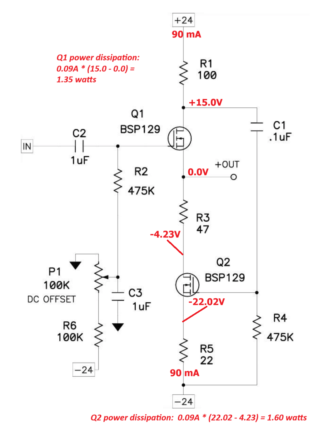

Here is a little buffer using depletion mode BSP129 SMT MOSFETs.
It will drive low impedance loads at .000% thd range. Frequency response is very extended to video range.
It needs some heatsinking or lots of copper because the current is close to 100 mA.
The circuit is the old White video buffer with silicon.

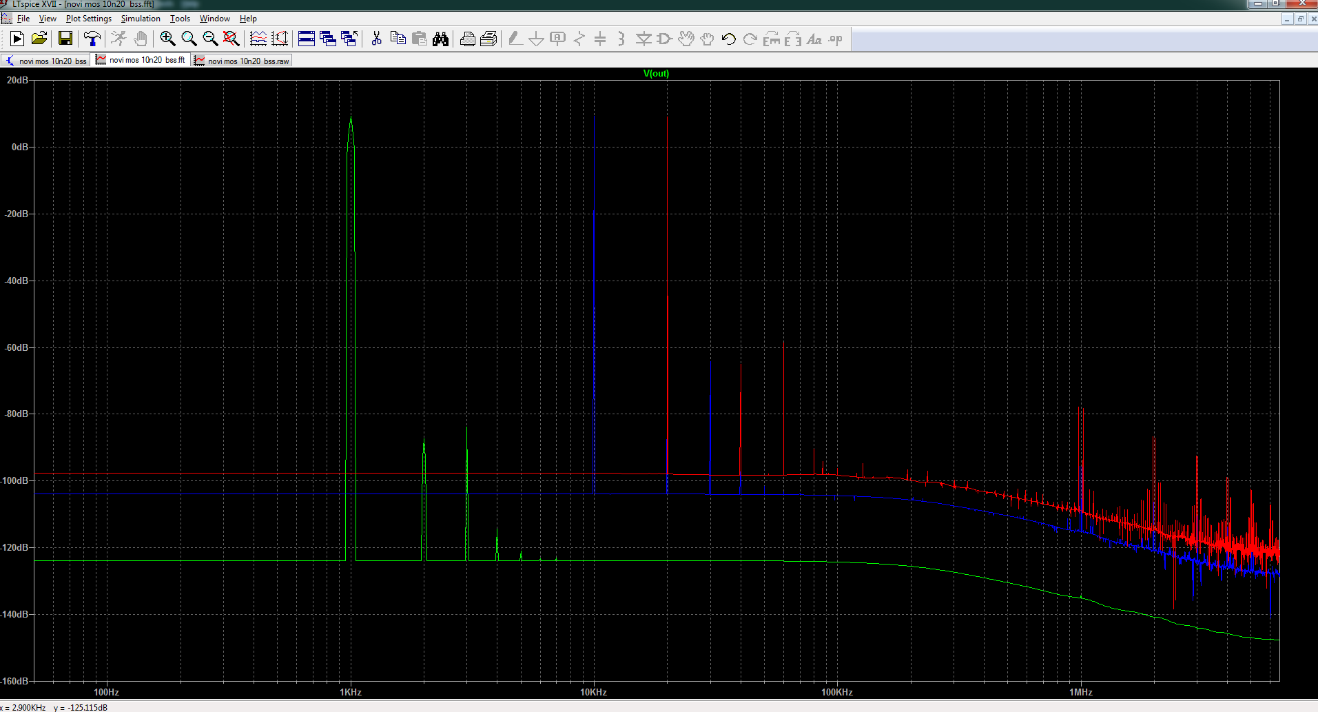

Great idea. I have a couple of amplifier schematics and I/V stages with depletion mosfets but for now only in LTspice. The picture shows the FFT of a simple CFA A class amplifier with two depletions, two bipolars and two laterals at a power of 1W into 8ohms.

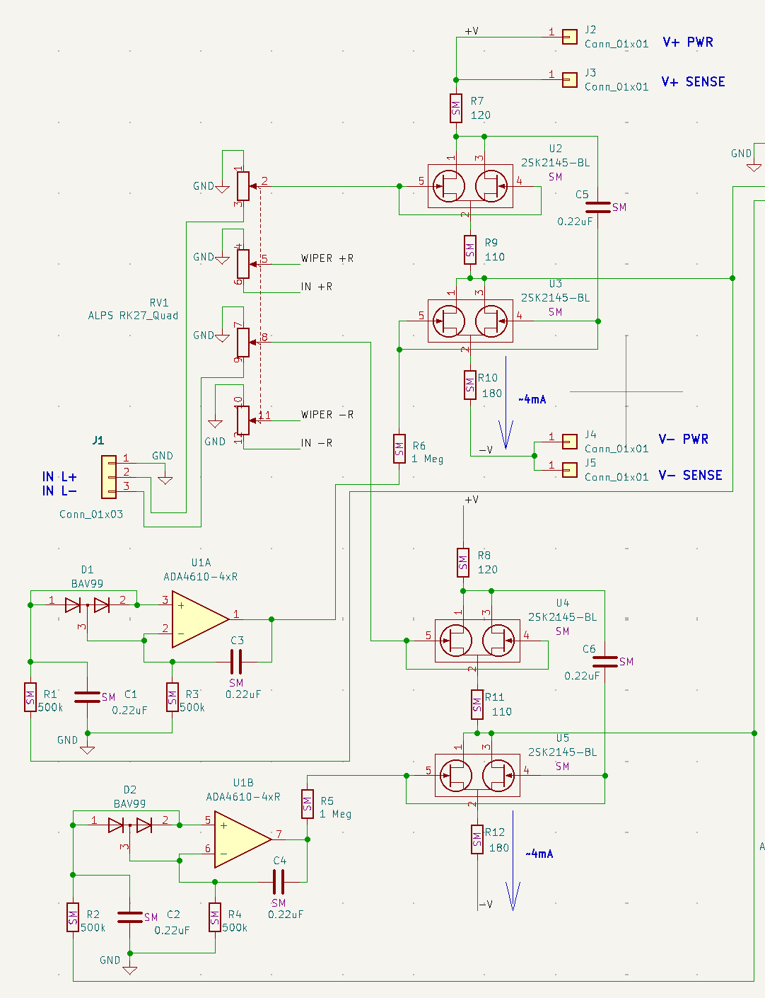

I've had this on deck for a while, one channel balanced. I haven't built this version yet, but have tested several without feedback or the servo where I used DN2535. The Toshiba JFETs here simulated better, as I recall, but the Supertex parts are amazing for distortion and BW.
