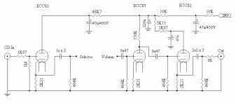

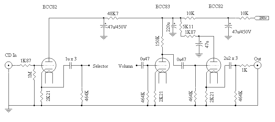

That schematic sounds like just the thing. Is that a Jadis ? (picture's tagged Jadis) Just surprised but hadn't read up on their stuff in ages, used to hear about them in audio mags.

Is that a Jadis ?
Yes, Jadis DPL preamp. Use old carbon comp resistors and leaky paper in oil coupling caps and connect this preamp to your clean amp...it won't sound clean anymore. 😀
