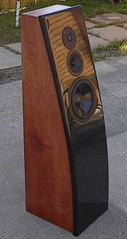

Would the use of a heavy hardwood have any negative attributes or drawbacks(other than expense) in the construction of the super v(open baffle design) side panels and baffle? Would it be to resonant as compared to mdf or hdf? What is the maximum thickness the side panels should be? contemplating something like a dense rosewood....or not sure just a brainstorm at the moment. also anyone know of a good source for exotic lumber?
super v pics:
Super V pics...
New Super-V model (that is going to the show) with pics!
super v pics:
Super V pics...
Would the use of a heavy hardwood have any negative attributes or drawbacks in the construction of the super v(all open baffle) side panels and baffle? Would it be to resonant as compared to mdf or hdf? What is the maximum thickness the side panels should be? contemplating something like a dense rosewood or Lignum vitae(iron wood) not sure just a brainstorm at the moment. Also does anyone know of any good sources for exotic hardwood?
