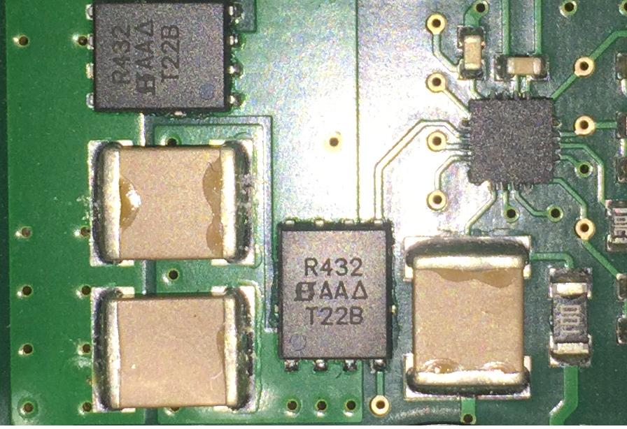

Also check chip capacitors for damages like in the following picture (for example). If any of these smaller caps are damaged, many essential functions like the PLL etc. may not work properly. Also confirm what sampling frequency you switched inputs to, when this happened. Maybe the oscillator is damaged. Expensive boards sometimes have one each for the 48kHz and 44.1kHz families.
