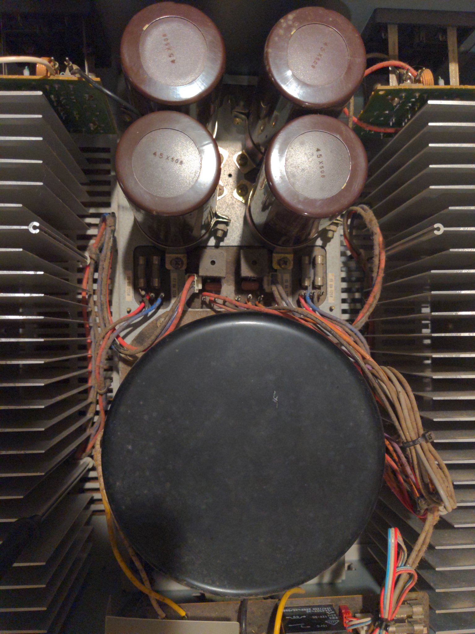

Hi All (First Thread). I am not very fluent with electronics but I am hoping for some guidance troubleshooting my amplifier. It was working before I opened it up to replace an RCA input jack. I did that and blew out considerable dust with compressed air. Now it stays in protection mode. I have a multimeter and downloaded the PDF for the amp. Where should I start?
Check for cold solders. You may have damaged some pre-cracked solder joints while blowing out the unit and/or touching something during that.

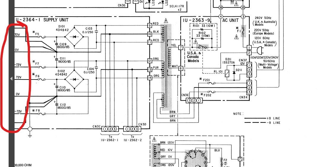

I'll try these checks. Thanks. If I can ask some novice questions... How do I know if I am measuring before the relay? I would have thought to just measure where I connect the speaker wire, but that must be after any relay? How do I identify supply rails? Will I be able to identify cold solder joints by just looking? Should I pull the circuit boards out to inspect?

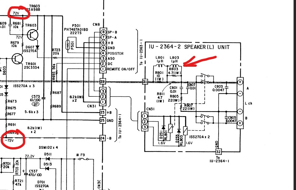

Try and disturb it all as little possible initially. The supply rails are all the voltages produced by the power supply to supply the various parts of the amplifier.
DC offset can be measured here (arrowed) and the - and + 72 volt rails are just two of several but these feed the main output stage. Check the offset first. It should zero volts DC.
( be very careful not to short anything when measuring voltages)
Its difficult working from photos tbh. You need your black meter lead on ground and just measure with the red lead to any of those resistors or coils (L801, L803 or R801, R803). All will show the same voltage whatever that might be.
All you are doing is measuring the voltage on that line between connectors '29' and '31' and those components looked the easiest way to get easy access.
So 9 volts shows a problem if you are measuring correctly.
If both channels have the same sort of offset then that shows a common issue which could be power supply related.

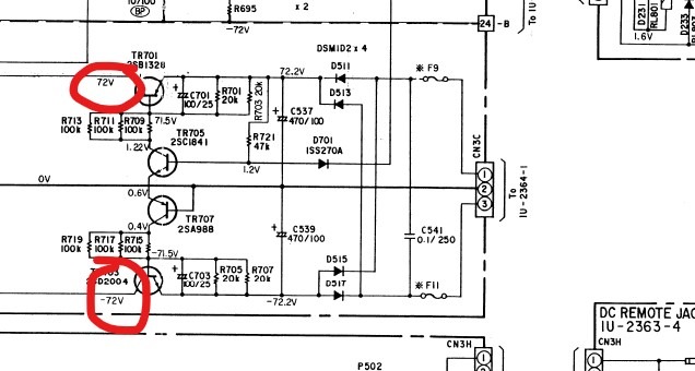

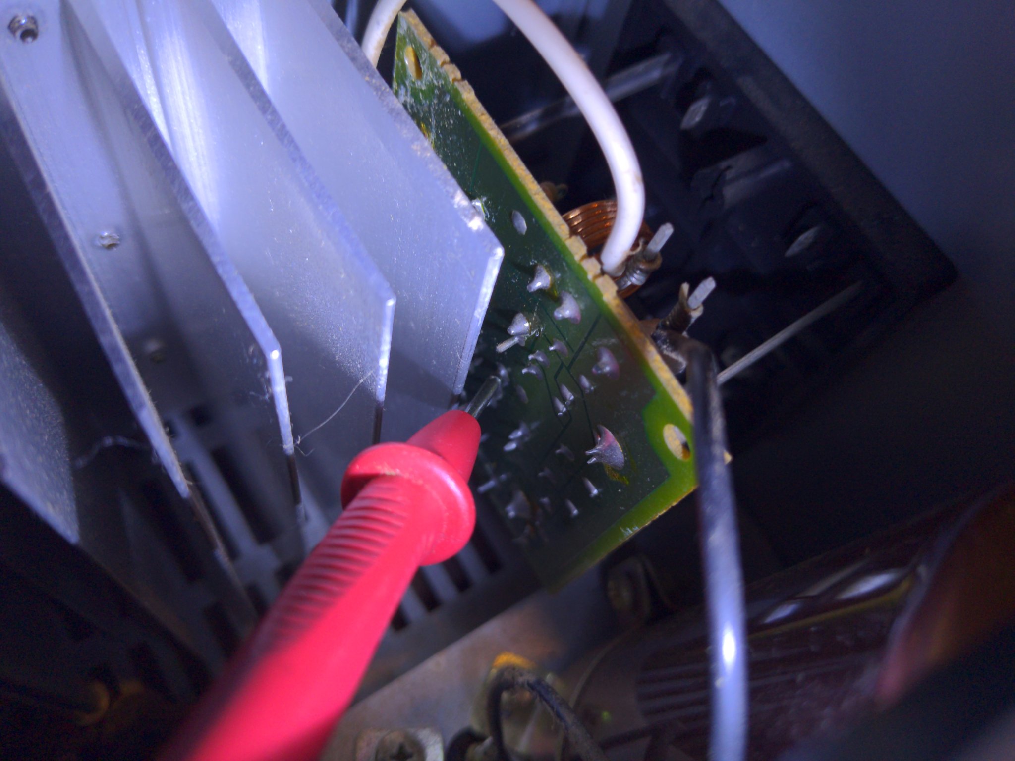

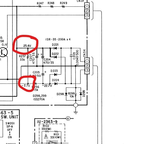

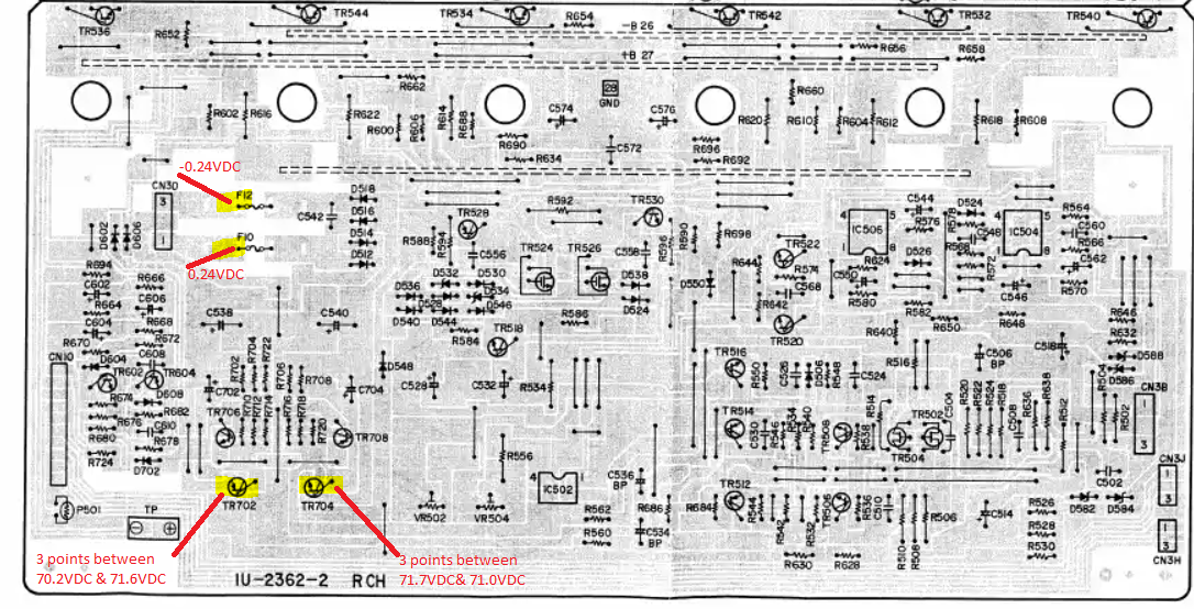

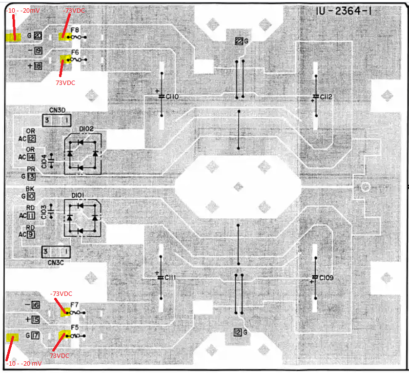

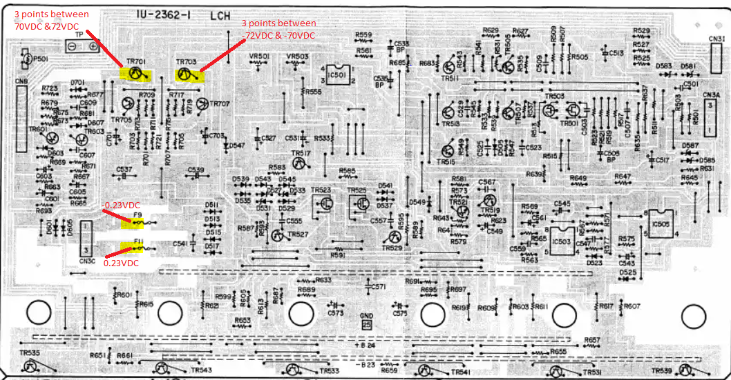

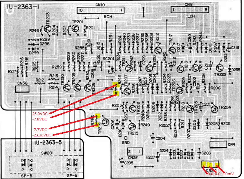

Alright Mooly. I checked the fuses using method 1 above. All are good. I attached the circuit board diagrams here instead of the schematic so you would know exactly where I put the probe when I took the measurements. Does this make sense?
First image looks OK with correct plus and minus 70 volts. You have 'no' voltage on the fuses because you need your meter on AC volts for that. They must be OK or the 7 volts would be missing.
Second image. The devil is in the detail and I assume TR704 voltages are negative 70.
Third image looks OK.
Fourth image looks OK.
So all the main supplies look good and yet you have that 9 volt DC offset which I think was on both channels? That's really important because it suggests something common to both channels.
I'm struggling to see anything that fits in with that tbh. One channel yes but not both.
Another idea given that nothing went back or smoked. Is it possible something has gone amiss with the socket you replaced such as missing ground or disconnected plug somewhere? I'm just thinking that maybe the fault isn't so much a DC offset as perhaps an unwanted AC signal of some sort, perhaps low level oscillation that could be asymmetric and so appears as a DC offset.
Most DC offset faults would just bang up hard against a rail and so 9 volts is a bit of a non standard fault scenario.

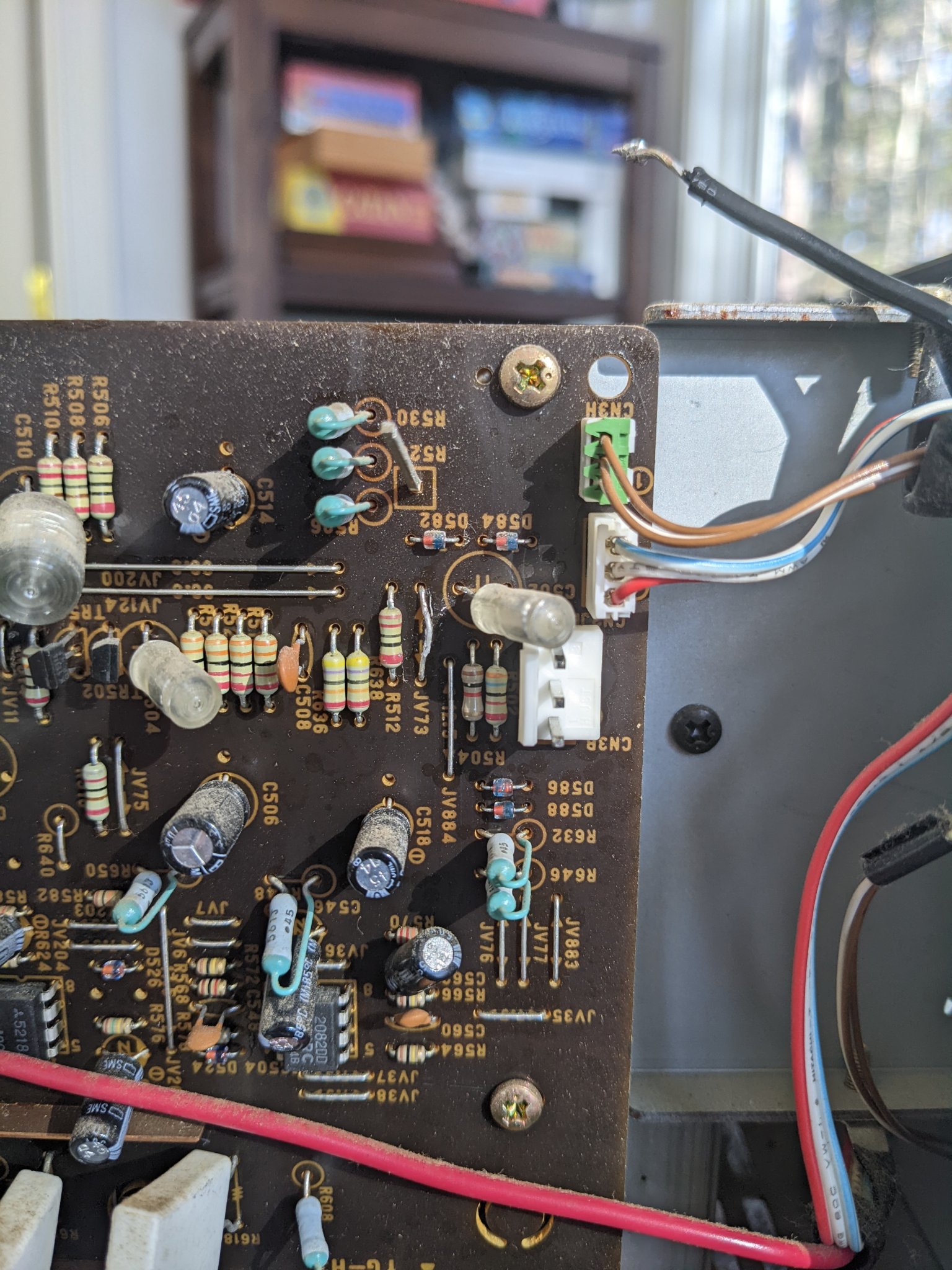

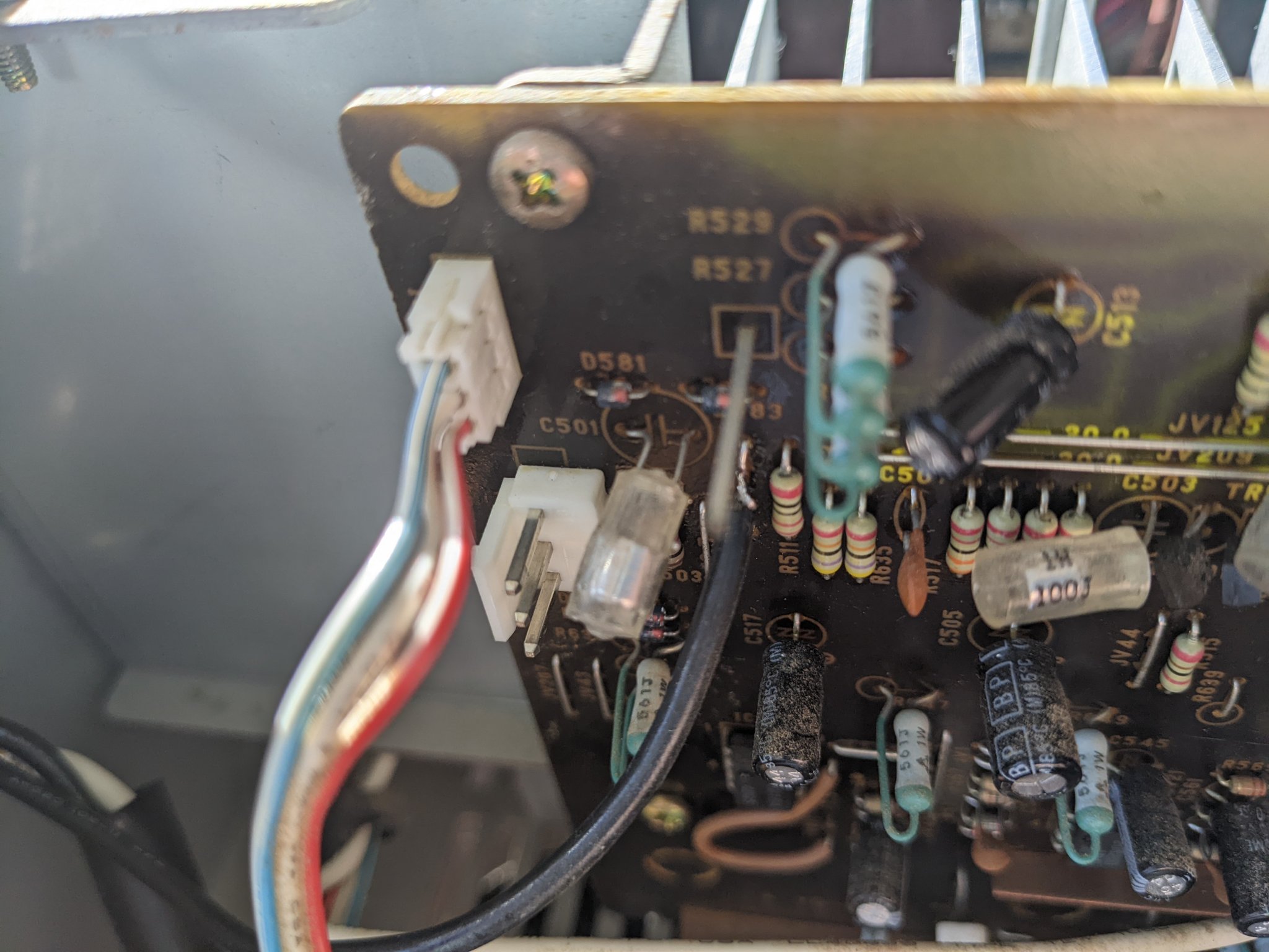

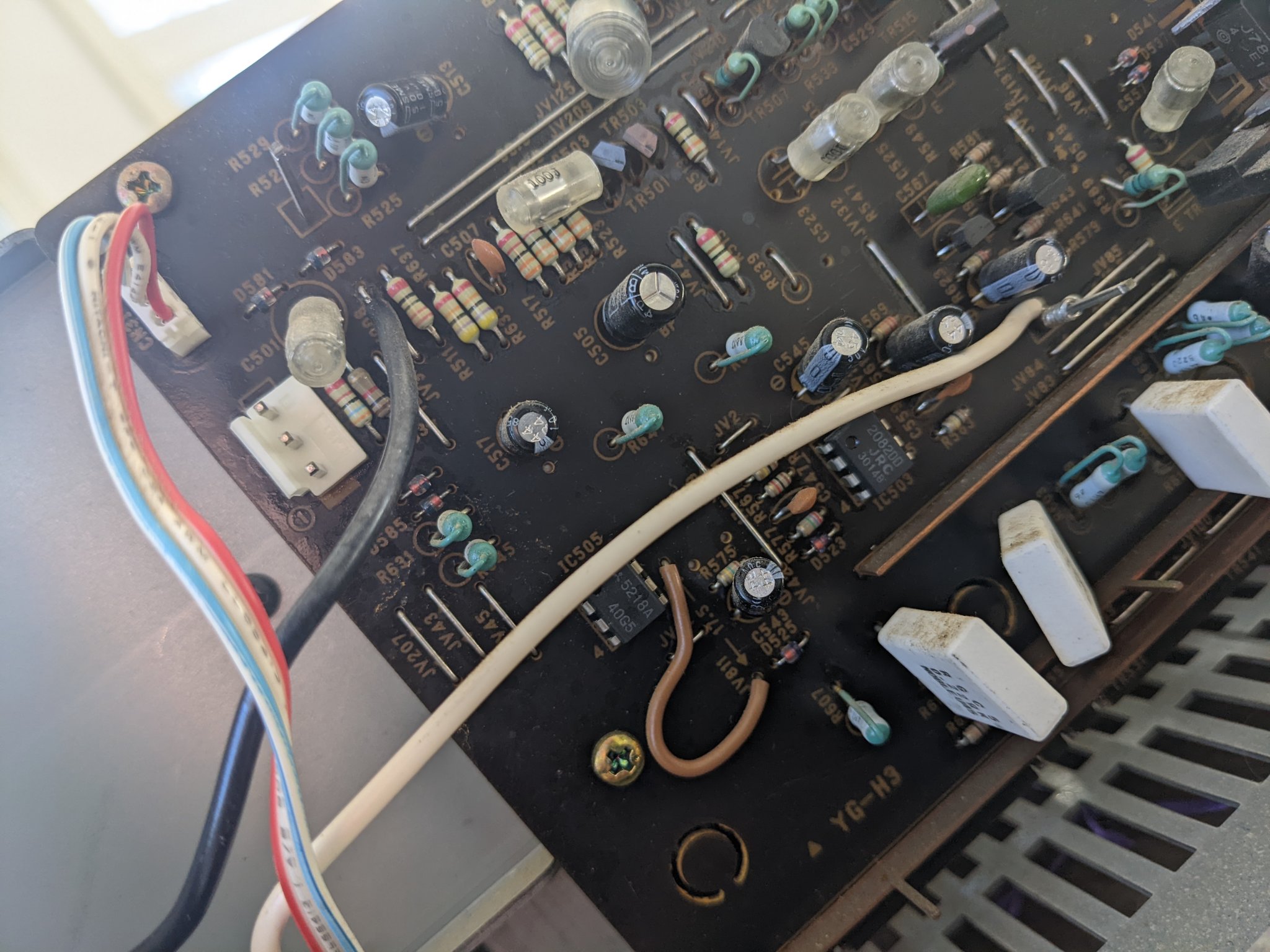

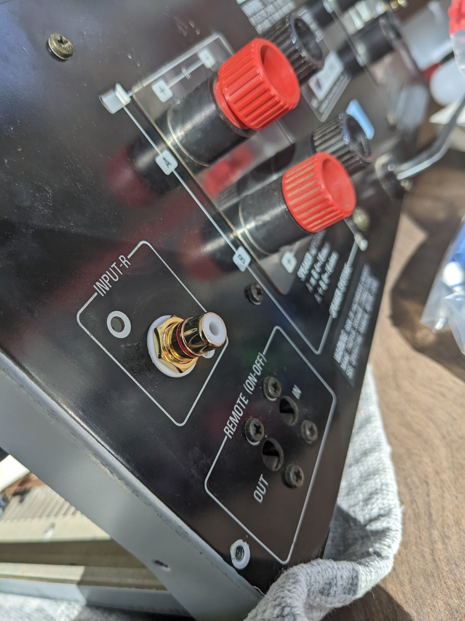

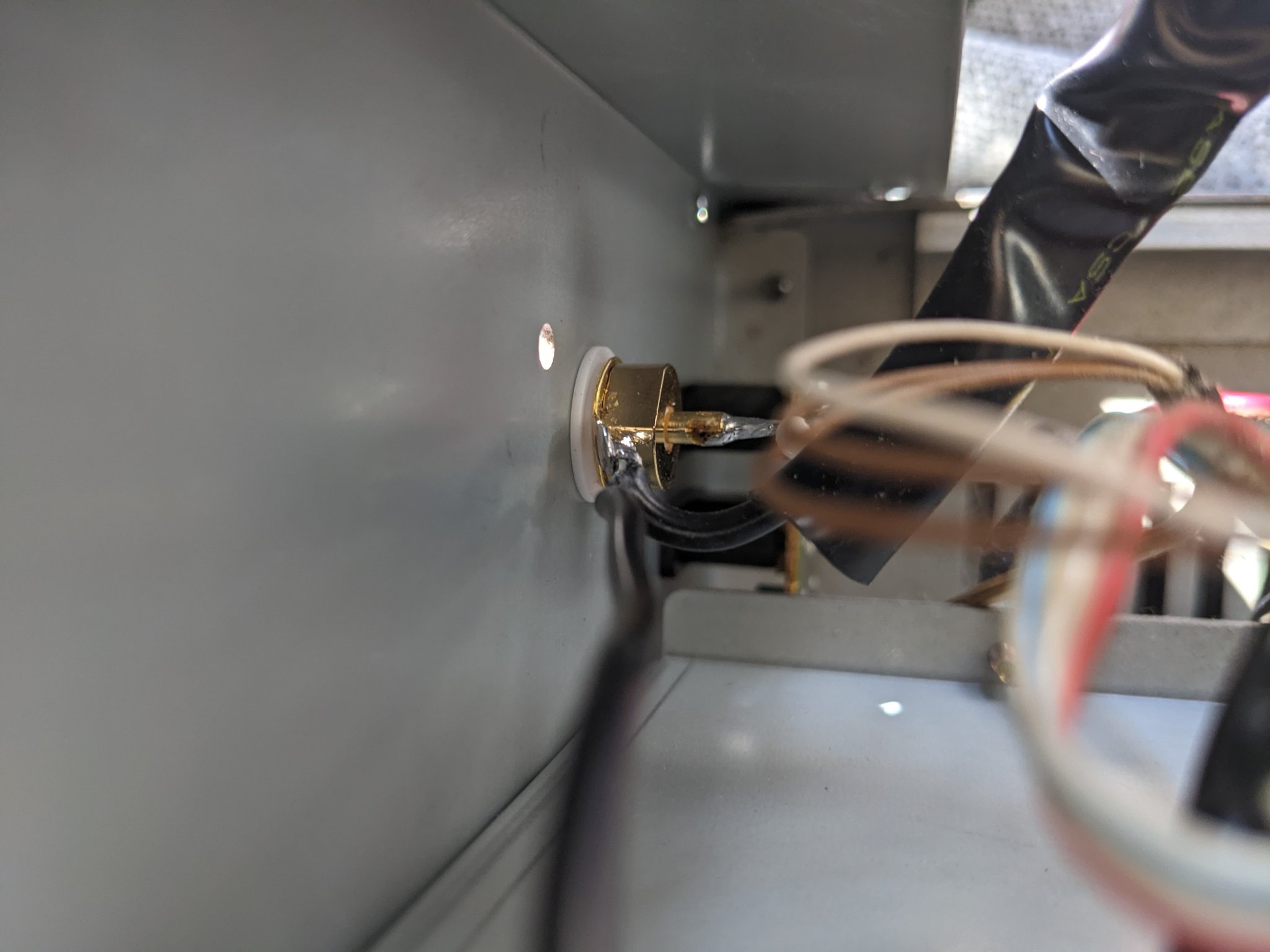

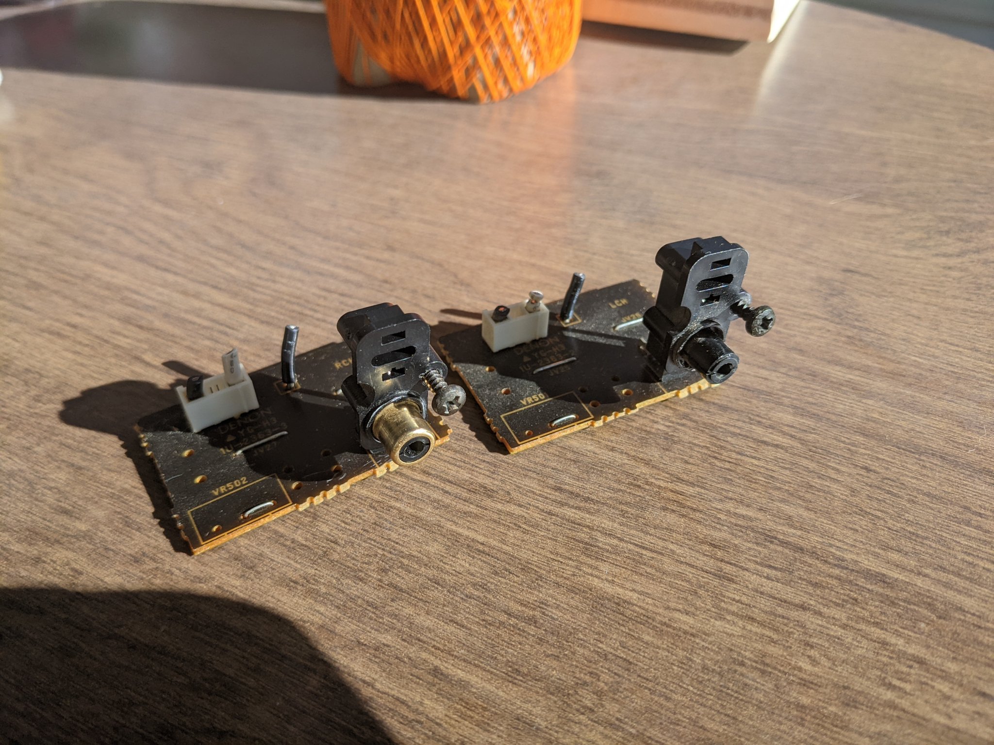

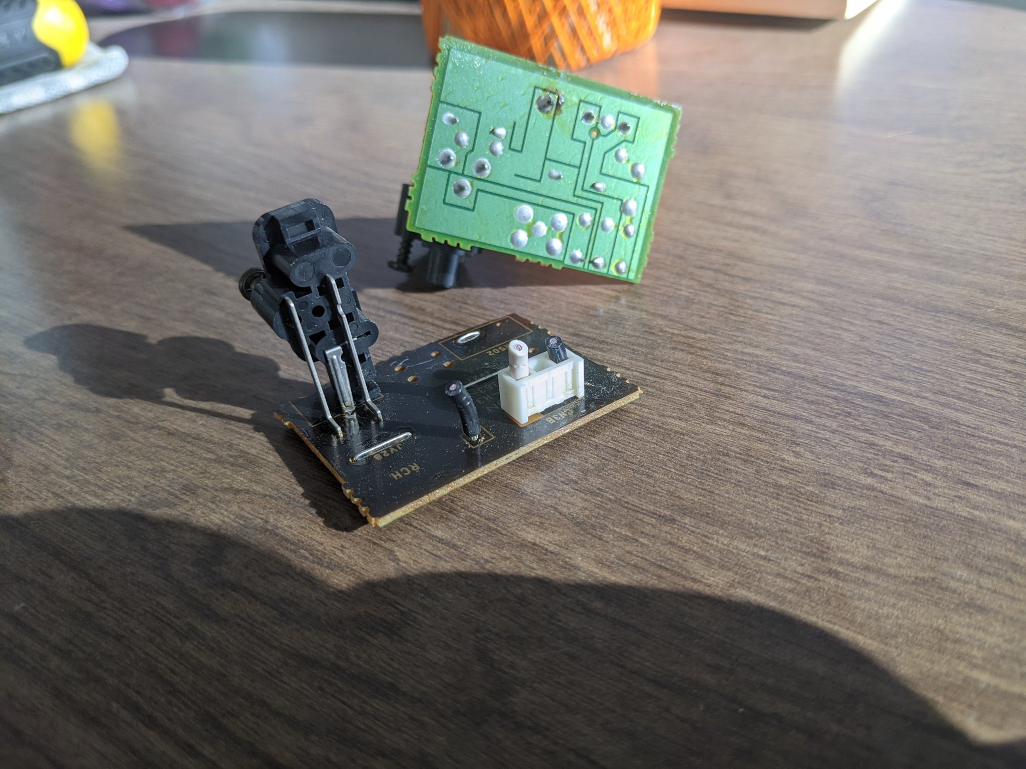

Thanks again for the help. Here is some more info about the rca Jack's. The original ones have three wires. Two of the wires go to ground (?) On the jack (the outside contact), but they go to different locations on the amp. One attaches to a bare wire called JV73. The other ground goes to CN3B. My generic replacement jack has just the ground and pin/center. I connected both black wires from the amp to the ground on my replacement jack.
Some notes:
- pictures show missing outside contact on one side. That's why I replaced it.
- While trouble shooting, the wire has pulled off from JV73.
-All my measurements have been with JV73 not connected on one side and CN3B disconnected on both sides.
-I will reattach that JV73 wire and plug the CN3B connectors back in and see if anything changes.

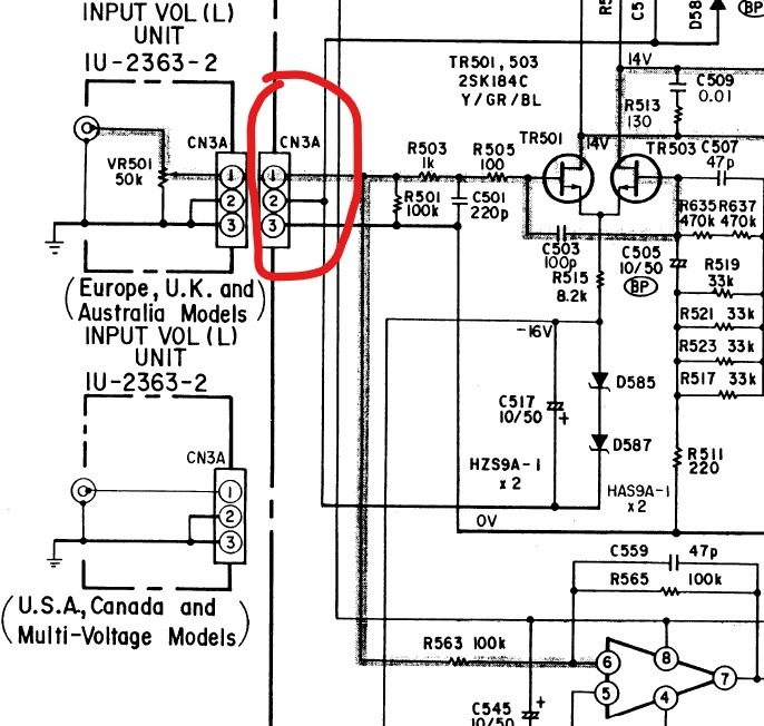

It is really difficult working off pictures 🙂 Look at point CN3A on the main amplifier part of the circuit.
1/ With the new sockets all connected up do you have continuity (use a low ohms range on your meter) between pin 2 and pin 3?
2/ Points 2 and 3 should also read zero ohms (so continuity) to the main ground point in the amplifier. What the route for that might be is unclear. Look at the diagram and the earth symbol on the left. That point should electrically return to the same point as the speaker negative terminal.
So have you got continuity from points 2 and 3 of CN3A to the speaker negative terminal?
Amp OFF of course for all these checks.
I get 36kohm across pin 1&3.
There is no wire in the plug at Pin 2, but I get infinite ohms between 2 and 3. I get zero between JV73 and point 3. (I have the US/Canada model). Same on both channels.

The standout thing there is the left channel reading 0.3 ohms from point 3 and the wire to ground. That all sounds correct. So the right channel is missing the ground continuity and I can't really advise why that is so without having it in front of me.
In the first instance you will have to just compare channels visually and see where the left channel gets that ground connection from. It could be via that wire.
