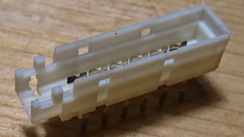

After struggling to isolate a phono issue for a while, it turns out the MC/MM selector switch on the back of the amp is semi-knackered.
As I do not have a service manual for the amplifier, and google is coming up blank, could someone steer me towards a replacement for this switch ?
I don't want to do any mechanical mods to the chassis. The last resort is trying to disassemble and clean the switch.
Thanks, Pete

Disassembling and cleaning the switch would be my approach. Takes a bit of care. Then you can measure it and figure out if there's a replacement that would fit the panel...
It's the white thingamajig in the top right hand corner ? Well, at least it looks accessible.Replacement can be tricky - not much to see from under the plastic hood:

Actually you are correct, the "black unidentified object" seems to be not related to the switch but blocking the view.It's the white thingamajig in the top right hand corner ?
These white ones can usually be opened up:
or be bought from Farnell, eBay etc:
https://ee.farnell.com/alps-alpine/spun191400/switch-dpdt-0-1a-30vdc-latching/dp/1123855?ost=1123855
https://www.ebay.de/itm/232280188878
