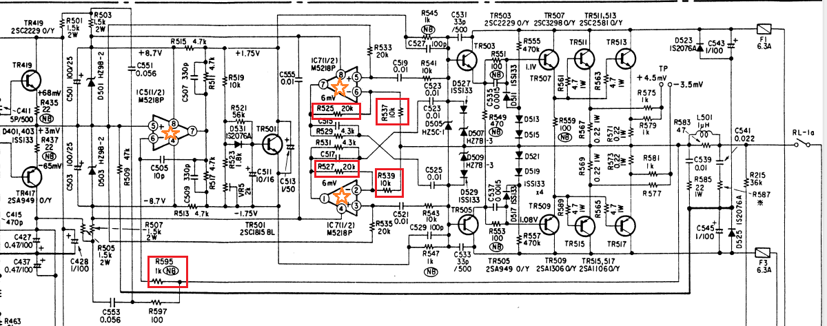

I shall try to ask again - this time focusing only on the bias and feedback circuit of the amp. Attatched is a picture of one channel with the ICs and resistors I'd like to change (at least from current carbon to metal-film types). Marked red are the negative feedback resistors and marked with orange stars are the opas. If my (very limited) understanding serves my right, IC5 is for the bias and doesn't have that much influence on the sound and noise compared to IC7.
Is there any benefit in further changing, say R533/R535, R541/R543 to metal film type in terms of noise and/or sonics?
Is there anything else I could optimize here to make an LM4562/LME49720 "more comfortable" or, in the best case, lower the gain?

It is clear that you have no understanding of the circuit at all hence you should not meddle with it. Neither of the components you reference has any bearing on the gain of tha amplifier, the circuit is a form of error correction acting only on the output stage which as NO voltage gain. Operational amps are universal components, so why assume they have anything to do with amplification directly? Meddling with said components ratios or using an OPamp which might not be suited will result in an output stage nicely burnt to crispy black, with matching crates in your output transistors.
I see that you have the service manual, see if you can identify which part of the circuit actually is responsible for amplification, that would be a good start.

The specs do not suggest an unusually noisy amplifier, but those may be referring to operation with the tone controls turned OFF. So I suggest doing this (preferably flip the switch back and forth a few times, it may not have been used in quite a while) and reporting back on whether that helped.
This amplifier has a "processor loop" feature which could be used to include an attenuator of about -12 dB, which would then be effective for all sources. If there is only one source, I'd just put it inline at the input.
Modifying power amp gain is always a bit tricky because you usually need to adapt compensation. This one also has its tone controls in the feedback, which doesn't make things any easier.
I don't understand the theory of operation of this power amp circuit - especially those of the OP-Amps.
There is a certain similarity to Electrocompaniet's Ampliwire AW-100 go to post #3 (first PDF file) under
Electrocompaniet Ampliwire 100 (AW 100 AW100) different Versions
But what are the aim of the operational amplifiers IC511 and both halves of IC711 in detail (go to the attachment in post #2) ?
Are this an invention from DENON or is there a well-known naming for this topology (maybe a kind of error correction) ?
