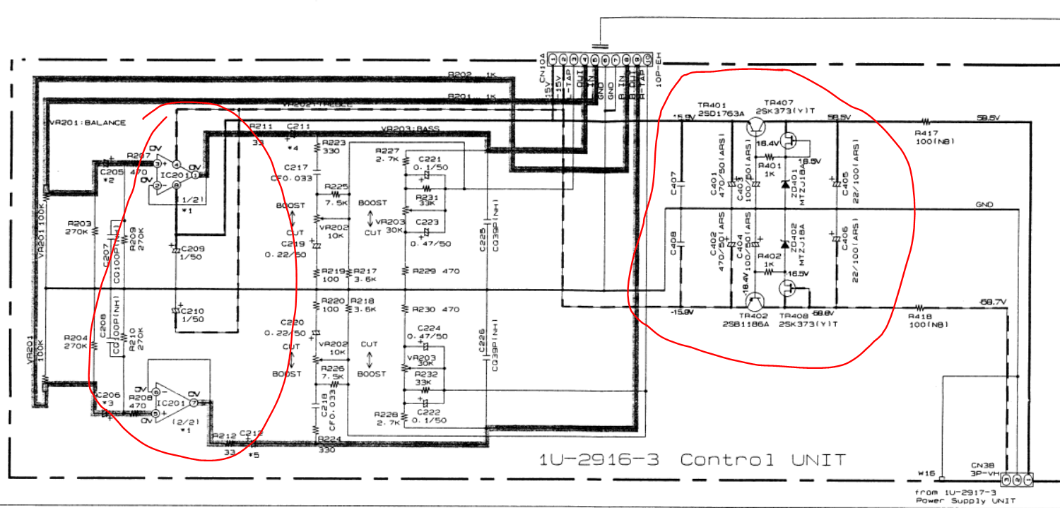

That is a switch, or better, a diverter (?).When I press Source Direct,
multiple switches/ diverter ( there's an acronym for that...) And activated by the single button/lever, for stereo you need at least two, so it's 6 contacts, the bridge ( or printed on PCB board in rotary knobs) is metal on plastic slides....all this to say that probably the problem is oxidation!
It seems that source selection is done via relays; however, source direct is done via a switch, as @picowallspeaker mentioned. The switch should be removed, pulled apart, and cleaned until the contacts and little gliders are shiny again. Maybe it's best to give it to someone who specialises in these things... especially if you haven't done something similar before.
The tone control uses one OPAmp and it sits on + and -16V DC rails, stabilised by a nice little voltage regulator section. Those (OPAmp and voltage regulator transistors & Zeners) can also be easily checked... but I believe the issue is with the source direct switch.
I have attached the service manual... good luck.
Thanks for the doc and the description. At this point in time I am gathering information to decide if it is worth handing the amp in
To a repair shop. Based on this description it seems like a minor fix for a pro. I have a good repair guy that I handed my beloved Pioneer plasma to. I will contact him and see if he is up to handling this type of repair work.
Strange though that a switch like this could have these impacts on sound but I do have noticed that when pressing the switch the sound varies as well. Ie while I press the button, like a glitch.

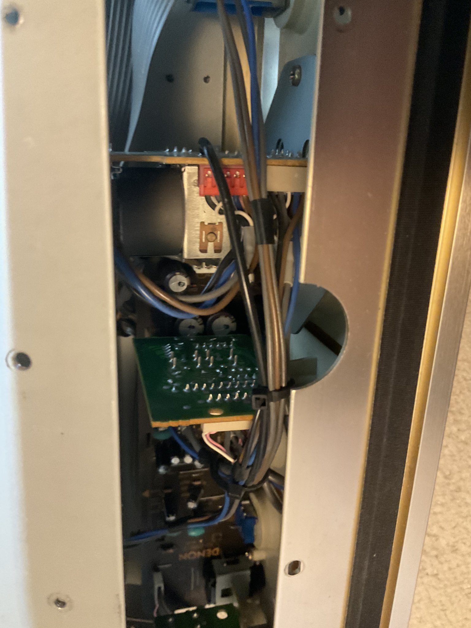

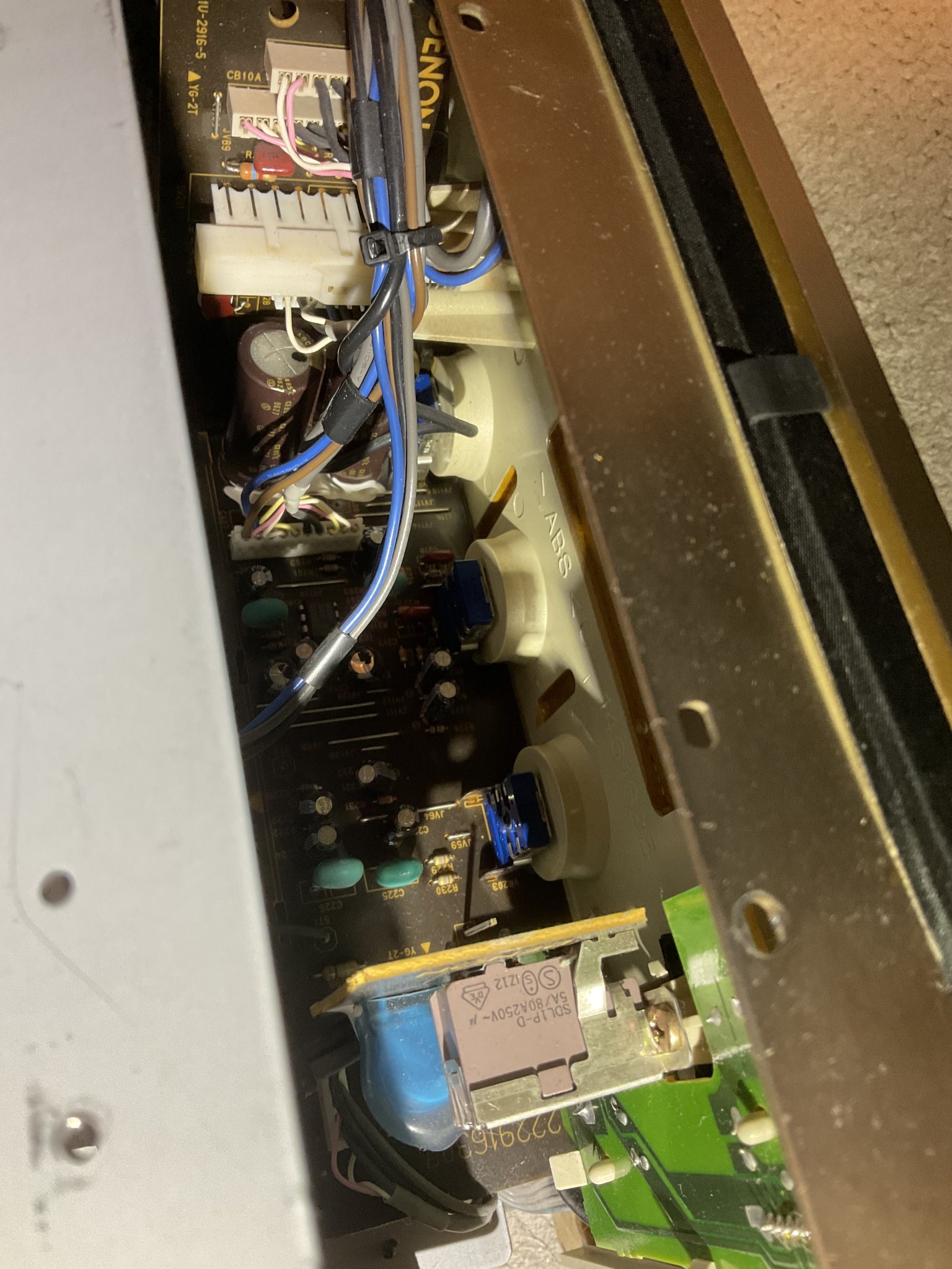

You could post a photo of the switch.and check the source direct button
Hi, I have been busy with work and also using my Onkyo instead. I connected the Denon today and it followed the same error as above but now with a difference.
After several ours the sound of the left channel was completely gone, this regardless if Source direct is pressed or not.
This seems to point to soldering?
I will contact the repair guy but wanted your input before I call him, should you have any ideas.
