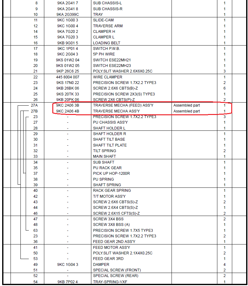

That part is called "Traverse Mecha Assembly" (or short "Traverse Unit").
The laser itself is caller "Pick Up" and it is HOP-1200R (Hitachi).

I would really appreciate if anyone can send me a copy of the service manual for the Denon DVD-2910.
My 2910 doesn't want to load any disc anymore, it always says 00h00m00 when I put in a CD or DVD.
What part should I replace? The laser, the motor or the whole optical drive?

I do have experience in DIY, so I think I can do it myself. Is the part number the only thing I need to know? And is there a way to find out which part needs to be replaced. I'm quite sure it's the drive mechanism or the laser, but on eBay I can only find lasers. I'm not sure if replacing only the laser will fix my player.
