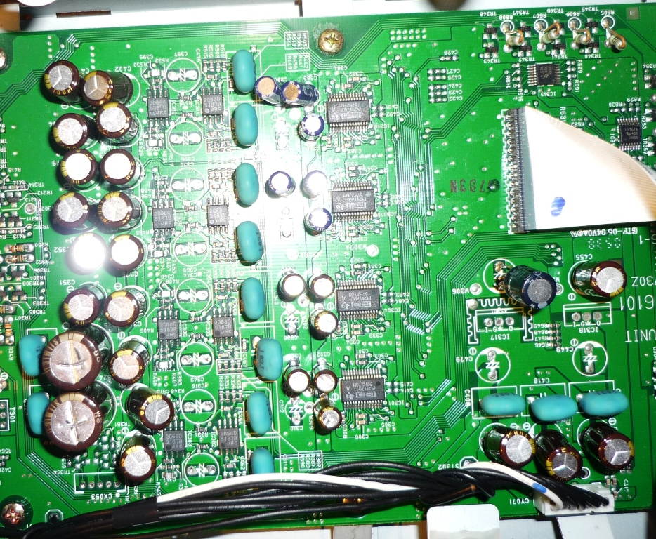

OK. I fryed a couple of LT6201...
Didn't realized that Denon put under the OpAmps ground with a dot exposed (to connect to an eventual heat sink?). Anyway, the LT6201 in DD package have the underside heatsink connected internally to V-... Oh, well, those two where all that I had.
So I put there (both of the L/R outputs) some AD8599 that I wanted to test for a while.
Not bad, not bad at all... I don't know which I like better now: LM4562 or AD8599. Hard to tell in such a short time.

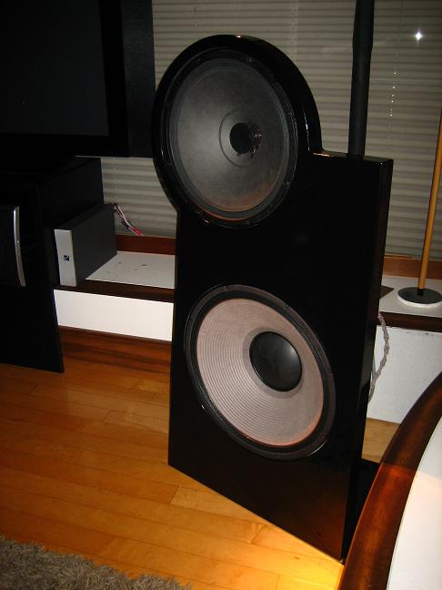

I share this with speaker building, flying from end to end of the audio chain, I have just finished an EP2500 Behringer Amp, changed OPs (4580) for the LME49723, changed Fan for a Papst one and reversed it, put bypassing polypropylene caps in Power plant (also carry audio signal) and in imput caps.
I've been the last two hours smashing my head with: Phutureprimitive, Emerson Lake & Palmer and Engelbert Humperding to be eclectic!!!
Some of my stuff, below

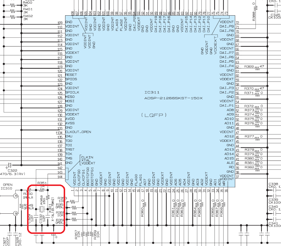

As for the clock - I don't think that clock is clocking the DAC's. The DSP has it's own clock (18.75MHz) and that will generate from it the signal for the DAC's inputs. The buffer memory inside of the DSP will take care of the incomming jitter at the DSP inputs.

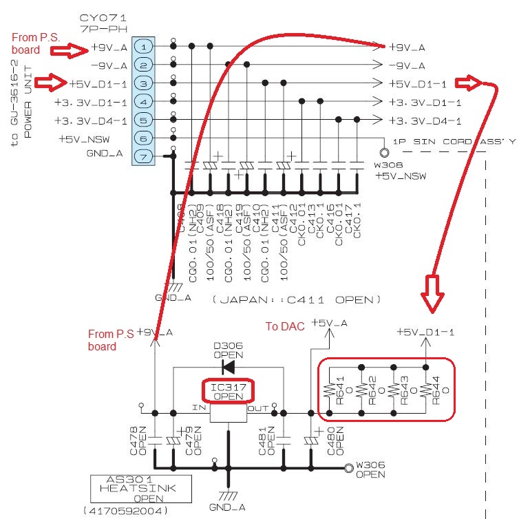

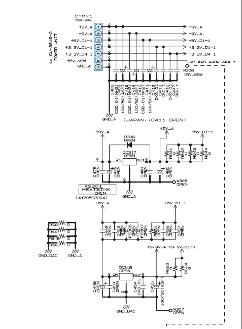

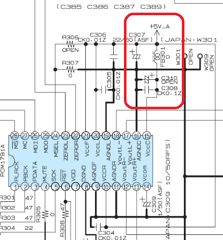

In the third pic that I did post, you can see the four zero ohm resitors R641-644, between the +5V_D1 (incoming from the regulator on the power supply board) and the +5V_A (going to feed the DAC). If you just install the IC317 in the OPEN position, you just "paralleled" the reg in the PS with the new one. Basically, the one that has a higher output voltage will work, the other will be blocked.
In the forth pic I am showing the place where the +5V_A enters the DAC - as you can see there is a separation with a ferite coil between the analog and digital supply.
The original +5V_A is as clean as the one you install - it is an analog reg also. I decided just to add an ELNA 50uF/50V capacitor in C480 placeholder.
The one that you installed draws the power from the regulated +9V line that feeds the OpAmps - I really don't like that apporach and maybe Denon engineers changed their minds too about it after they manufactured the Japanese board (I have the US version and is missing it too as you can see in the fist pic).
As for the clock, I would rather invest the money in the 18.75MHz clock of the DSP. Yes, the main PLL clock affects the SACD signals, but the DSD is less sensitive to jitter compared with PCM signal - it misses the precise sample and hold requirement to be decoded in the delta sigma DAC, data is already in delta-sigma format.

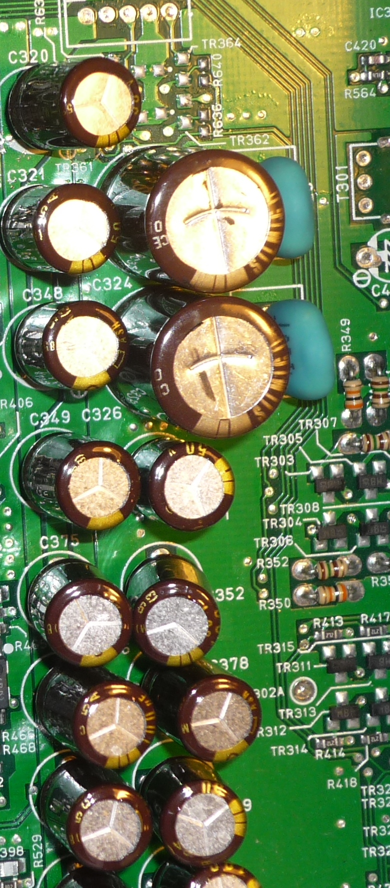

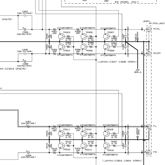

As you can see on the board pic above and schematics, the caps for the stereo mix output are better than the ones in the multichannel output. Better (and bigger) electrolytic (RSV instead of ASF), paralel with a Polypropylene Film Capacitor (NH2).
Mr. Sonic, your explanation is not very clear🙂 I will split it in parts to see if i understood it.
The four restistors are connecting analog and digital ground, not the supply
Without extra reg, there is only one 5V for digital and analog coming from the ps-board. So i don't undestand your comment on the separation of dig. and analog
With the extra reg you claim that if the "powesupply-5V-reg" gives a higher voltage in comparision with the extra 5v reg, then the ps-reg is stil used ; You have a point here. So i have to disconnect the 5v from the PS.
The extra reg is better than the standard 7805 from the ps-board, The best ones wallet can afford is in order here.
If you also place the extra vacant 3,3V regulator, you can supply the whole audio board from a separate trafo. As Denon does with the 3930.
You're right, SilmicII bypassed, but best cap is no cap at all in series with our preciated signal... Am I obssessive?

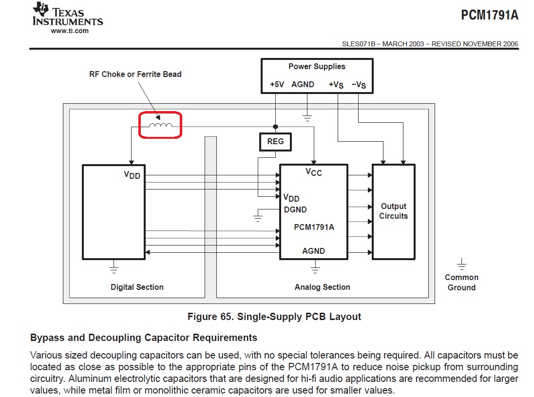

I am posting again the schematic where you added the regulator without removing the resitors.
Installing the IC317 without removeing the resitors R641-R644 puts in paralel two regulators - the existing one on the Power Supply board with the one that you just added. The one with slighty higher voltage will block the other and you will have only one working, feeding the same circuits.
Also on the DAC side, you have the digital and analogic +5V connected via an inductance and capacitors to ground - that "isolates" the digital noise of the +5V digital input pin from the +5V analog input pin. But there is no way to separate those on different sources, unless you do some major rework in the area. The solution with inductance is listad in the TI's application schematics for the DAC PCM1791A, so that is all right as it is.
Yes, you could do a dedicated PS as you say. In DVD-2930 there is an additional reg board for the DAC side.
In the japanese version they don't have those resistors on. And instead of the ferite bead (like FB301) they have just a wire.
